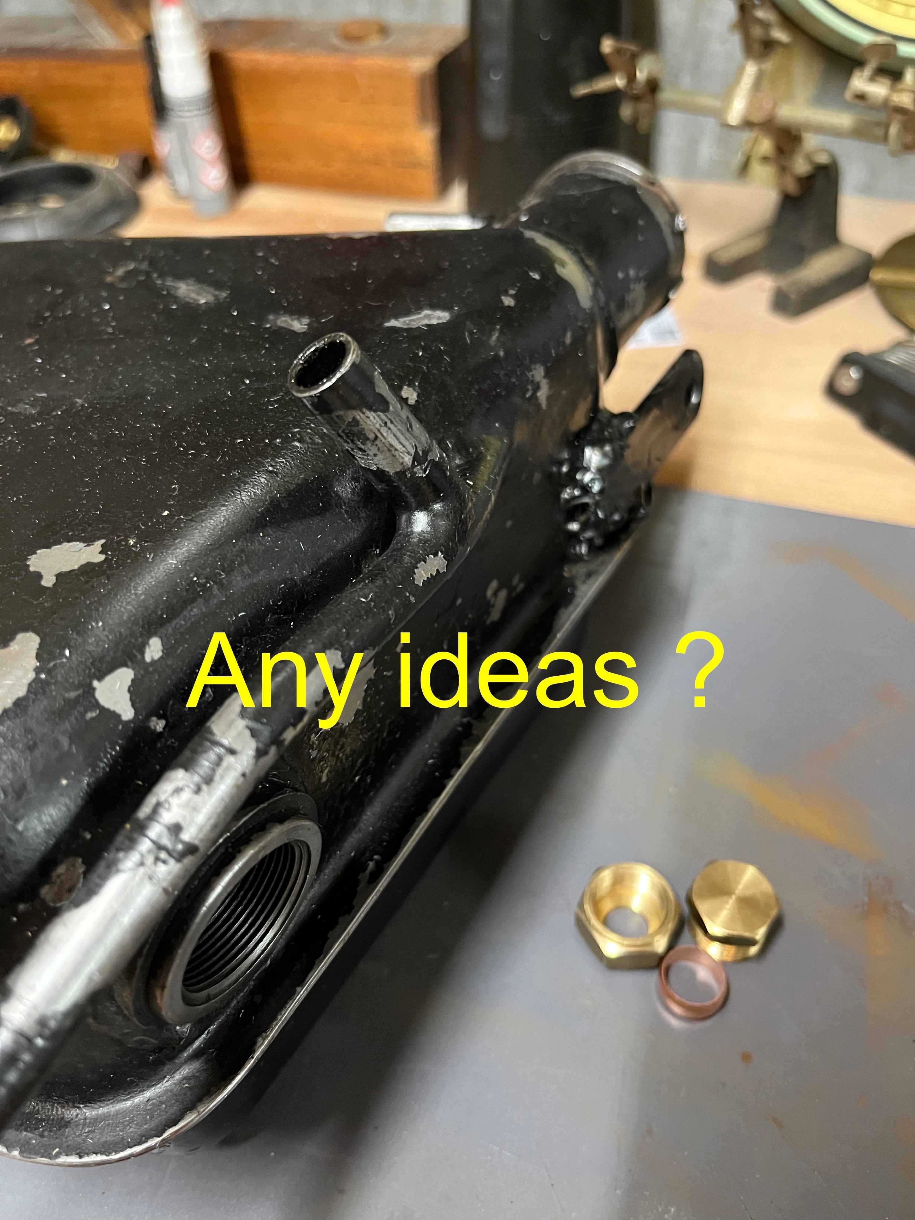

Anyone permanently capped the oiler on a Commando Mk2a ? Recently bought a mint Mk2a with a poorly plugged oiler which left the battery area etc coated in oily mist. I don't fancy reinstating the oiler and want to cap it permanently and before I install an 11mm compression end cap has anyone had success with another method?

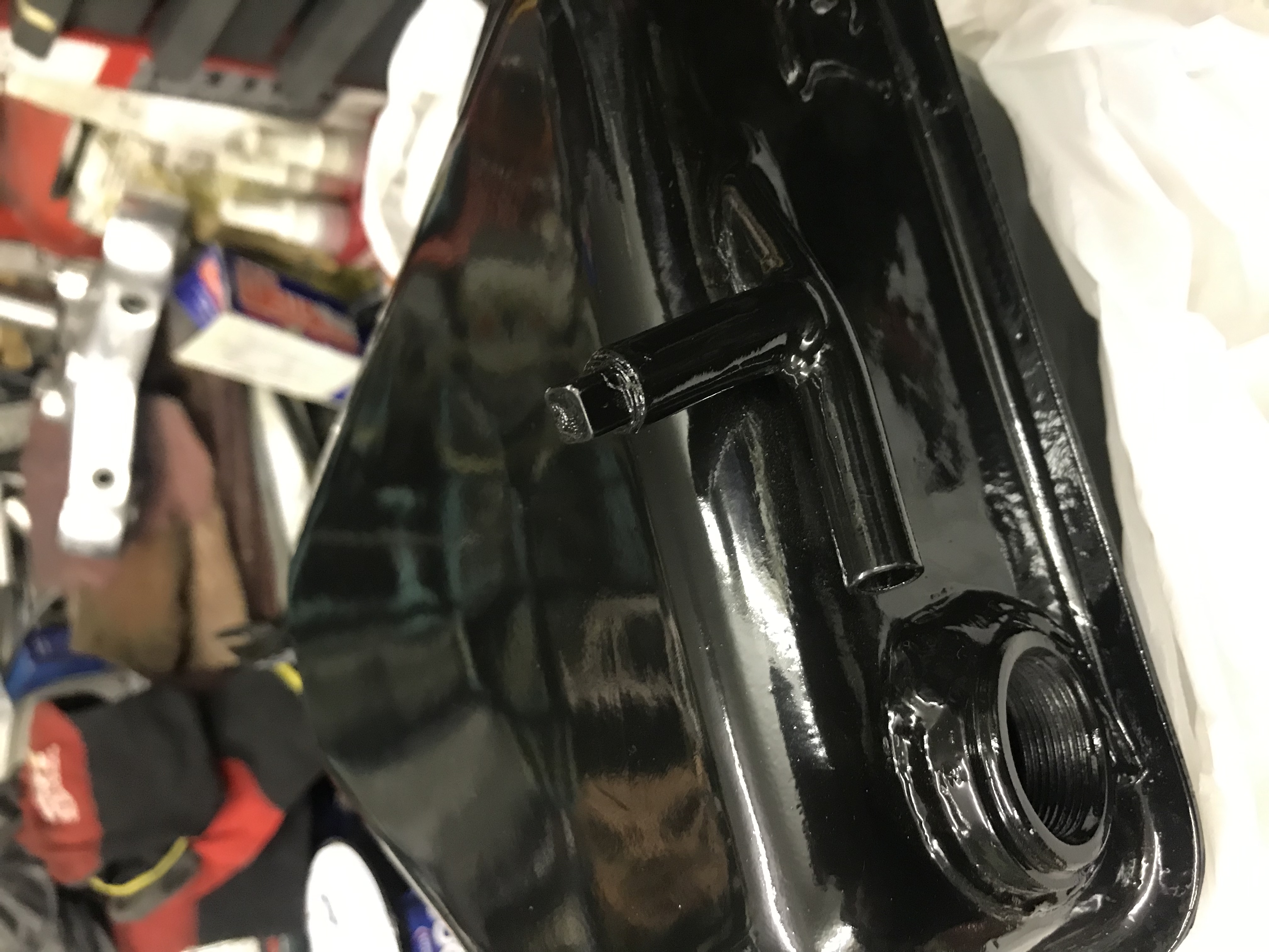

I have a Mk2 and capped the chain oiler by a similar way to that shown in your second picture. I used a well fitting bolt with the threaded part cut off. I wonder if yours uses a set-screw and the oil is passing along the thread?
Thanks Richard, I thought of maybe threading the pipe but was worried any bur may hide in the tank and get into the motor.The old cap in the photo, was simply a Flexi pipe cut short and a piece of rod inside fastened with a jubilee clip. I just want to permanently cap it with the least risk as the oiler pipe is difficult to reach once installed.So I take your method is leak free ?

Many thanks Martin did you thread the inside or outside of the pipe ? I have been thinking more about this method but not sure as the wall thickness isn't that great to take a decent thread !

Yes it is leak free, it was a well fitting bolt but I think that I smeared Blue Hylomar on it. May have used pipe clips rather than jubilee clips.
Hi Paul, I have tapped the pipe out 1/8 th BSP and fitted a plug using pipe sealant.
