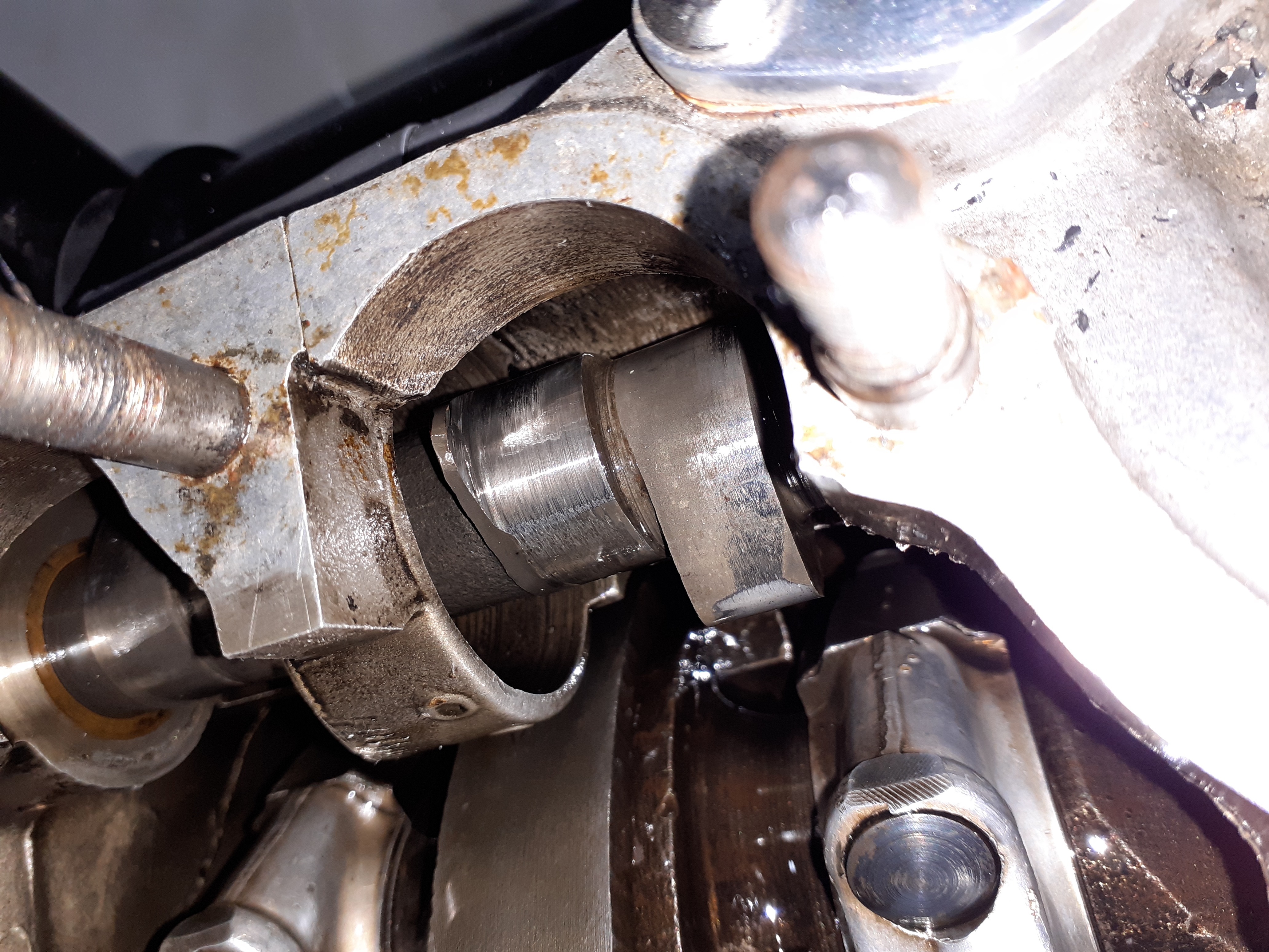

After suffering with high oil consumption all summer and all but loosing compression on the left pot I took off the head and barrels on my 1970 Roadster to find the cause, expecting any or all of the standard disasters. So far I have found replacement bronze valve guides on the inlet with petrified rubber seals but on guides that don't have a lip to secure the seal. That seems odd. Then I found it had bronze guides for the exhaust valves as well. This I've understood is a complete no no and that only iron should be used. The rings and bore looked fine but a measurement might prove otherwise. The right side barrel stud was brocken and the copper gasket in a very poor state. So all in all I found all of the standard disasters.
What I didn't expect to see though was that one lobe on the right cylinder side of the cam was completely worn away. The others looked really quite healthy and the cam follower for the worn lobe didn't look all that bad either. The strange thing is the bike wasn't running that bad at all and I haven't had to keep adjusting the tappets so it could well have been like that for years. Does anyone know what could cause just one lobe to wear like that? (See pic)

Once you're thru the hardening the cam will disappear pretty quickly. Suprising it ran at all really. All sorts of reasons for failure from poorly manufactured camshaft to head oil feed failure to poor assembly.

The tappet clearance is measured on the base circle so disappearing lobes aren't noticeable. The clue is usually on a magnetic drain plug if one is fitted.
It usually seems to be the drive side exhaust lobe which has the most marginal lubrication, but once a lobe has scuffed, it can indeed disappear quite quickly. It is indeed remarkable how well they can run with presumably one cylinder doing most of the work.

In the 1970s the factory fitted a soft cam, I questioned this at the time with the factory, they said the cams were the same material as they had always been, what they didn't say their new hardening process actually made them softer!! So 1970s saw a whole fiasco of soft cams from the factory (I know the 'hard' way). AS Richard says above-you adjust the tappet gap on the BACK of the cam. So the cam could completely disappear, but your tappet gap will stay the same. The other notice of a worn cam is a lack of top end performance. Loosing the timed breather is no big deal, BUT you must have some breathing-see Commando Service Notes for 750 breathing.

It is not soft cams that fail, but Norton's ever increasing desire to produce harder and harder cams and followers. The race to ever increasing hardness was their undoing, due to an odd unrelated comment I made to a hard facing company it resulted in uncovering on why cams fail.

Sometimes the engine can be noisy when the cam is/has failed. Other times it will give no sign of failure, the engine exhibiting no undue noise. The engine has obviously been apart at some stage in the past fifty odd years (at least the top end has) If the cam has been replaced in the past it is possible that the cam run in procedure was neglected and/or the followers weren't refaced at the same time. 1970 bike, does it have the spin on filter?
