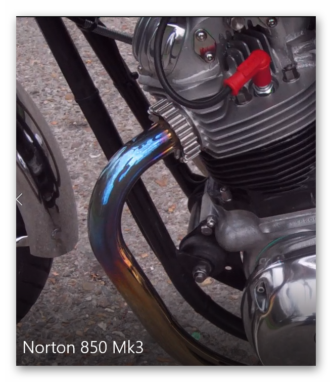

Hi This is and age old Question but how do you stop the Header pipes from turning Blue, on my 850 MK3 it started turning blue ever since I put a new pair of pipes on, I replaced the old header pipes not long after I got the bike after someone had Bodged them with weld but the new ones had not been on five minutes and they started to go blue, some people say that it is cheap Chrome and some say it`s timing or Carb settings, well I have set the mixtures on the carbs and the Timing I have played with and it don`t matter where I set it they turn blue, Now I can polish it out and they go back to nice chrome but start her up and within five mins they are blue again, Oh and they are single pipes so no balance pipe...... so makes me think it might be the chrome but the were from a good supplier so is there anything else I am missing as my other Bike the pipes stay shiny chrome. cheers Maurice

Chromed Exhaust pipes go blue due to various factors. The usual causes being that the metal is too thin and/or the chroming poor. A weak mixture can also add to the misery.
Original Norton pipes were so well made that you could clean them with a wire brush before giving them a good polish with Chrome cleaner. The main tubing and flanges were generally of a decent thickness which also  prevented them cracking near the exhaust port. The base metal was copper coated and then a layer of Nickel followed by layers of Chrome added to give a durableand  shiny finish. I don't believe they are made this way anymore.

When metal is heated it goes through colour changes. Clock makers of old would blue metal to give it an attractive appearance. The blueing of exhaust pipes is unavoidable due to the heating from the exhaust gases. On a good quality pipe it is normal to see the blueing around the bend in the pipe but this should not continue along the straight section of the pipe.
Hello the Causes of Bluing it one over advanced ignition timing and weak mixture   of the carburetors  one or the other or both,                                Yours   Anna J

But back to blue pipes. Retarded ignition is a principal cause, because naked flames end up pouring out past the exhaust valves. Or to put it another way unburnt fuel burns after leaving the cylinder. It also seems unavoidable with modern lean burn engines with cosmetic pipes (like modern Triumph Bonnevilles).
And the chrome layer over the nickel base is extremely thin. There seem to be arguments about where the blue really is.  Either a crystal structure change within the chrome or an oxide effect on the nickel surface. Either way it comes to the same thing. It is not just on the surface and if it is polished away then that's the chrome you've got rid of. Indeed if polishes do work that pretty much shows it is a change in the chrome crystal structure and is less visible when there is even less chrome.

this is a picture of the left pipe from last year after only about ten miles but it was a lot more than that after 30 miles and went more down the pipe too
