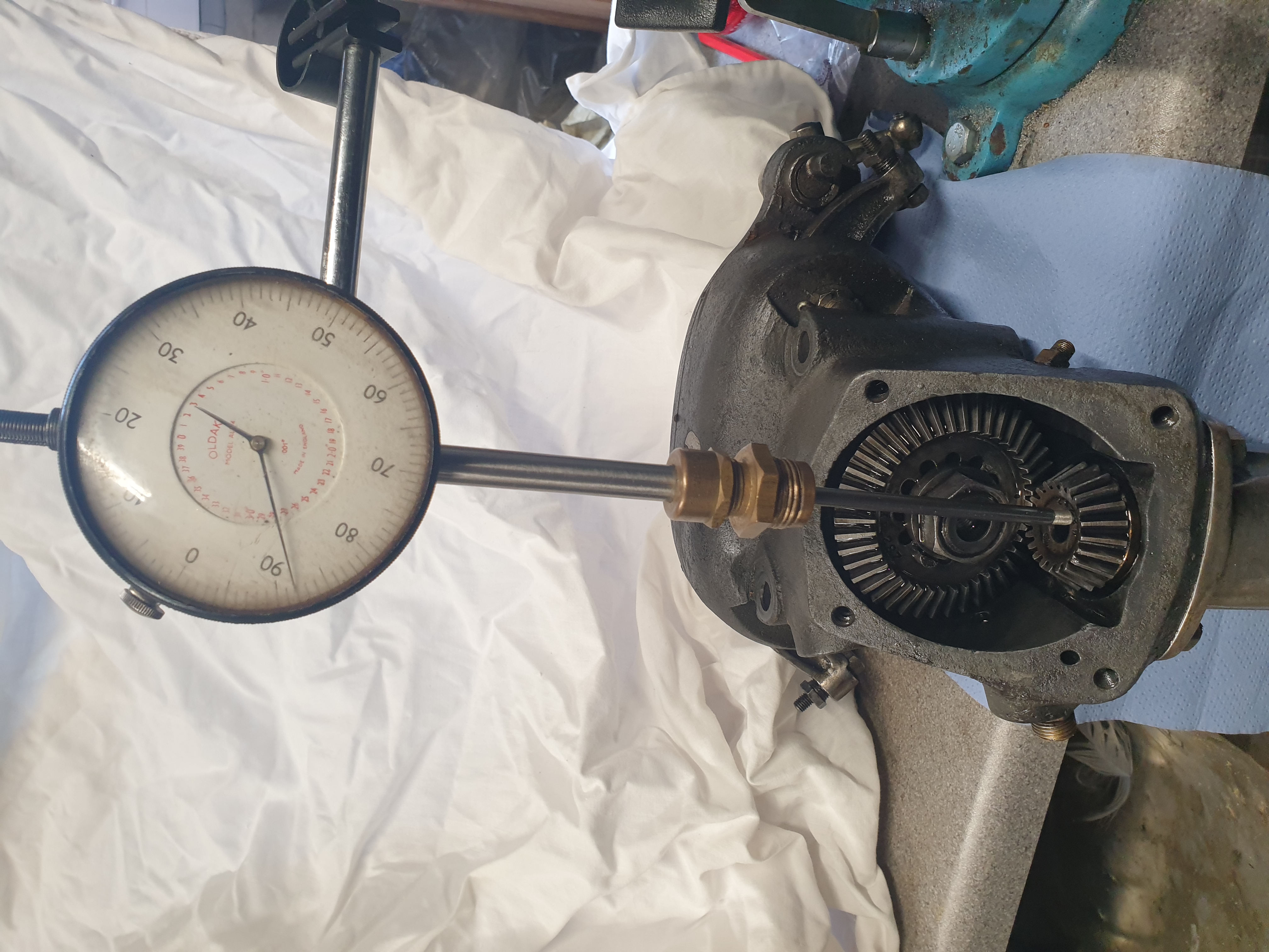

The mesh looks fine to my eyes, but all the books have to say is that backlash should be small. Which it is, all the way round. But the measurement I can make is vertical movement from when the bevel is testing on its bush, as it will be when operating, and when lifted snug. As seen in the picture it has 12 thou. This has no shim between the bearing housing and the cam box. There was an 8 thou shim in there. That gave 20 thou lift. I've not seen a measurement, but I imagine a small movement makes the closest mesh, without overloading the gears. Am I fussing too much? If I do fit it as it is, the Oldham coupling will have 30 though play, so will probably need changing....
The smallest amount of…
Thanks Robert. I'd like to…
Thanks Robert. I'd like to get this right. With 12 thou vertical clearance, the actual gap between teeth will be about 6 thou.
There seems to be very little written about these things. One says 30 thou vertical movement in the vertical shaft...another says 5 thou! Franks says nothing. Backlash in the bevels has no numbers. Now we take it for granted that we have dial gauges etc. But I don't think that was to be expected in the 1930s!

, I have spent many happy(!) hours setting up the bevel cam drives on Ducati's. The condition and security of the bearings will affect everything . I also found it usefull to test the smooth running of the gears by removing the rockers . A ducati with good gears will run well with no perceptible clearance ,but can produce an interesting almost supersonic whine , they often came from new with the whine.There is an ideal relationship between the gear teeth flanks and a little engineers blue is used on my gears to show the contact point.The gears are pretty everlasting unless mistakes are made ,Hailwoods comeback TT victory was nearly scuppered when his gears exploded at the finish.

Bearing control and lubrication are paramount, the rest is about how you want it to sound; they can whine if you go zero tol... or clatter with wide gaps for extreme temperatures. Its expected use can determine where you go with this but you will "feel" what is right under no load conditions.

Thank you Jon. I should never have started this! Leave well alone is a very good motto I'm sure. The gears are smooth and uniform, look good and feel good. I know they were assembled by a man far more expert than I shall ever be, and they have not done many miles since then. Lubrication is plentiful, and they don't make any noise that's audible above the ridiculous exhaust system.

I just spoke to one of our experts - I'm going to put it all back together as it is. According to Ian Bennet engineering - it's all fine. It was put together by Stu Rogers back in 1990 - (is he still in the field?). I'm sure he made a better job of than I shall.
