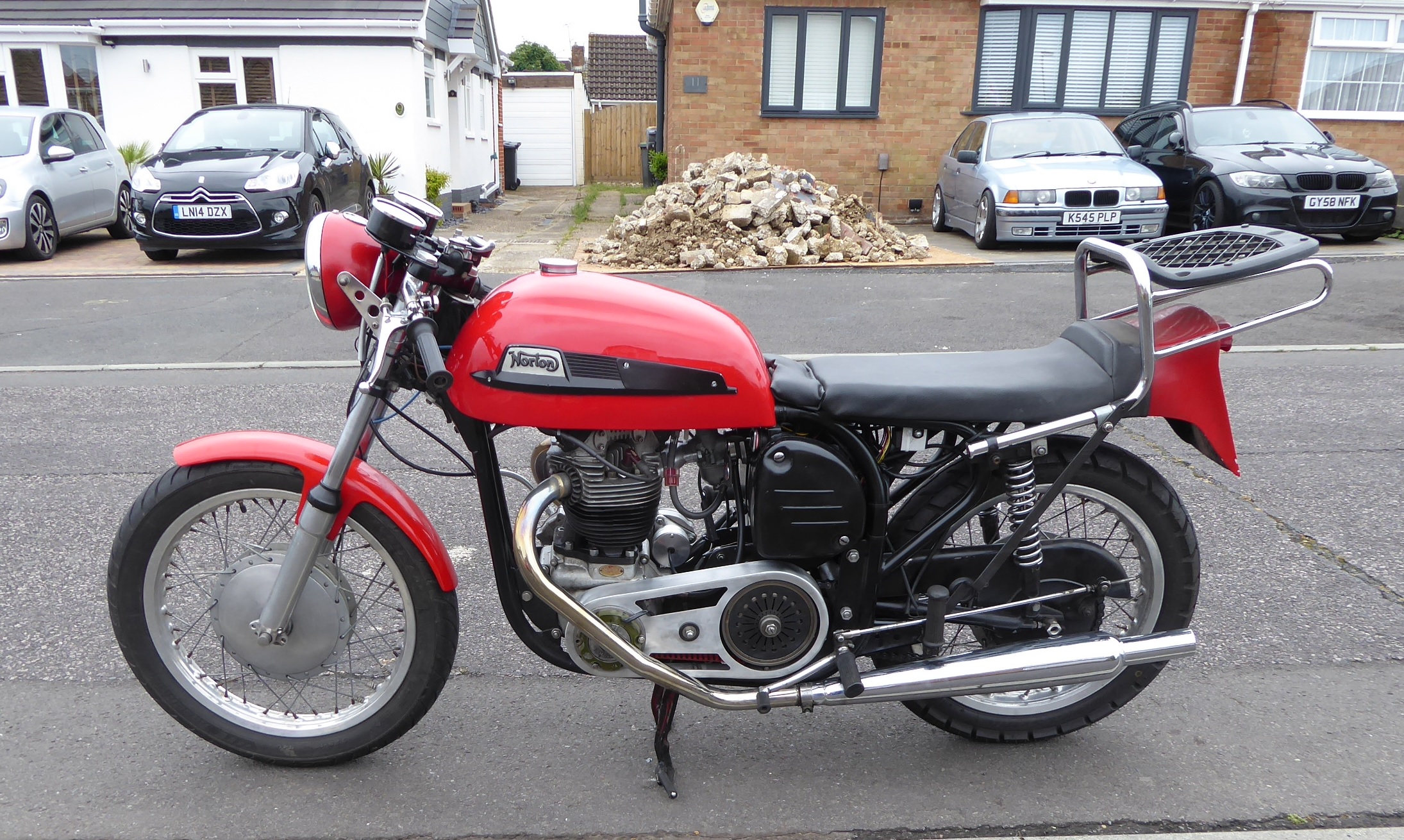

Of possible interest.........my RGM belt drive conversion has now carried me over 22,000 miles. Due to the open primary cover, it get water cooled in the rain, oil from the now worn crankshaft oil seal and dirt, dust and anything else the front tyre can throw at it.
My Norton 2025
