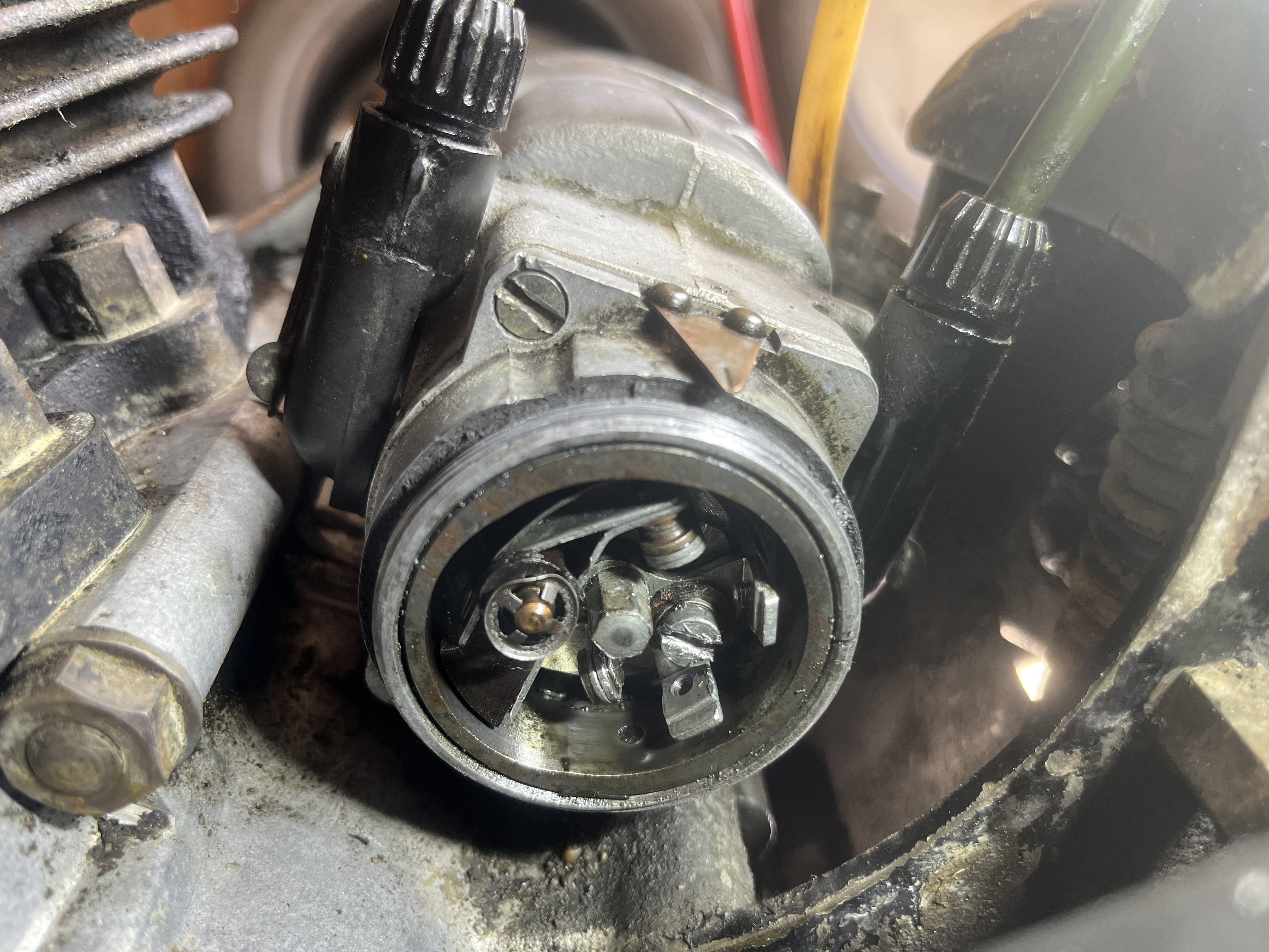

I recently bought a 1966 Atlas 750. It has the magneto situated behind the cylinders. Prior to me getting it, the bike has sat in a dry garage for some 50 years! The screw-on the genny cover plate came off no problem revealing the points mechanism which appears to be in really clean and good condition. The gap is approx 15 thou and it turns easily. The HT leads are in good condition. They screw into the Mag easily and lock down. The armature bushes have plenty of meat on them and are clean. However, there is NO spark on either of the new plugs (N4's) when I kick it over
Is there anything else I should check before I go pulling the magneto out?

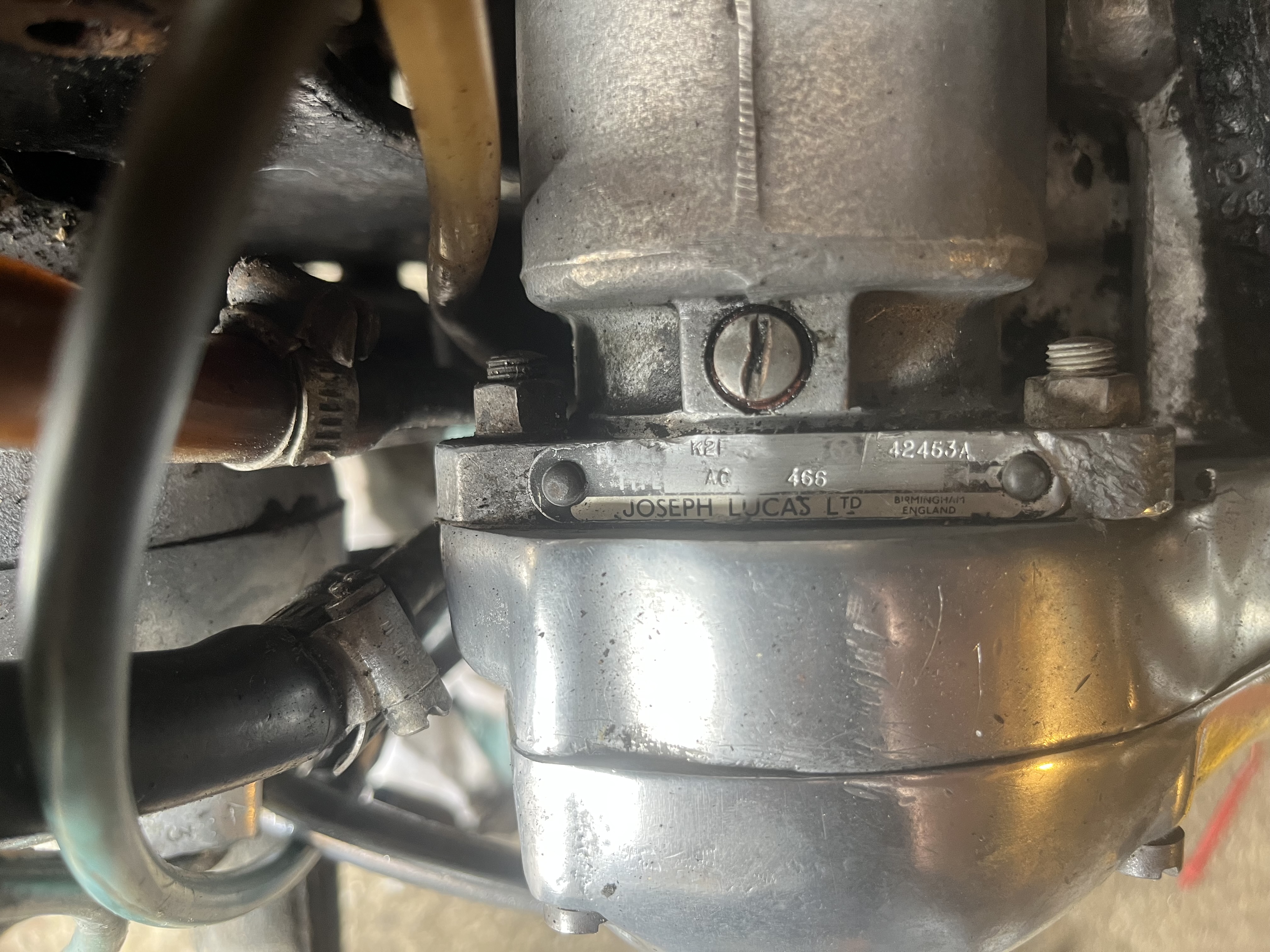

It's a K2F Model. Serial number 42453A
Type: AC      466

The condensor (capacitor) has almost certainly failed at that age.  Usually the first symptoms are unwillingness to re-start when hot.  Yours might be beyond that.  They should be able to fire a spark over about 4mm.
There are electronic options and that will be the quickest way to get it back on the road.  People who have them usually praise them.  But you will then always have to rely on charging system and battery.  I love magnetos.  My 88SS is easier to start now I've put the magneto back.  And to my eyes it looks better.
The 'Easycap' capacitor can be fitted with care by the owner without needing a rewind. It might be worth a try.  But a good service will include re-magnetising and lubricating and generally replacing worn parts.

As above , its likely that the Mag has failed.  Its equally likely that the plug caps have corroded and leads can also fail , I would check them for resistance with an ohm meter, before pulling the mag out. You could also clean the earthing brush.
For magnetos. Including At Brightspark site.   if you have a multimeter you can quickly confirm it’s electrical status and make your move from there.  Personally I would remove it, get it refurbished and continue using for the next 60 years.
