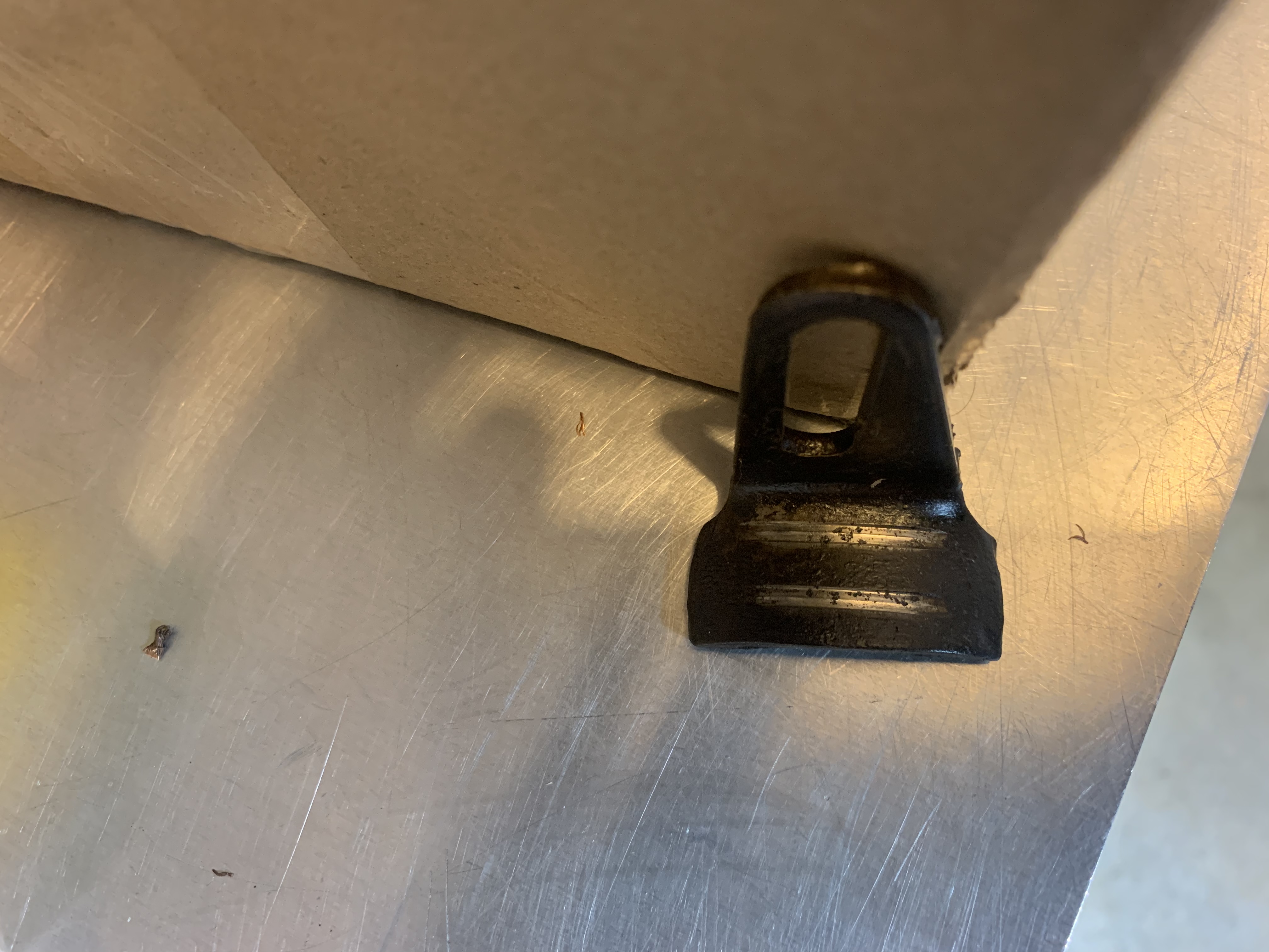

Would there be any instructions here in how to adjust the cam chain tension on a 65 Atlas? I do have the support tool.
