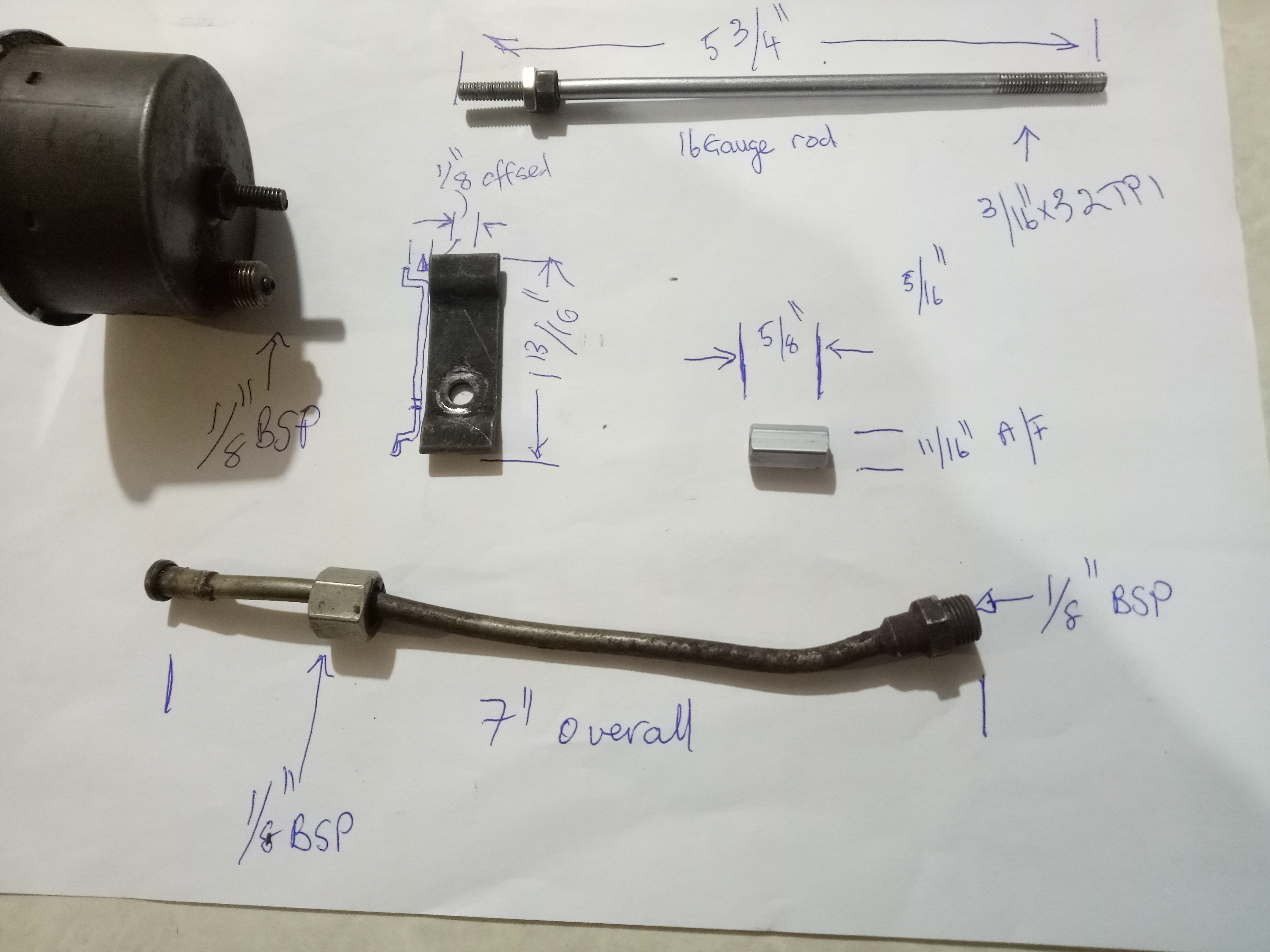

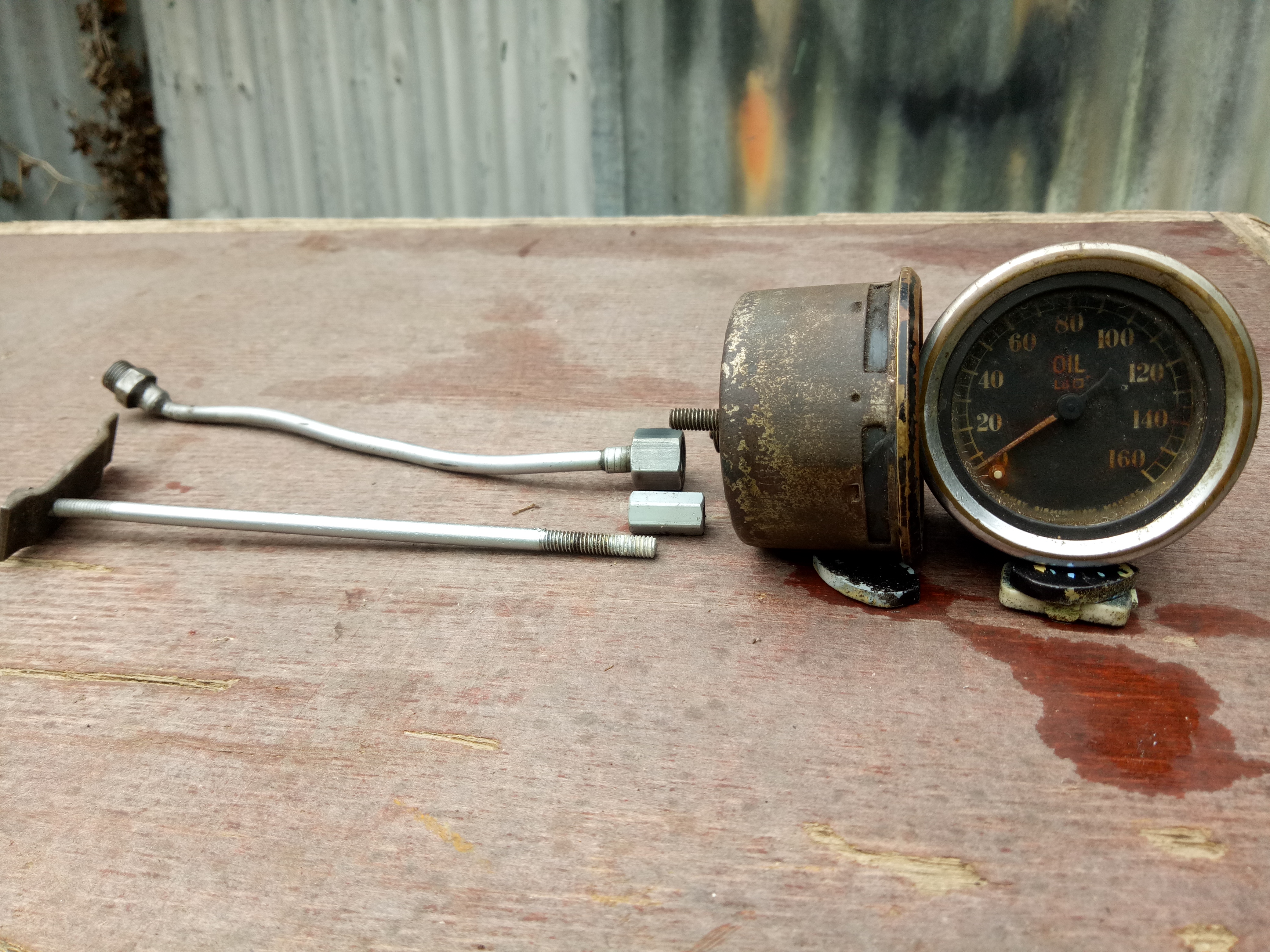

Hi Alan,
Sorry it has taken a few days to get back to you as my tank was safely stored away as it is plated and painted ready to fit. Can't be too careful.
I have removed the gauge to show the fitting arrangement.
If you want any specific measurements just let me know.
Hi Ian,
Thank you for the picture, it clearly shows the gauge & retaining fittings for me.
Now the big question, did you have to make up the fittings yourself, or where these available from some retailer?
I have to say I've not seen these fittings before, if you did not make them up, would you have any information on where to get them?
This is all new to me!
Any help would be most welcome..
Regards, Alan
Hi Alan,
Here's the measurements that will assist.
If there are any parts you want more specific detailed information on please let me know.

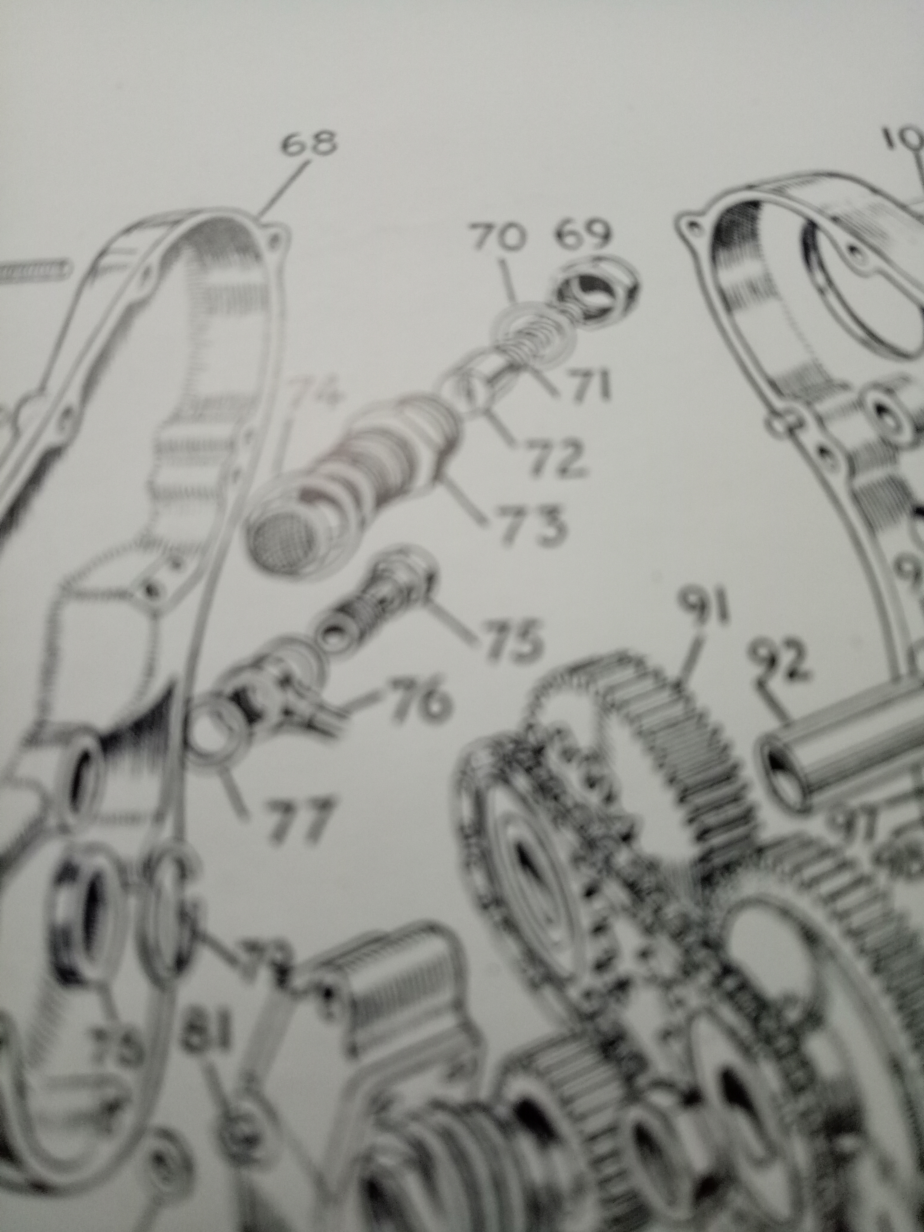

Hi Alan, I've added a couple of photos to clarify the mounting of the take off unit.
The photo taken from the 1949/50 Model 7 parts book shows the set up for the mounting.

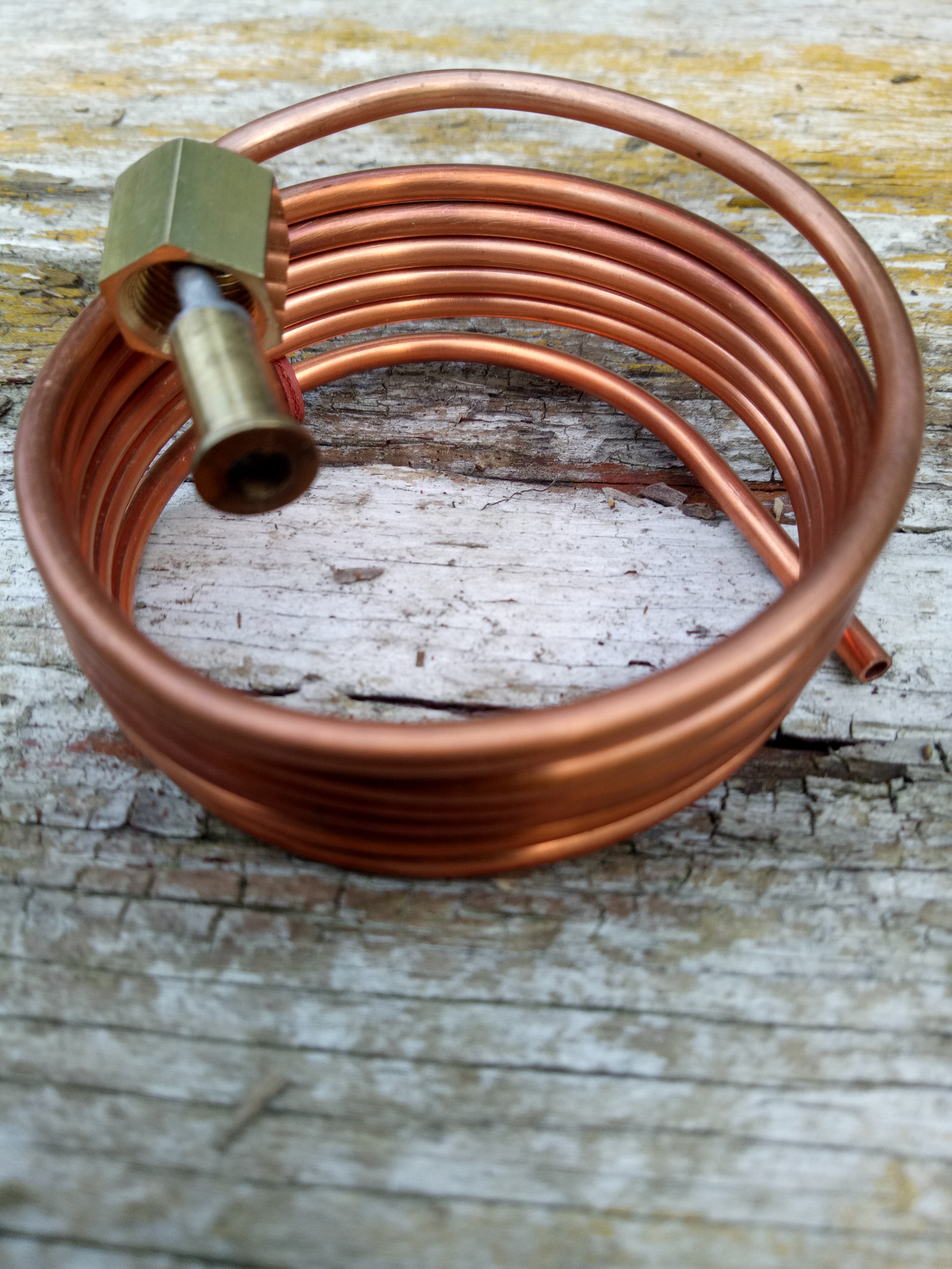

Relevant part numbers are 75, 76 & 77 and are shown just below the pressure release valve in the rear of the timing cover. The tapping is 5/16" x 22 t.p.i (BSF). The bolt used to attach the rocker feed union is the same on cast iron heads used on these early model 7's.
Several years ago you could get lengths of fine copper pipe with the 1/8" BSP union attached. I don't know if they are still available.
Any other questions just let me know.

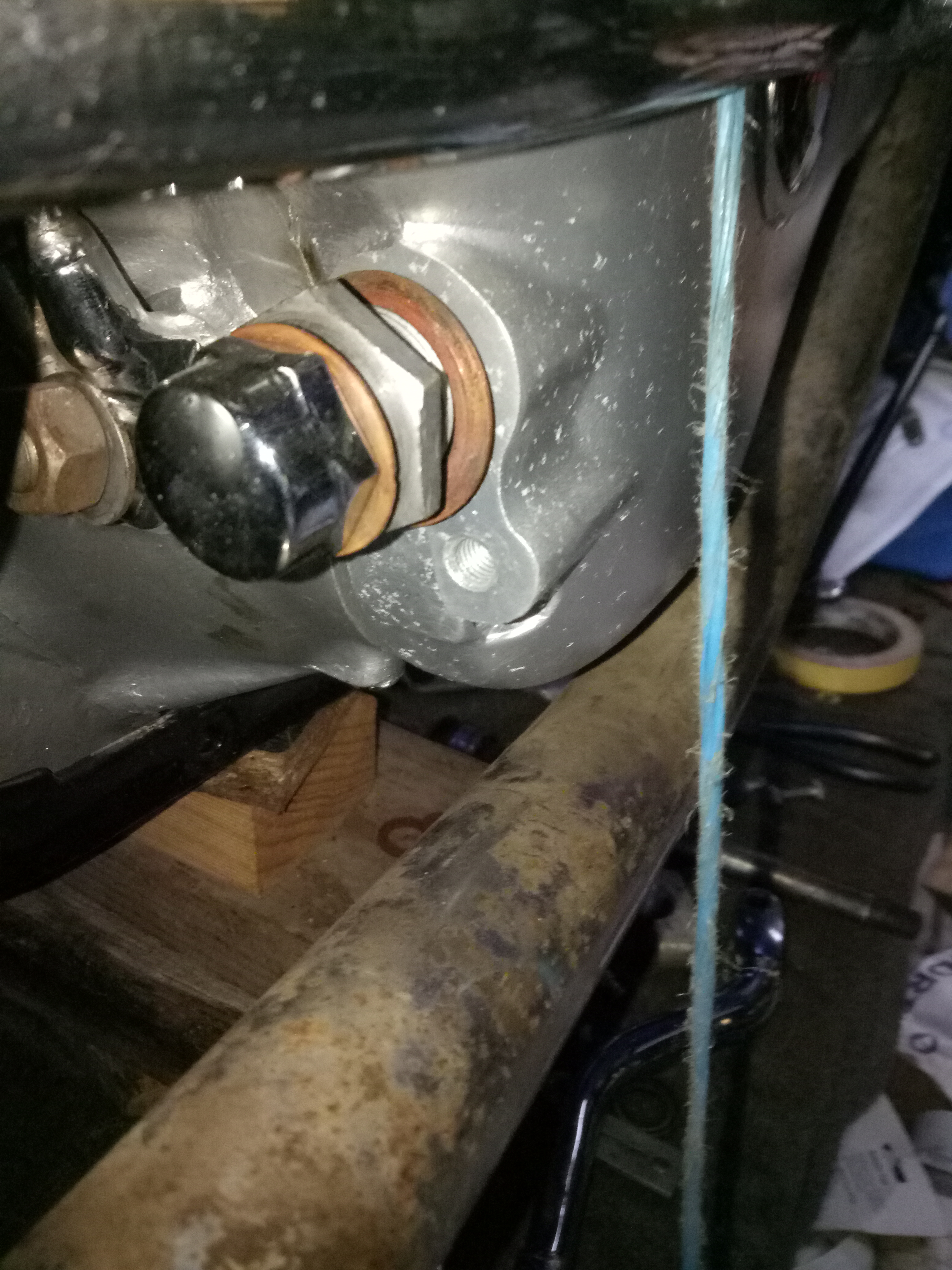

Hi Peter,
Here's the setup on my plunger Model 7. The oil line is not in it's actual position so you can see the set up. Rocker feed is on the return union in the oil tank.
