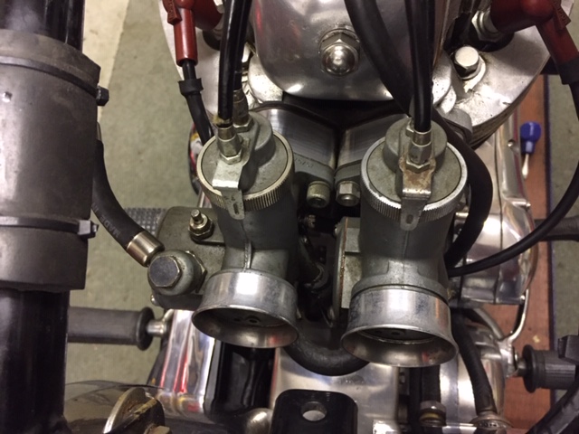

So you have a 99 head with a twin carburettor manifold and you find the carbs have to be Left & Right handed and you have the common ancestor with the float bowl on the left as in all presumably the single-carb variants and you have yet to see a Right-handed float bowled carburettor!
What do you do?
Are twin carbs worth the trouble?
Can Batman Help?

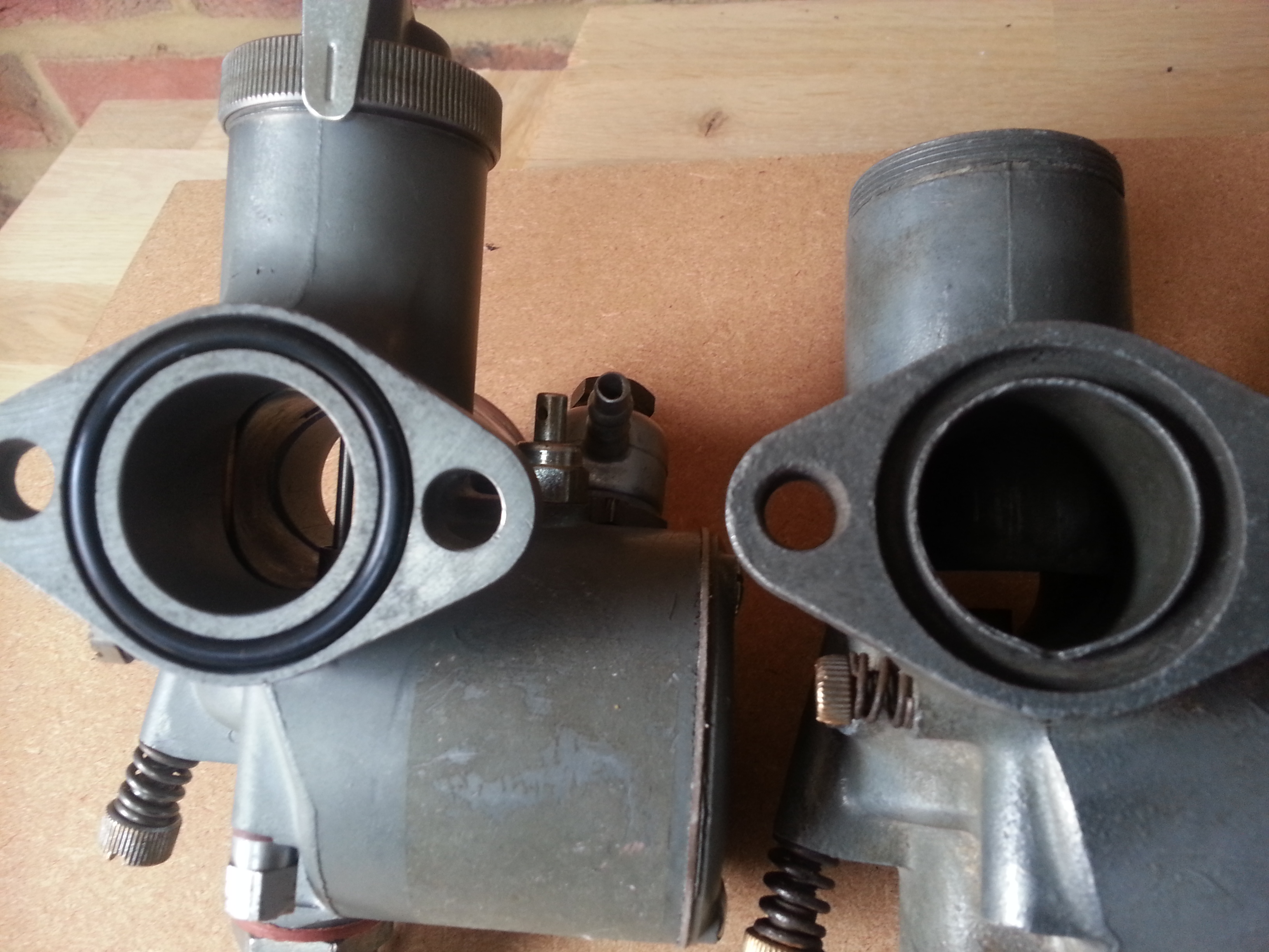

Seriously I have a newly refurbished LH Float bowl carb, where do you find the matching one to have a functioning and easily adjusted pair?
Plus look at the bore/ gasket thickness difference, on these Carb'both 376/ 1 1/16 th bore/chokes.

The 99 Model big-valve heads that had the twin carb manifold were usually fitted on the S and SS models were fitted with two standard 376 AMAL Monobloc carbs that had a float chamber on the left-hand side and the adjustment screws on the right. The 88 Model big-valve heads also used this twin carb manifold primarily on the S, SS and options on others. When the Semi-downdraught cylinder head was adopted on the 88SS then like its bigger brother 650 the right-hand carb had its float chamber chopped and a link was made between the main jets via a banjo on an extended jet holder at the bottom of the carbs. For racing, where one float chamber was not considered of sufficient quantity, a carb with a right-hand float chamber was developed but these tended to be in the 389 (689) size ranges. If you have a 99S or 99SS head then keep both carbs and occasionally give it a squirt - you'll see why two are better than one......Cheers, H
I had one of those splayed…
I had one of those splayed manifolds on my hotted up 61 88, with two standard 376 carbs ,an SS cam and HC pistons , It was a pig to get at the carbs but kept up with the mates pukka 99SS and 650ss. A very underated machine the 88SS. Wish I had it now.
Thanks guys, so a chopped…
Thanks guys, so a chopped Monobloc and a regular Monobloc with chamber extension is the way to go?
John
If you like John -- But I…
If you like John -- But I should only go that way with a semi-downdraught cylinder head. Make sure that both carbs match the inlet ports . Cheers, H

Same manifold?
Logical that the 99SS seems to have had the same spec as the "Special" options in 1959. Two standard carbs then? I can't remember when they brought out the chopped version. Didn't they produce left and right-handed Monoblocs once? There are still splayed manifolds available machined from billet.

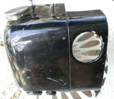

I'm more interested in finding the original air filter, available as an optional extra in 1959 (and probably other years too - I haven't checked my Parts Lists) , or at least a photo of one. It fitted on the studs at the back of the oil tank and behind the steel panel, which bridged the gap between oil tank and battery box. Stupidly, one of the first things I did was to cut it off! Well - I was only 18! Luckily I found a cheap replacement at Kempton Park complete with the infill panel. I think I have two spare oil tanks now! The advantage of buying and rescuing/restoring bits is that, at the end of the day, you can always sell your surplus at a decent price as there is always a demand.
The Box filter that lives…
The Box filter that lives between the oil tank and battery is (or was) availiable from Norville . I have one on my 99. Its not a very impressive thing needing a bit of re-shaping to fit. A ring on the carb accepts a rubber connector (a bit too loose) that connects to the box. The filter can be constructed from half an Austin Mini filter with some mastic to seal. The box needs painting. Its a very tight fit to the outer flange of the oil tank .
Filter unit
Thanks Robert (I'm guessing yours was a reply to mine?). Norvil (Not "Norville" - that must be in France!) list filter housings for various models but have no photos. I wouldn't risk buying something I can't see. I imagine they are almost impossible to access once installed, and very difficult to install if the battery box and oil tank are in position.
Just to be clear, I'm talking about the type with the centre panel welded to the inside edge of the oil tank. I've pinched a photo from eBay as mine are buried in the workshop!

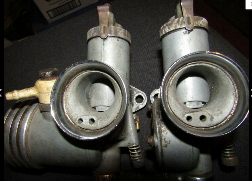

I certainly remember fitting a pair of matched 389/689 to a 650SS in the 1960s. I don't think that there was ever a matching 676 variety with right-hand float. They did make a difference flat-out on the back straight at Aintree. Cheers, Howard
Wrong carb!
Thanks Howard. I have removed my previous post once I realised I was wrong - it was a left hand on sale, not right! Silly me!
Norvil make references to right-hand carbs in their lists so I'm pretty sure they were produced some time in the late 1960s or early 70s. Along with Hen's Teeth I suspect.
The box filter bolts to the…
The box filter bolts to the back of the oil tank using the threads already there. It would be impossible to fit with the battery box in position. Having used both Monoblocks and concentrics I view the mono's as superior in all respects.
R/H carb
Did you mean a monobollock with the floatbowl on the right? There were a left/right pair on ebay recently. Didn't Triumph use them at one time? As for a chopped 376 as per 650SS, have a look at:

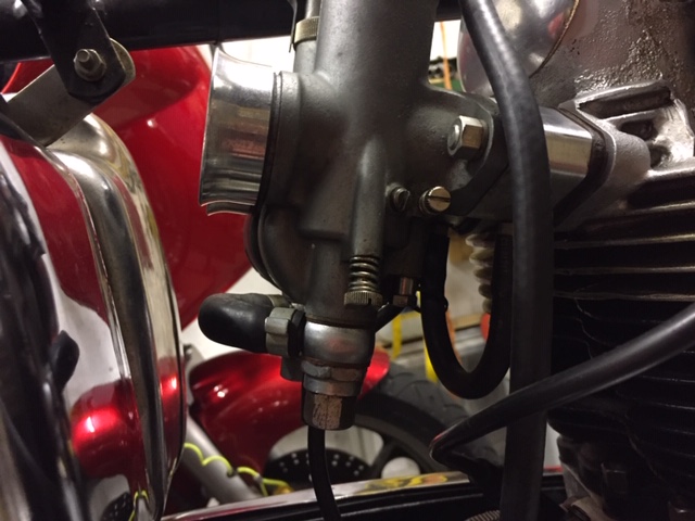

Worst thing re: twin carbs (pre-concentric ones) is accessing the air adjuster screw on the left carb.
