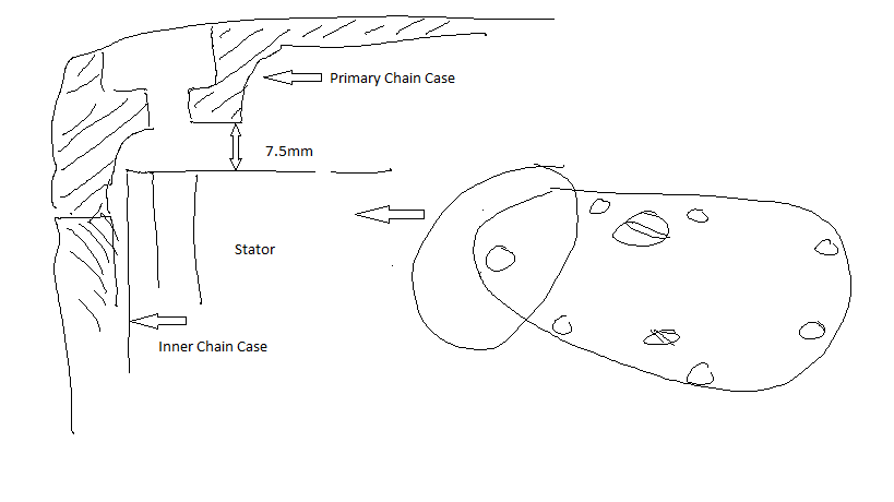

In a recent post Dan mentioned he had had some success with aluminium solder. I have a small crack in my chaincase where the case bolt that goes through the stator - formost bolt, has been over tightened and cracked the case. I thought I might have a go at soldering this with one of the rod kits available. Could anyone tell me what brand works best and how do you get the oil out of the aluminium edges - heated or solvent etc. From what I have read these rods are now much better and do not need a stainless brush etc.Related to this, the case is cracked because there is a gap between the mating face inside the chaincase and the stator, approx 5 mm but I will measure tomorrow. Is this normal or a case of the stator being either wrong or incorrectly fitted.

Back to Andrew's problem, (my apologies for wandering off subject slightly).... perhaps the best thing is for him to get it proffessionaly TIG welded locally too.
Also his problem of ": Related to this, the case is cracked because there is a gap between the mating face inside the chaincase and the stator, approx 5 mm but I will measure tomorrow. Is this normal or a case of the stator being either wrong or incorrectly fitted."
This part does not seem to have been responded too yet.
Les
I don't have a lightweigh…
I don't have a lightweight but even so it's hard to believe Norton expected another company (WIPAC?) to supply the stator ready machinedto match the same tolerances that Norton achieved on their notoriously old machinery. Is there a machined face inside the cover to match the stator?
Some lesser marques fitted the stator to the cover (as I understand it). That must have made setting out more difficult but presumably they had jigs to do it and the cover was probably dowelled to the crank case. But as for fitting both at the same time - seems unlikely. It would present manufacturing problems for no benefit.

Hello David, that's the funny thing, the most forward Chaincase bolt hole has a machined face that lloks like it should sit on the stator, but measuring it yesterday, there is a gap of approx 7.5mm between the stator and the sholder in thje chaincase. The stator sits approx 10.85mm proud of the secondary casing. for the main

Hello David,
that's the funny thing, the most forward Chaincase bolt hole has a machined face that looks like it should sit on the stator, but measuring it yesterday, there is a gap of approx 7.5mm between the stator and the shoulder in the chaincase. The outer face of the stator sits approx 10.75mm proud of the secondary casing. For the outer chaincase, the distance between the inner bolt face and the edge is 18.45mm. I think I would turn a spacer to make up the gap. Difficult to explain in words....
