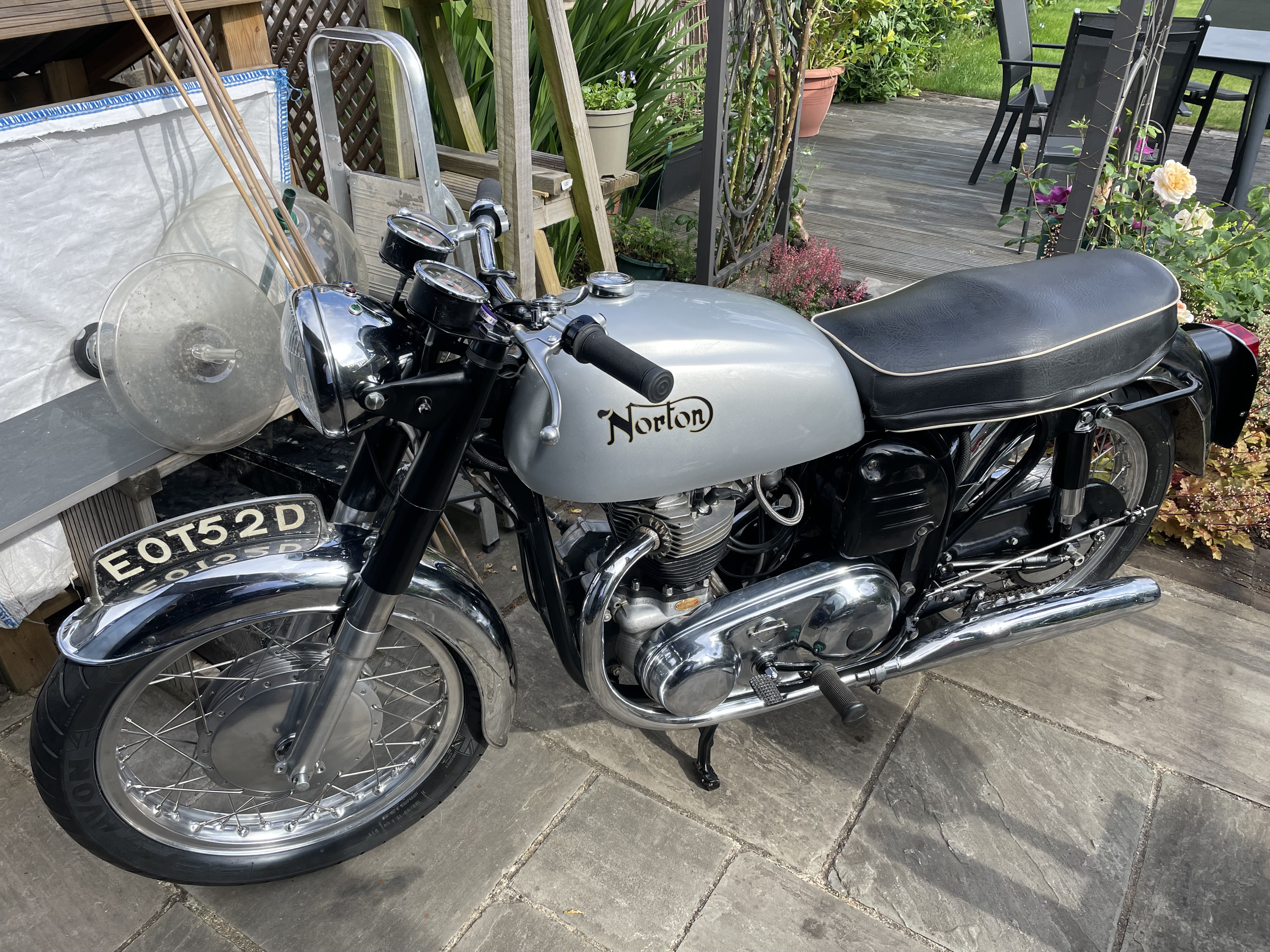

18 months or so after taking on my 650ss I’m almost at a point where I can wheel her out and get on the road. It has been, as the youth say these days, ‘a journey’.
Happily for me the bike started first kick (!) and seems to be running strongly and smoothly with a healthy tick over at around 800 rpm. My other half says the bike sounds ‘lusty’ so that’s clearly a good thing. The ignition and carb settings seem fine, and oil is returning to the tank in reassuring quantity and seems to be getting up to the head as well.
So thanks are due to all who helped get me this far, many of you are on this forum. Obeisance is also due to all the YouTube ‘experts’ and a special mention for Mr Mick Hemmings and his various DVD’s.
So far I’ve not been able to put her into gear as I don’t have a working front brake and I have visions of that ending badly! A new cable has been ordered from Venhill. Whilst I wait for this, I’m trying to sort the inevitable hum-drum issues such as oil leaks from the primary case and making sure everything is tight where it should be, and loose where it needs to be.
Next steps will be to venture out onto the King’s Highway. I don’t have a long drive or anywhere else to try the bike out. It’s not an option to chuck her in a van and find an abandoned car park. I’m not far from some quiet country lanes and this will have to do. I still have to get here however.
Now that I’m almost ready to pull away I’m starting to overthink this. This is after all my first Norton restoration, and my first ‘big’ restoration ever.
Does anyone have a check-list for commissioning a bike in these circumstances or have any wise thoughts before I pull in the clutch and engage first for the first time? Yes – it’s road legal - taxed and insured - before anyone asks.

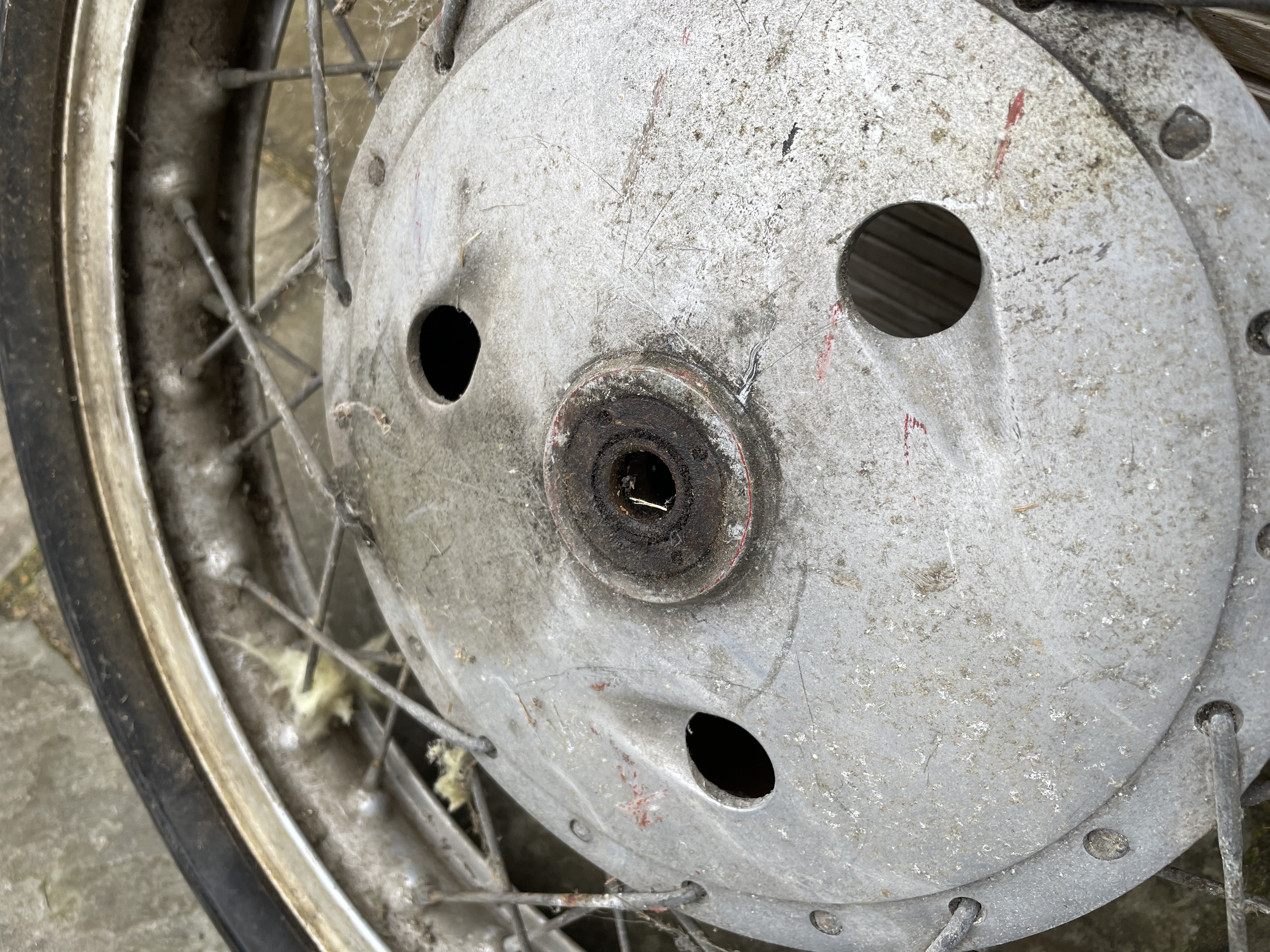

The head has been racing and was at some point drilled for lock wiring the exhaust roses, and I do have an original front brake hub which was also professionally modified for performance with three air holes. See photo. I assume this must have been with a TLS brake but sadly this hasn't made it with the bike.
Frankly the whole bike gives off a bitsa vibe and it's not exactly clear how I refer to her - is she an 88SS or a 650ss or is she a plain Norton 650? A Bracebridge frame with a Woolwich engine? FrankenNorton perhaps? Answers on a postcard......
I trust you checked details against the paperwork.  I had a model 50 slimline in a 650SS coded frame. All details matched the paperwork but the18 code was on the frame.  Many are built up in similar fashion to yours so it doesn't make it any less of a joy. There were no TLS brakes on this age of machine. When you do your checks, remove that green wire around the footrest. Looks like you may have held up the brake pedal with it during assembly. Is the rear mudguard split at the tail? Intentional or progressing fault?  Grips are with controls for lights and indicators, are you wired for indicators? (I see something on the headlamp ear). A good feature for modern riding.

Jon - The green item is a rubber band and prevents the brake pedal impacting the footrest nut. The brake arm needs to be fettled (heated and straightened probably) and put into final positions but I'm still working out where works best for me. The rear mudguard is slightly creased but not split and looks a lot worse in the photo. The bike needed a complete electrical overhaul and now uses the Motogadget system with a bespoke wiring harness, LED lights and mini indicators.
The bike did not come with pillion rests and her indoors says she won't be joining me. I'll bear in mind your comments about securing the exhaust Rob - for now though they are nyloc'ed and thread locked.
Alan - yes the top front stud is missing - it feels like it must have sheared off. I am happy for now that it's not an issue and the engine is very well supported at this point. It is on my list for a bottom end rebuild as and when time and funds allow.
I'm in the process of RTV'ing the tin chain case to stop the oil leak and the new front brake cable has arrived and fits nicely. If the weather holds I'll try and get her out this weekend. Wish me luck!
