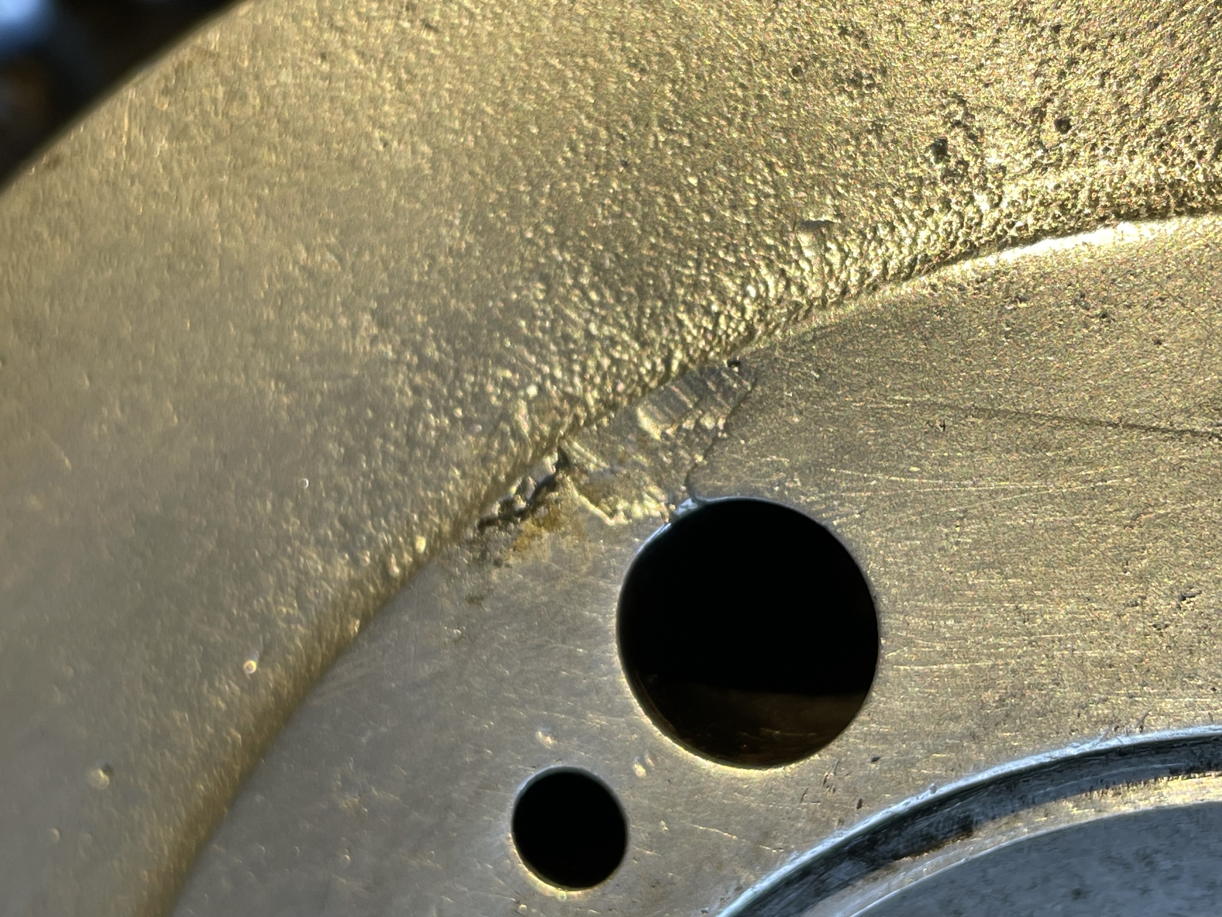

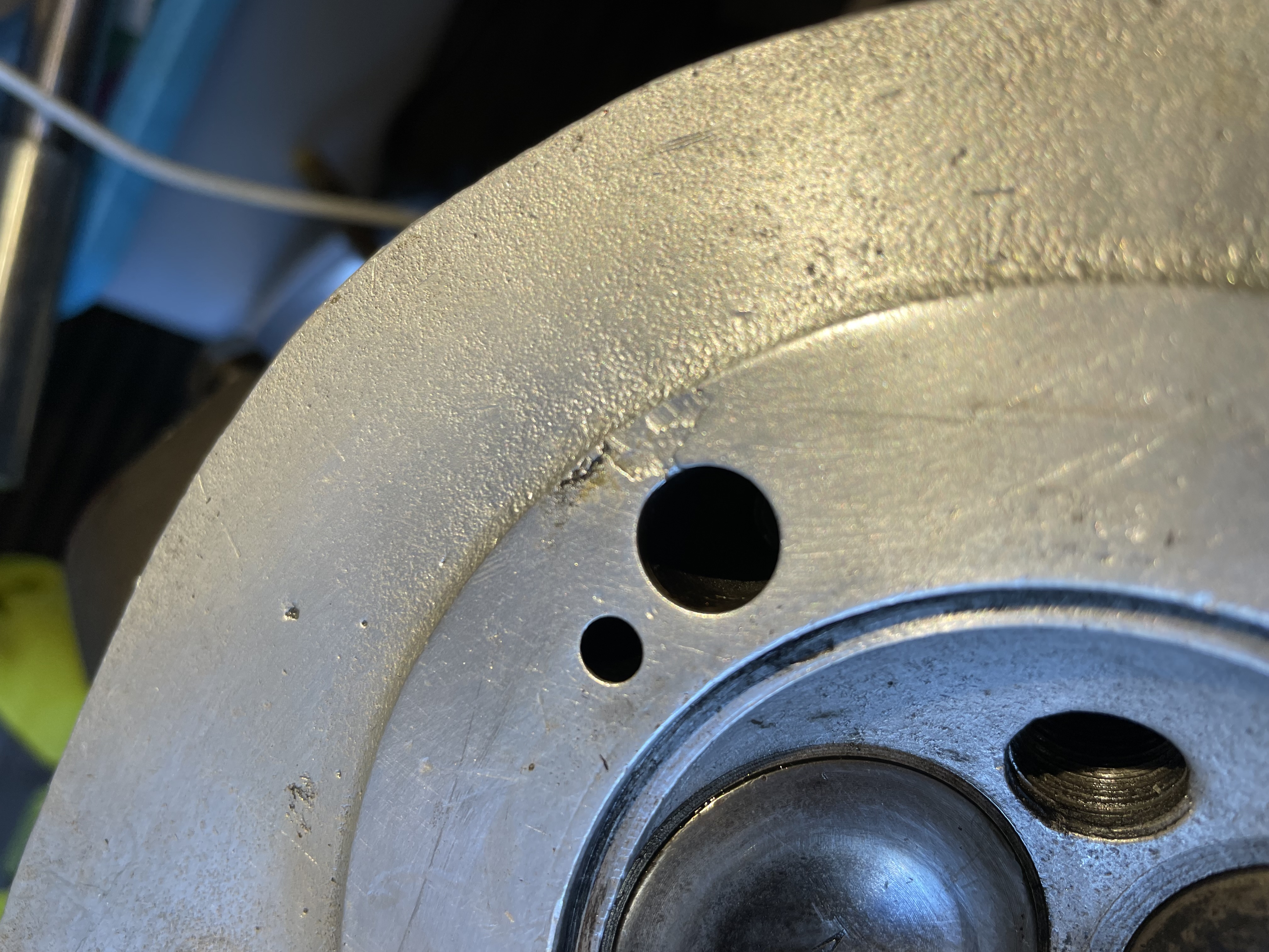

On stripping the engine (again) I noted there is some damage to the head around about the area where the leak seemed to come from. See pics. Could this be the issue? Would this cause a loss of compression? Seems unlikely but what do I know.
This is a spigoted head. If the fix is to skim the head then what about the spigot on the barrel?
I'm going to try removing the studs and check the head is flat but other than this do you have any advice for how to proceed??

You could always try JB weld…
You could always try JB weld as it is only an oil leak.
Put some weld over the bad area, grease/oil the barrel over the same place as the bad area on the head. Replace head on barrel without gaskets, leave for a few hours, should still be soft, lift head off, remove any JB from unwanted areas smooth flat once hardened off.
As for the loss of compression you will need to investigate the valve seats, valve faces piston rings, cylinder bores, and tappet clearances to find the culprit.
At a guess I reckon your tappets are not set correctly.

From past experience
Do not skim the head. Doing so will cause knock-on issues with the barrel spigots, gasket sealing, pushrod lengths and oil leaks.
Your problem could be quite simply that the head has been already skimmed and the spigots are holding the head off the gasket. You can get extra thick solid copper head gaskets but they are not easy to anneal correctly.
Measure up and work out if your gasket is doing its job properly.
Try a composite gasket.
I made a sandwich of a solid copper and composite gasket to prove that my spigots were too long.

You mention the problem was…
You mention the problem was near the rear. Is that awkward bottom centre nut tight? Mine stripped years ago and was helicoiled
JB or similar should be worth a try. The surface we can see looks good. Have you cleaned it after the leak? It's very clean...doesn't look like gas has been going through.
Is there an oil leak from a rocker cover? It can ooze round the joint and come out at the rear.

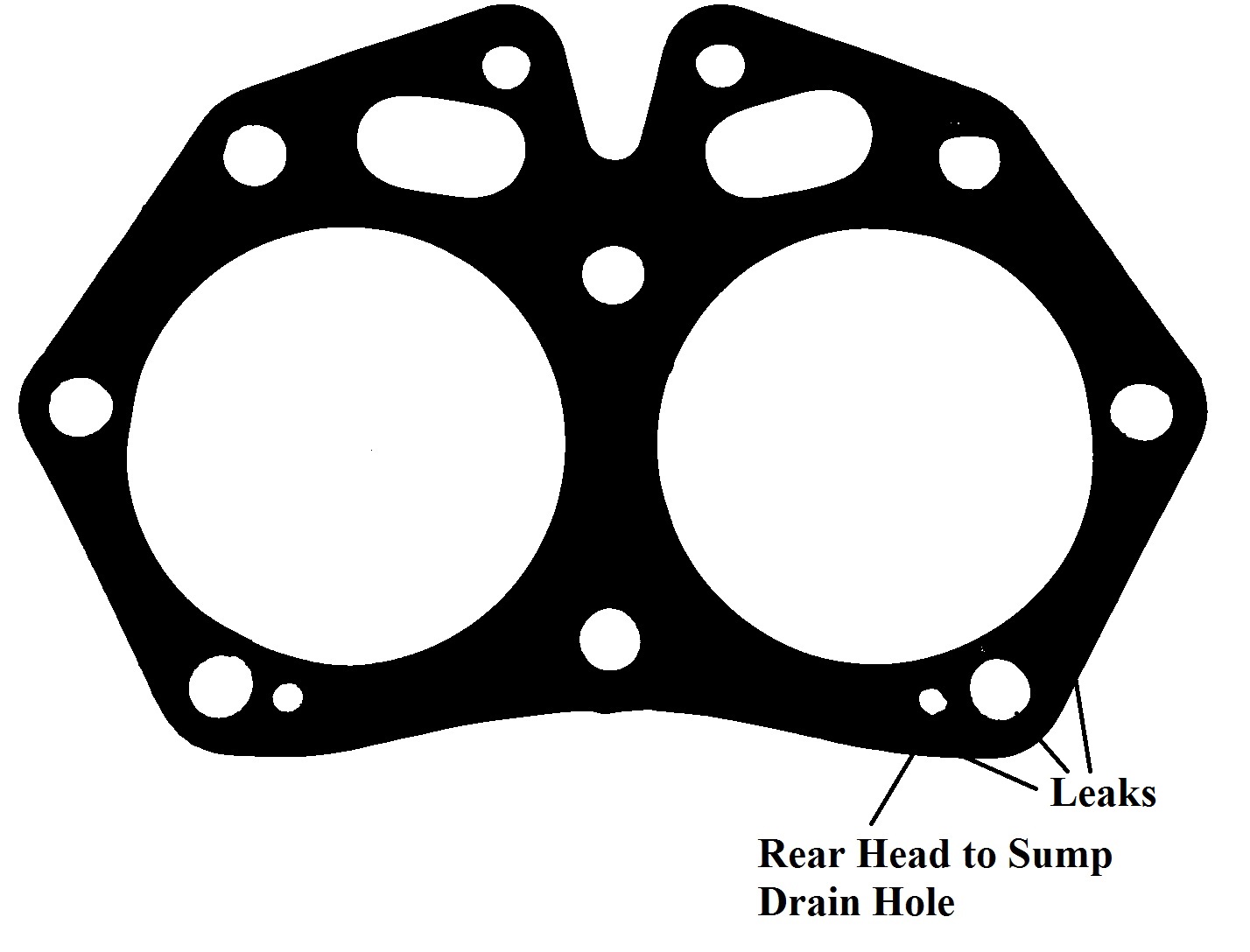

The early 650 and 750 cylinder heads, made at Plumstead, were cast using a very coarse alloy mix which led to porosity issues. These often appearing in the vicinity of the back right-hand side head bolt. This being next to the rear oil drain tunnel which itself gets the full force of any internal crankcase pressure. The leak can be due to oil forced through the gasket in this area or even the metal itself. Back in the 1960s, a temporary fix for the weeping metal was a good clean of the area and then a coating of Araldite warmed with a gas torch to help it get into the pores of the metal.
The photographs show the rear of the cylinder head at the point mentioned above. The drain hole leads from the rear rocker box down to the crankcase. This it does when the pistons are rising. But when falling the pistons increase the pressure within the crankcases. This is used to force oil and oil mist around the engine to lubricate the camshaft, follows, pinions, gears and chains. The camshaft breather takes away a good percentage of the pressure but as well as lubricating the internals oil will get pushed up from the sump, through the drain tunnel and back to the inlet rocker box. On its way, it has to pass through any cylinder head gasket. This is the weak area mentioned above where leaks can occur.
Thanks Phil. I found that…
Thanks Phil. I found that the gasket is not quite correct at the drain hole and was obstructing the flow. On taking the head off there was oil under the gasket. I've filed the hole a bit wider to allow the flow to be unimpeded and will also use Welseal when I come to put her back together again. I hope that's what the issue was.
