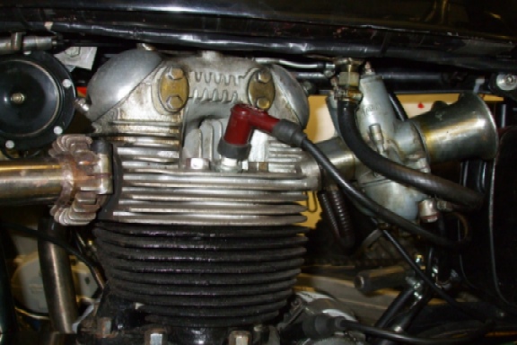

Hi all, thanks for your co…
Hi all, thanks for your comments.
I have just got the bike and it's been a bit modified. Twin carbs fitted as on a 650ss - it may have a downdraft head. The exhaust rings are different being a clamp arrangement, fastening the pipe to a screwed in stub, I presume.

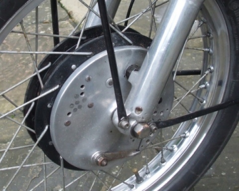

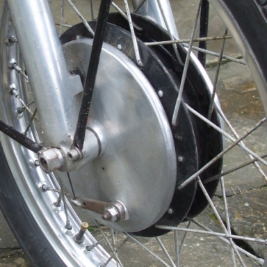

The front brake is also interesting having been made out of 2 standard SLS Norton brakes back to back. The operating lever is reversed on the left side and a right hand side fork leg fitted to provide a brake anchor. I guess it's possible that it may be twice as good as a standard brake.

That's a downdraught head…
That's a downdraught head. I can't tell from the photo how the exhaust is fixed but it's ugly. I fear you might find the exhaust threads ruined. The brake is interesting. Can you post a couple of photos?

Hi Alan Picture of exhaust…
Hi Alan
Picture of exhaust clamp is attached. There is a drawing in the paperwork received with the bike showing threaded exhaust sleeves with 2 holes through to tighten them. Note the canting of the weld in the exhaust pipe to deflect the pipes into line with the bike.
Two pictures of the front brake attached. Offside plate is standard but the nearside one has been drilled for vents - these have been removed and some of the holes blocked up. Fork leg on nearside changed to offside type to anchor the the brake. It's a cunning use of period parts to provide a twin brake. Performance is not stunning but probably could be got better by getting the lever arm angles closer to 90 degrees. The trouble is that I've been spoilt by modern brakes and the CMA 8 leading shoe brake on my Egli Vincent.

Brake picture offside. Att…
Brake picture nearside. At…
Sorry, correct picture of…
Sorry, correct picture of front brake offside.

Your cylinder head has bee…
Your cylinder head has been bodged by a D.P.O. Norton never fitted exhausts using a clamp like you show - that was Triumph's way of doing things. I am sorry, but you are on your own fabricate and fix mission to get this one working.

You will probably find, if…
You will probably find, if you remove the existing stub fittings, that a normal Norton exhaust ring will screw straight into the head. Unfortunately, you still have the problem of getting down pipes that will fit! Good luck! John.
I would like to share John…
I would like to share John's optimism but I fear that once those horrible clamps are removed that you will find the exhaust threads are ruined. Never mind that's fixable (at a price). As has also been mentioned in other threads, getting pipes that fit correctly is something of a lottery. I have seen pipes that were useless from suppliers usually considered reliable. Good luck!
Returning to the brake. what hub is it and how has it been modified? I have never seen anything quite like it.

Get the thread fixed and b…
Get the thread fixed and buy the pipes and silencers if they came off a 650ss.
Actually, I have taken off…
Actually, I have taken off the pipes as they were a little loose, tightened up the sleeves, replaced the pipes and now they are as tight as one could wish. The threads don't seem to be damaged. I'll hang fire on replacing the exhaust pipes at present - I would have to get nuts as well.
I haven't taken the brake apart yet but it seems to have been made by cutting 2 standard Norton hubs down the middle, joing them together and using 2 standard brake plates with the fittings reversed on the N/S plate so that you have a twin SLS brake. The N/S fork ally slider has been changed for an O/S one to provide an anchor. A cheap way of providing a twin brake. Has anyone seen one like this before?

Hello Looking at your photo and I can see NGK spark plug caps on a magneto , these caps have a resistors fitted inside , and they will destroy your magneto in time , you need to get some spark plug caps with out resistors fitted , yours AJD
But don't worry about the…
But don't worry about the time scale. I have in my glorious ignorance used NGK plug caps for at least 30 years without destroying the magneto. However, just to keep Anna happy I am gradually replacing NGK supressor spark plug caps on my bikes with non-suppressor ones (seeing as they don't interfere with digital telly they way they did with analogue ones).

It looks like the axle is a sliding fit in both fork legs and they are squeezed together. No pinch bolt. It must have a precision spacer between the bearings the way BMW used to set their taper roller wheel bearings but even BMW always used the pinch bolt Norton style.
