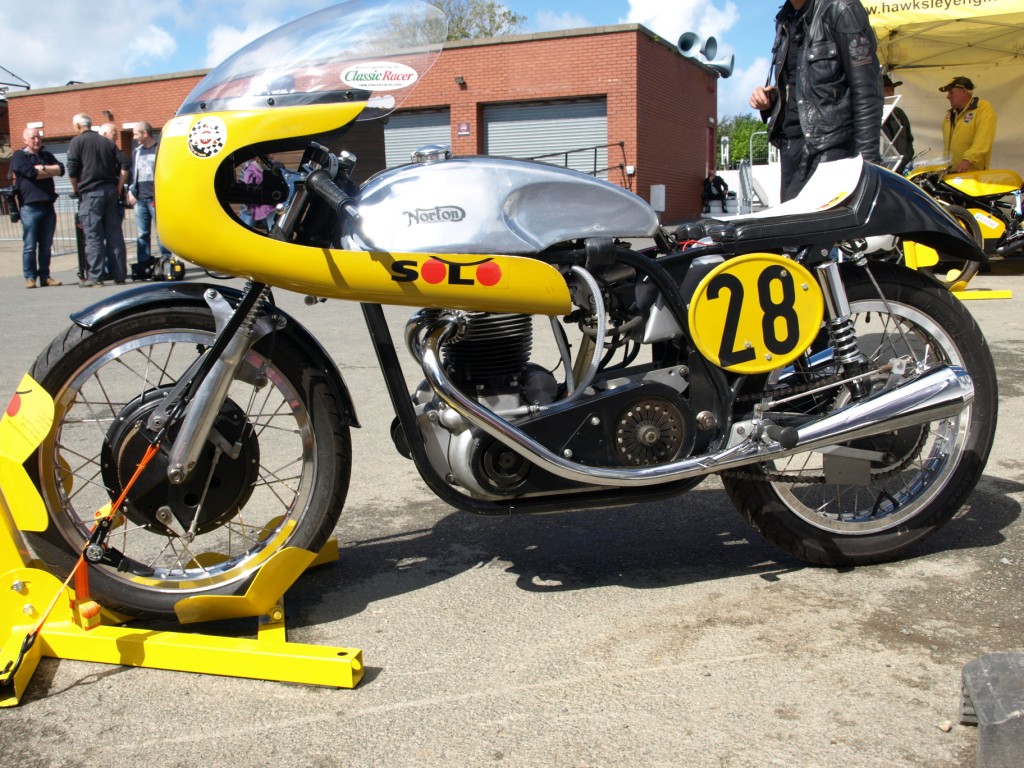

I tend to ride mine 'briskly', too! Schools of thought change with time, of course. I took these pictures of a 500cc Dommie Racer in the race paddock at the IoM Classic TT this year, and had a long conversation with the owner about engine breathing, when I caught up with him at Jurby a couple of days later.. You will see that it has 3 breathers; the big bore one I described previously, and one from the rear rocker cover. The 3rd is from the timed breather. As well as extra holes drilled in the timing side crankcase half into the timing chest, he has drilled extra holes in the drive side crankcase through to the gallery on the end of the camshaft which leads to the timed breather. I dare say he is using a 6-start oil pump.
Ian

I have a 1964 650SS engine, but in a wideline frame, with an earlier oil tank, which does not have the inlet pipe; just the breather outlet. When I had the engine stripped, I was advised by Norman White to remove the timed breather, cover the outlet with a blanking plate, and drill extra holes in the right hand crankcase into the timing chest. He then provided me with a large bore breather fitting; basically a part-threaded tube with locking nut, for which he advised me to drill a suitable sized hole in the back of the timing chest, alongside the magneto; a bit tight, but do- able. I then attached a suitably large bore pipe to the outlet, took it to a catch tank between the rear engine plates, from which another pipe then goes to the back mudguard, as you described. That pipe must not of course dip into any oil in the catch tank, as it will hose it straight out onto the back of the bike! It seem to work. The oil tank breather tube goes to the rear chain.
His explanation is that the timed breather simply does not allow the engine to breath sufficiently, hence the requirement for a large bore pipe. Presumably using both breather systems together does not work..... I believe this is the final breather arrangement used on Mk 3 Commando's, although I could stand corrected on that.
I had wondered whether a one-way valve in the large breather pipe is advisable, and would appreciate the views of others on that.
