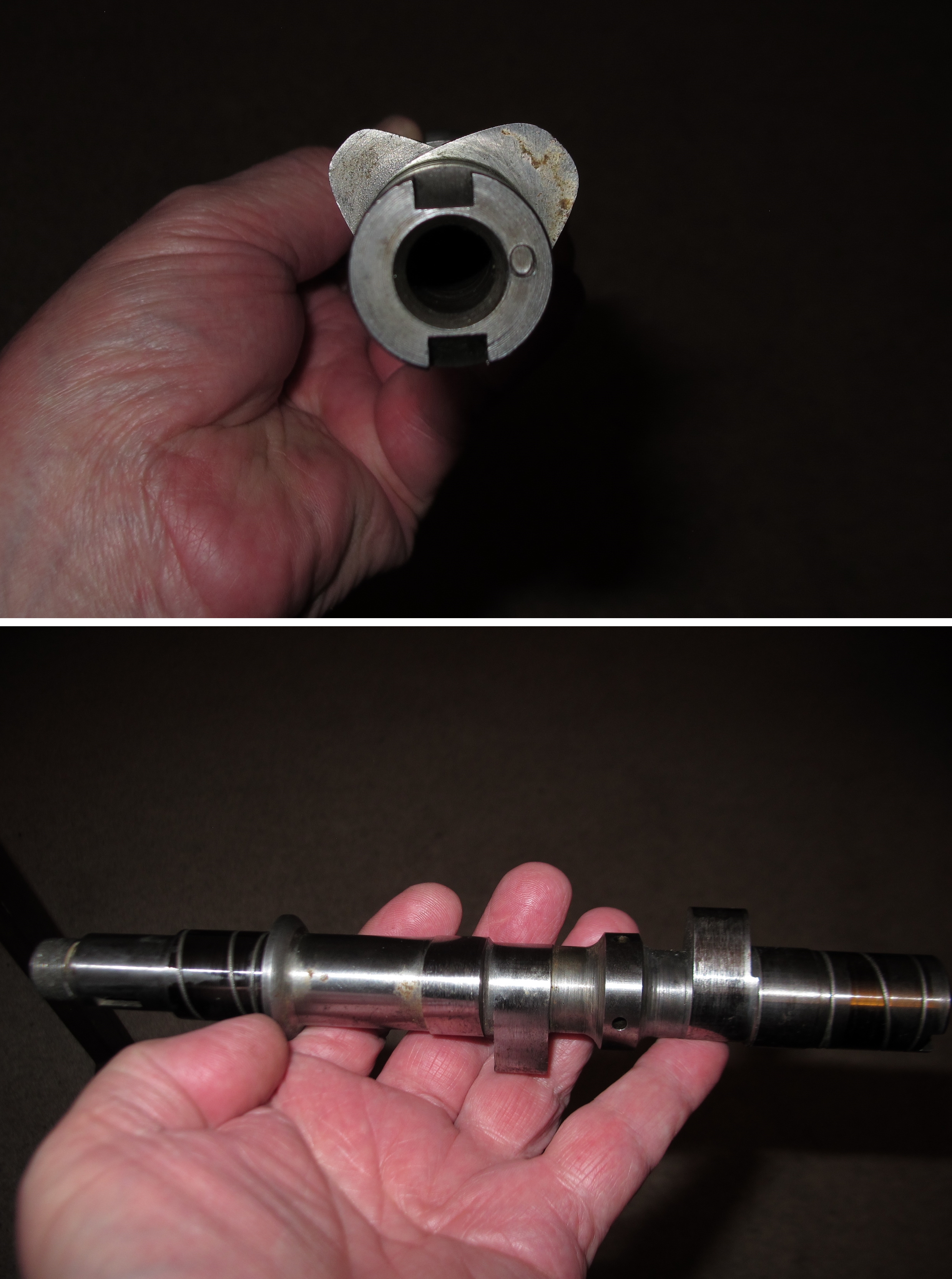

My 650SS project came with a matching numbers crankcase and a complete 'donor' engine. I was told that the engine had been "tuned for racing" and having taken it apart, it's certainly had some modification made to it. I believe that the camshaft that had been fitted wasn't the original profile. Check out the attached photograph. The shape of the cam lobes looks a bit different. I want a machine that is happy on the road, not the race track so I'm expecting to have to find another camshaft. Roger Bacon's book says that there were a number of different cams fitted over the years but isn't very specific about any of them. I've seen a couple advertised that have a "2S" designation. Would that be suitable for a road bike?

John.......find a moment or two to check out the latest version of the Dominator Service Notes. Chapter 5 page 22. - Camshafts. This has some useful information and tips. A quick link is just to the right of this posting.
For a 650SS engine you will need a camshaft marked with T2219@3. or something similar. Those marked with @2 or @3 generally have profiles more suited to pre-1958 Dominator engines. It might be worth you contacting Newman Cams. (Surrey / Kent border) For many years, they have specialised in manufacturing Norton Twin camshafts and know their business well.
Comparing that cam to a new…
Comparing that cam to a new 2S reveals a much longer duration and probably more lift as well. As Peter says ,a bit too much for everday riding . Decent 650 ss cams are often sold SH, I don't know how a 2S compares to a std 650SS , My 2S is still in its Andover Norton packaging if you are interested.

Philip... Thank you for the link to the Service Notes. What a splendid document that is. Most informative. It would seem that I should be looking for an X1 or X2 camshaft. If anybody has a good one that is surplus to their requirements, I would be happy to negotiate for its transfer of ownership.

I've now acquired a very good condition X2 camshaft... Thanks for all the help and advice.
That cam looks to have longer duration than the standard cam, lift wise it could be higher as well. The standard cam is/was a good profile. For road use there is nothing to be gained by fitting a 'performance' cam of whatever profile, it usually takes a few horsepower off the bottom end to put a couple of horses up at the top and it will give the valve gear a harder time of it.
Loads of people have been suckered into fitting higher lift/longer duration cams only to find there bike is hardly any faster and is louder to boot. If you think about how you ride, you spend at least 95% of the time at less than 3/4 throttle, completely negating the top end gain . Fit a standard cam and enjoy the flexibility it will give and the easier, less stress on a 60 plus year old engine.
