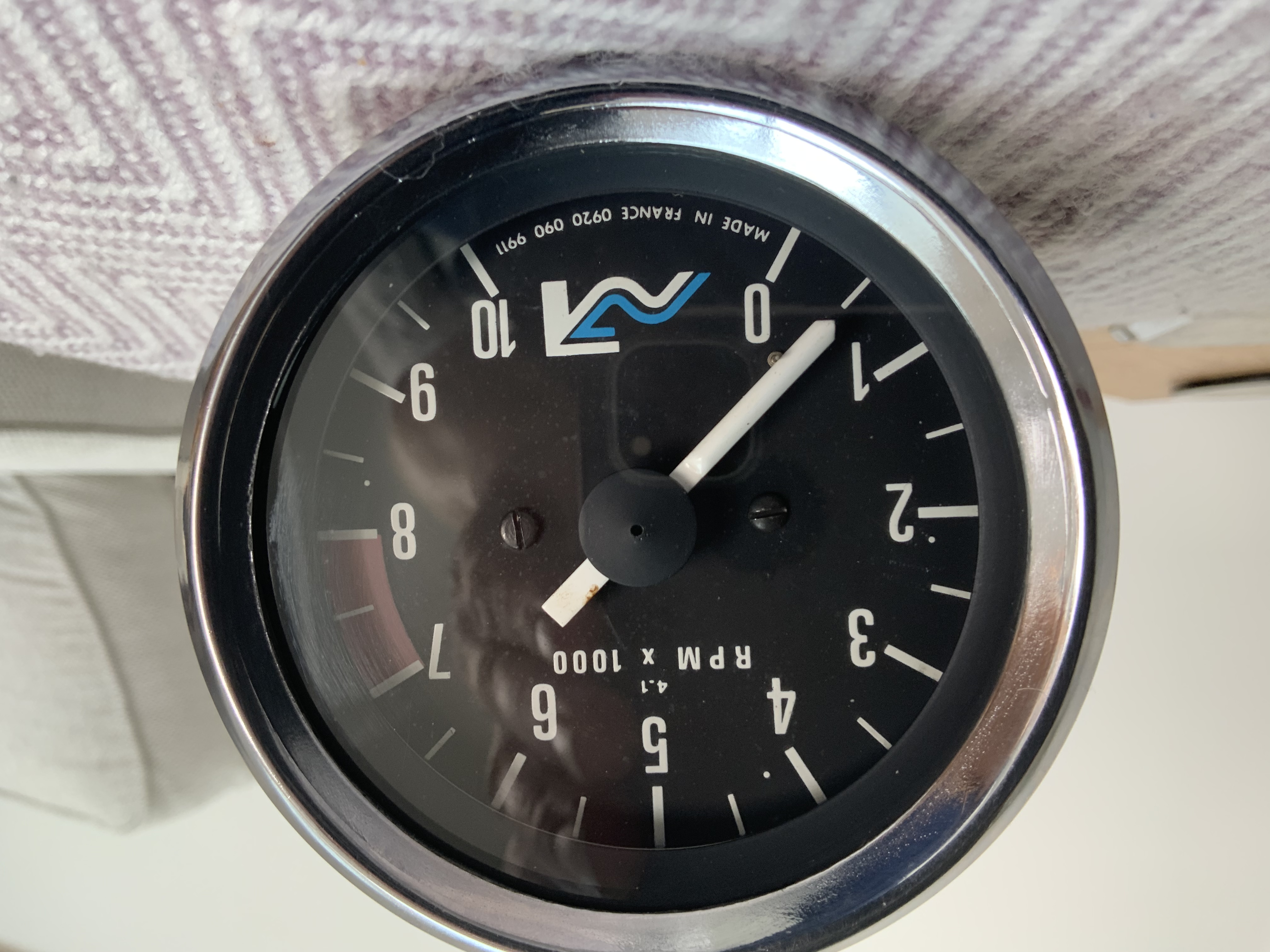

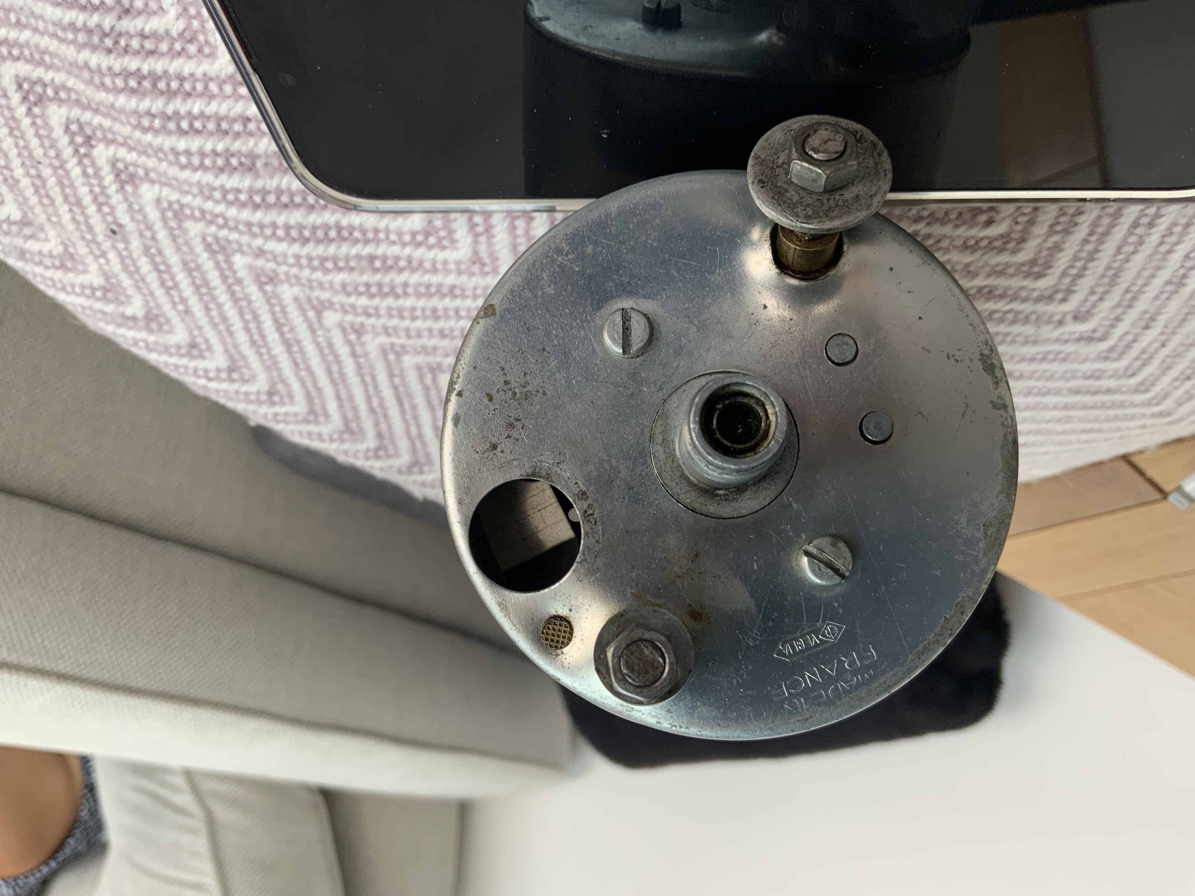

My rev counter cable looked in bad shape as the outer casing was deteriorating so I ordered a new one from Andover which arrived today. No problem until I tried to connect the new cable into the rev counter only to find it would not engage. It appears part of the square drive end of the old cable has broken off inside the rev counter and as yet I can’t get it out.
Any ideas much appreciated or can anyone recommend someone who can repair it?
Photo’s attached but probably don’t help too much.

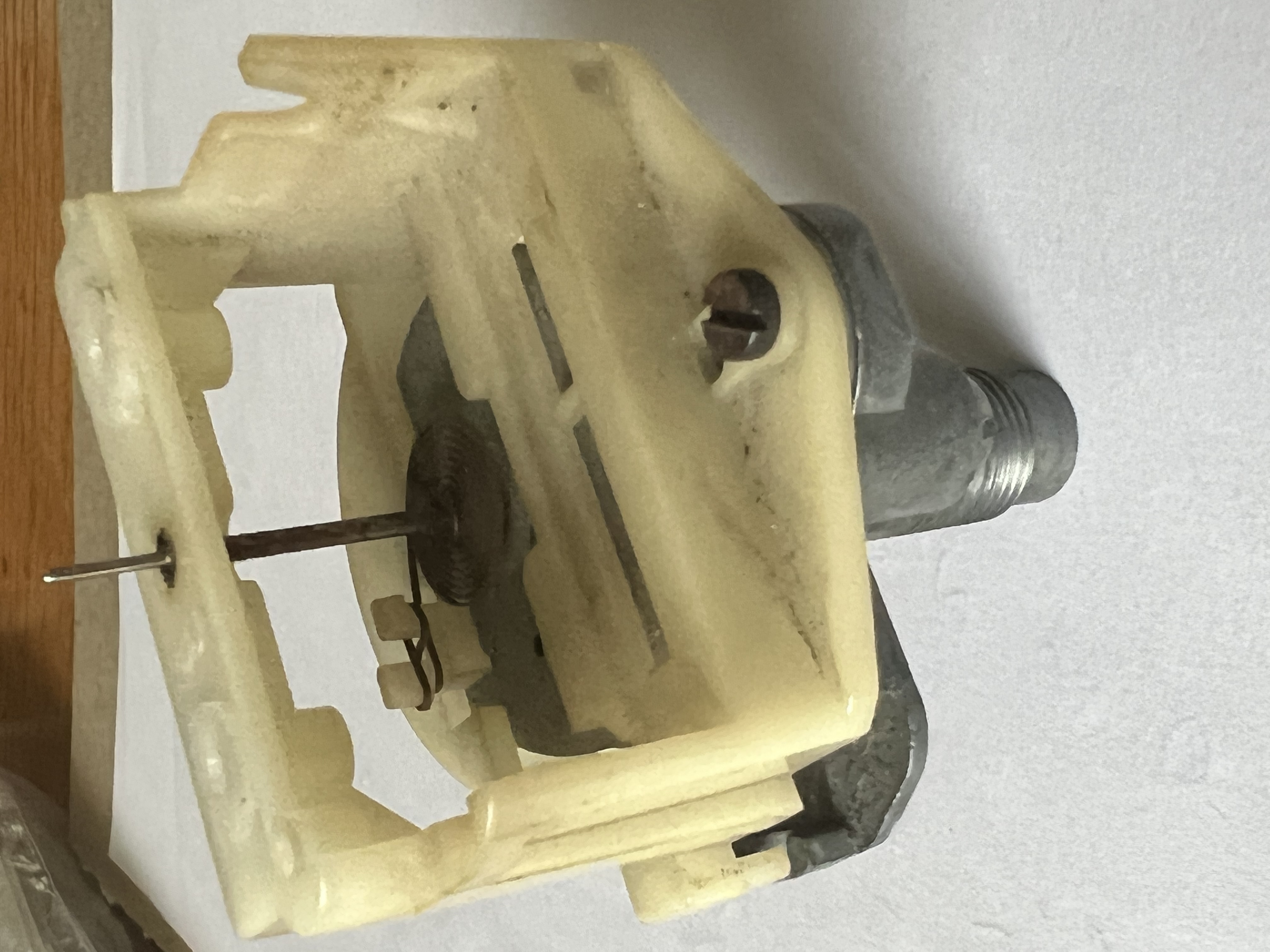

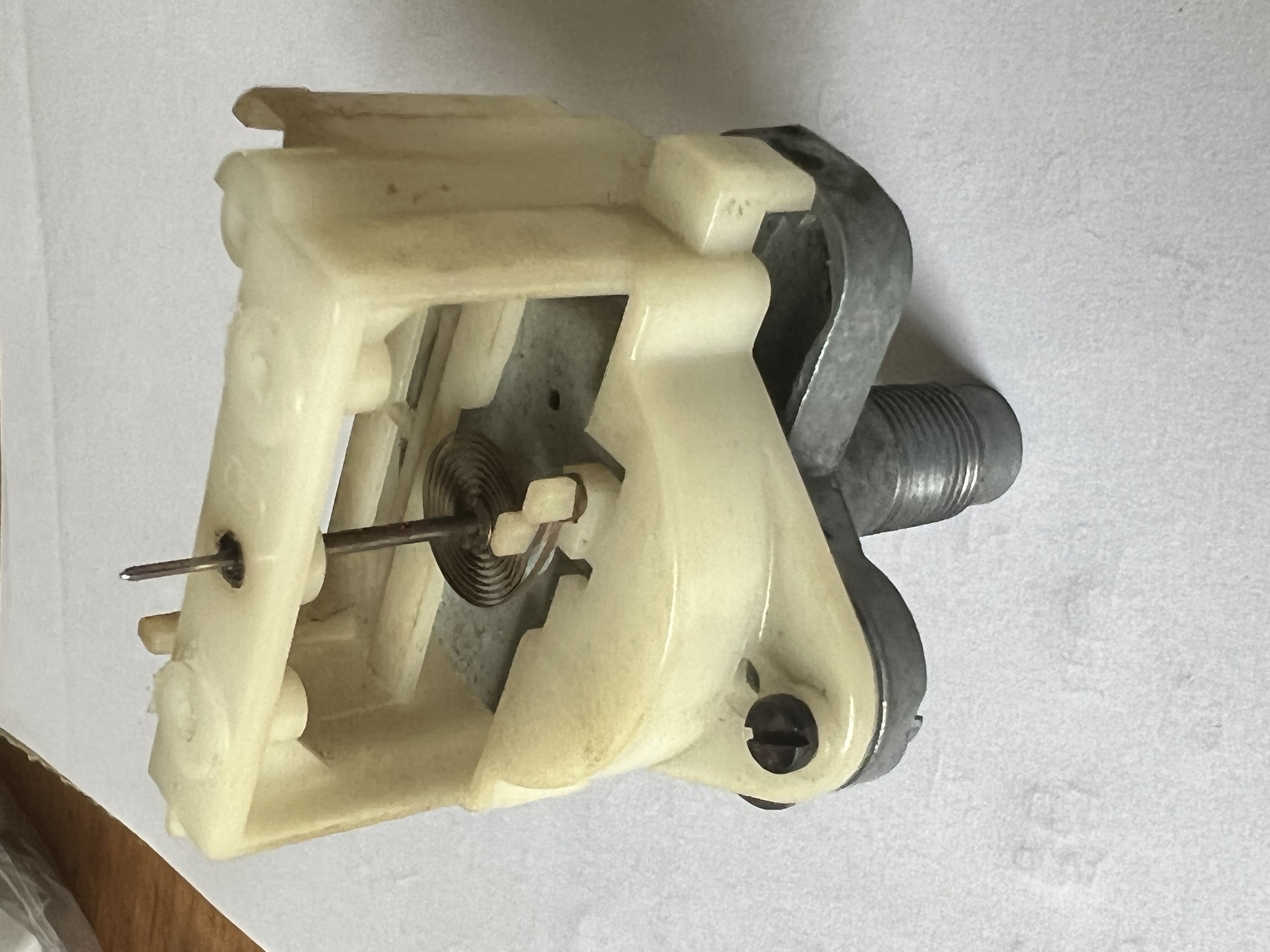

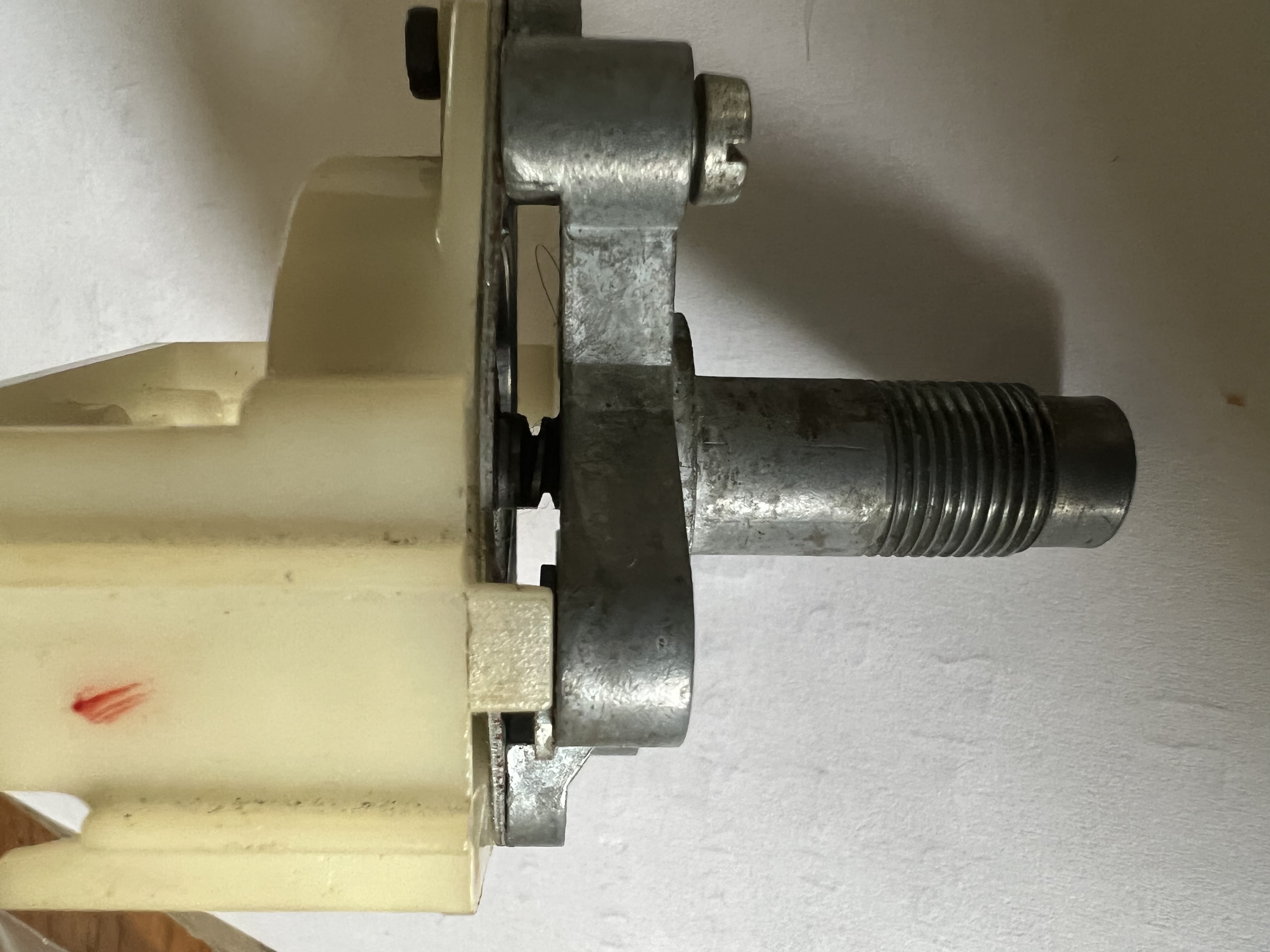

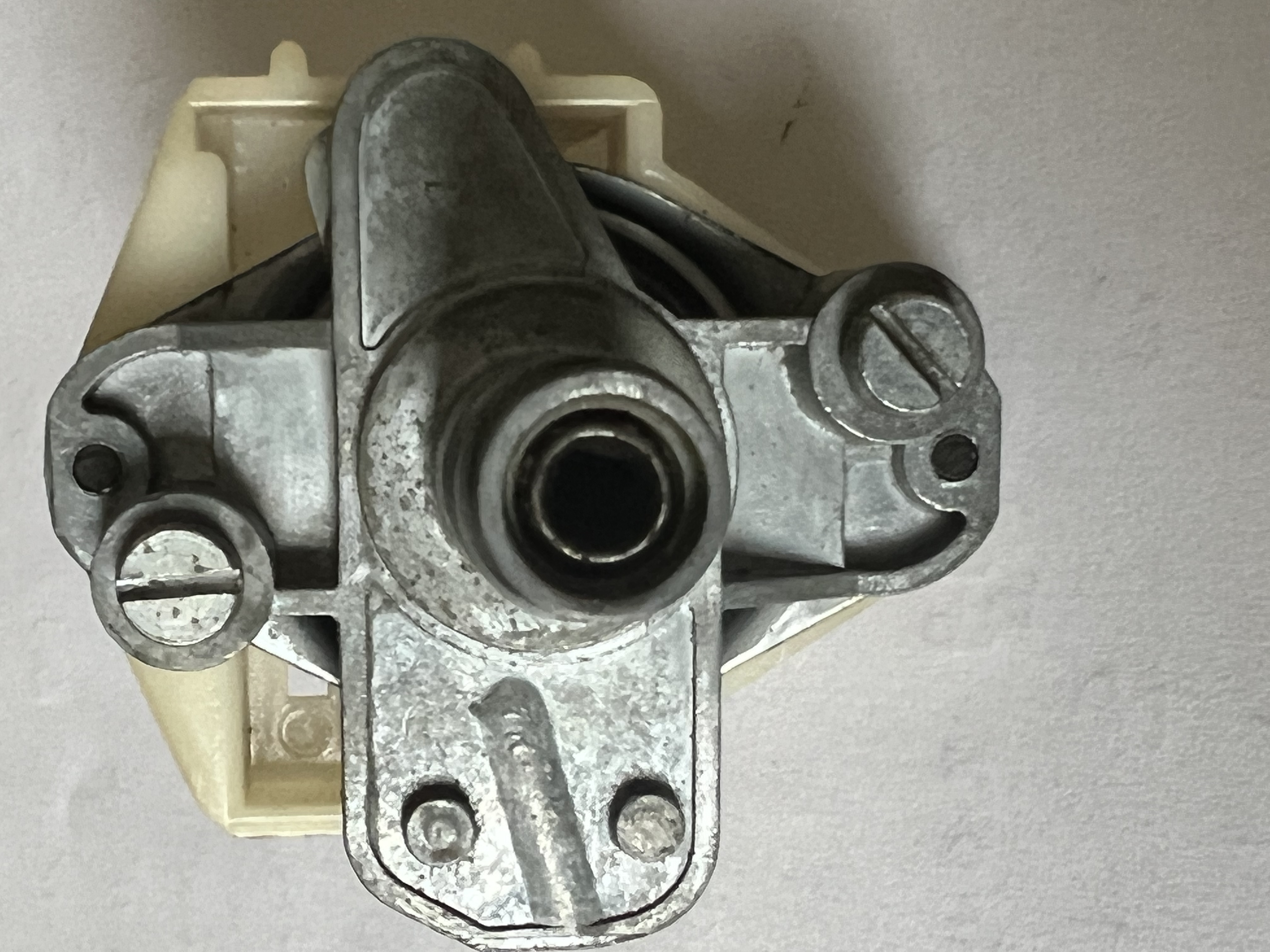

Phil, Sorry for the delay…
Phil,
Sorry for the delay in sending photos - the parts were in storage. So here is the Veglia rev counter internal assembly. It does not appear that even when exposed like this that there would be any way to access and remove the broken off cable square drive. Extracting from outside does seem the only way, which at least means stripping is not required.
Andy
