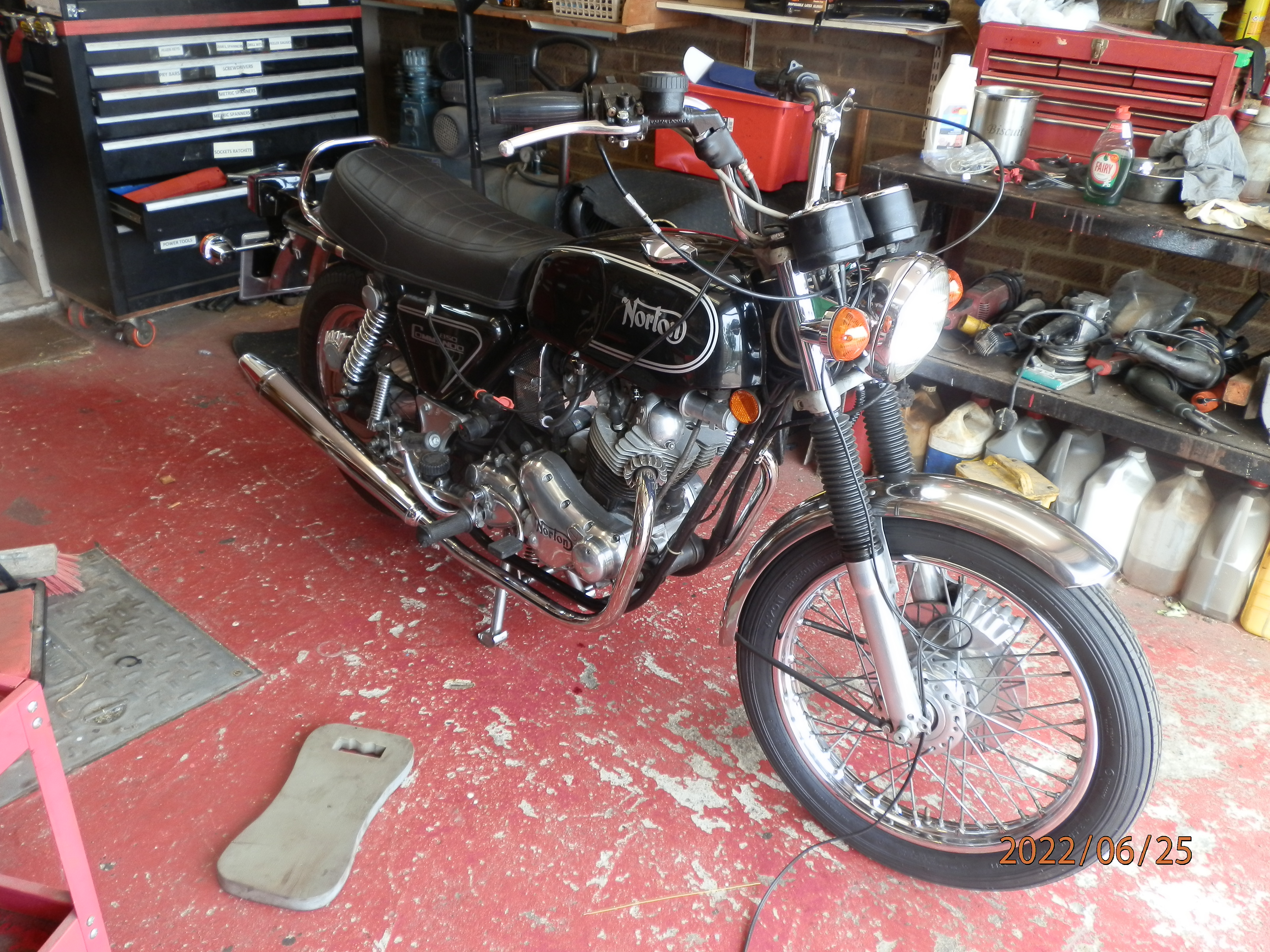

Hi again everyone I took my 1975 Norton commando on its maiden voyage today and after 10 miles of calm riding the front disc and calliper locked up, I called the AA who got to me in approx an hour by this time it had all cooled down and freed off so the AA man kindly offered to follow me home and as I turned into my road history repeated same distance each way, anyway the bike has a new master cylinder and hoses also disc and wheel and seeing all this was not expecting any trouble from that end but obviously the calliper has not been touched, so I have ordered a rebuild kit with new stainless pistons and started to gather the tools for the job, then I saw the bleed nipple which is obviously a different metal to the ally calliper and looks to be corroded and ridiculously weak I have cleaned it off with a brass brush and given it a squirt of WD40 but I honestly think as soon as I put pressure on it to release it will break has anyone a foolproof method for removing these so I can enjoy what little summer we have left Many thanks Chris

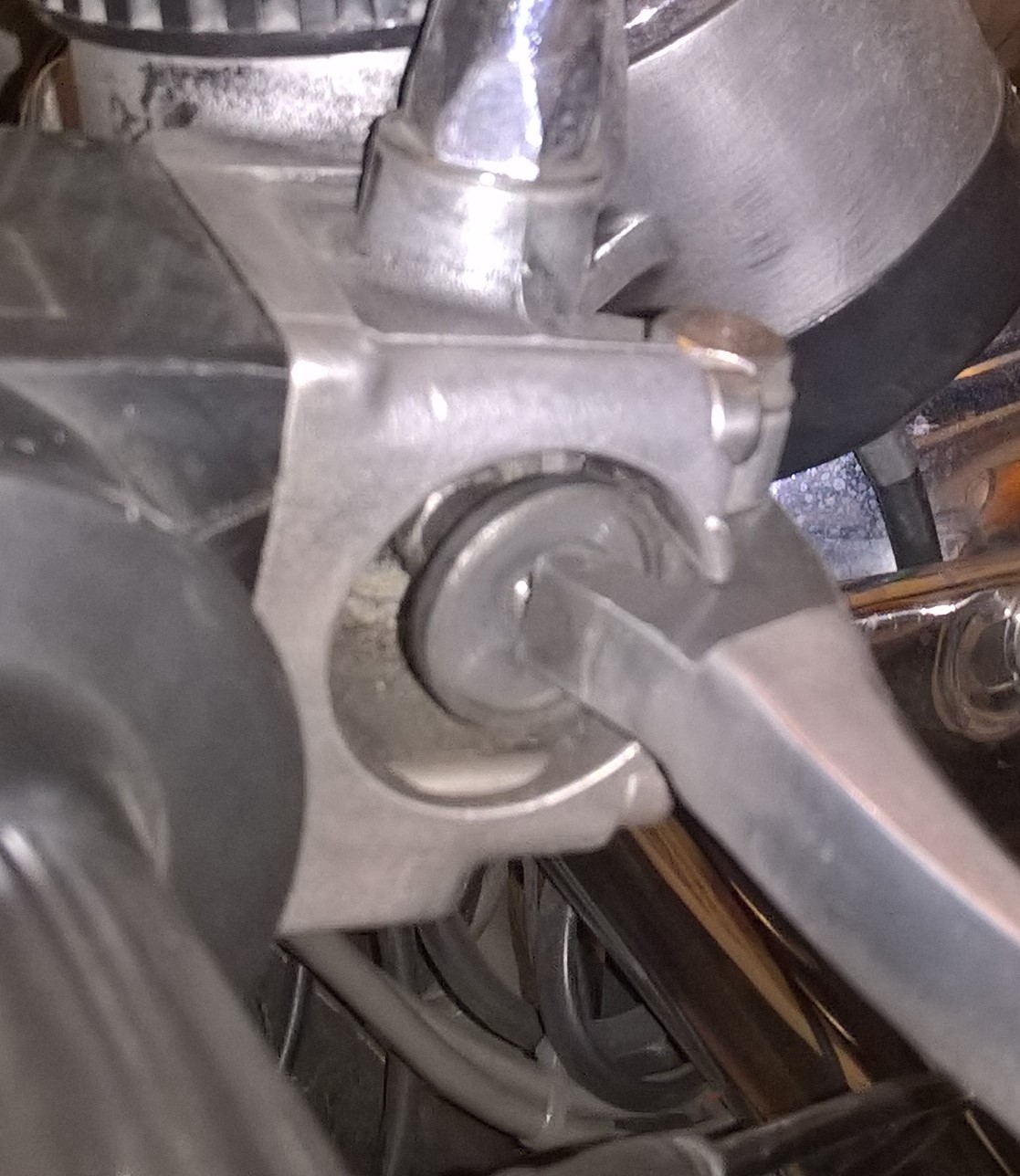

I suspect the new master cylinder has a sleeved bore to improve brake performance, but in doing this there is a risk of the piston seal not completely clearing the pressure release hole at the fully off position. The pressure is not released after applying the brake which stays locked on. It works when the master cylinder is cold but out in the sun the master cylinder heats up and whatever small gap there is closes up completely, in your case the seal may be always too far in as yours locks up after 10 miles.
The fix is to get the piston to move further back when the brake is not applied so the seal clears the hole (you can visually see this with the cap off and the fluid reservoir empty), take the hand lever off and see if the piston moves back far enough. If it does then file the end of the lever that touches the piston so with the lever in place the piston is not pushed inwards. If the piston cannot move back far enough with the lever not there then its more complicated so come back if that is the problem.

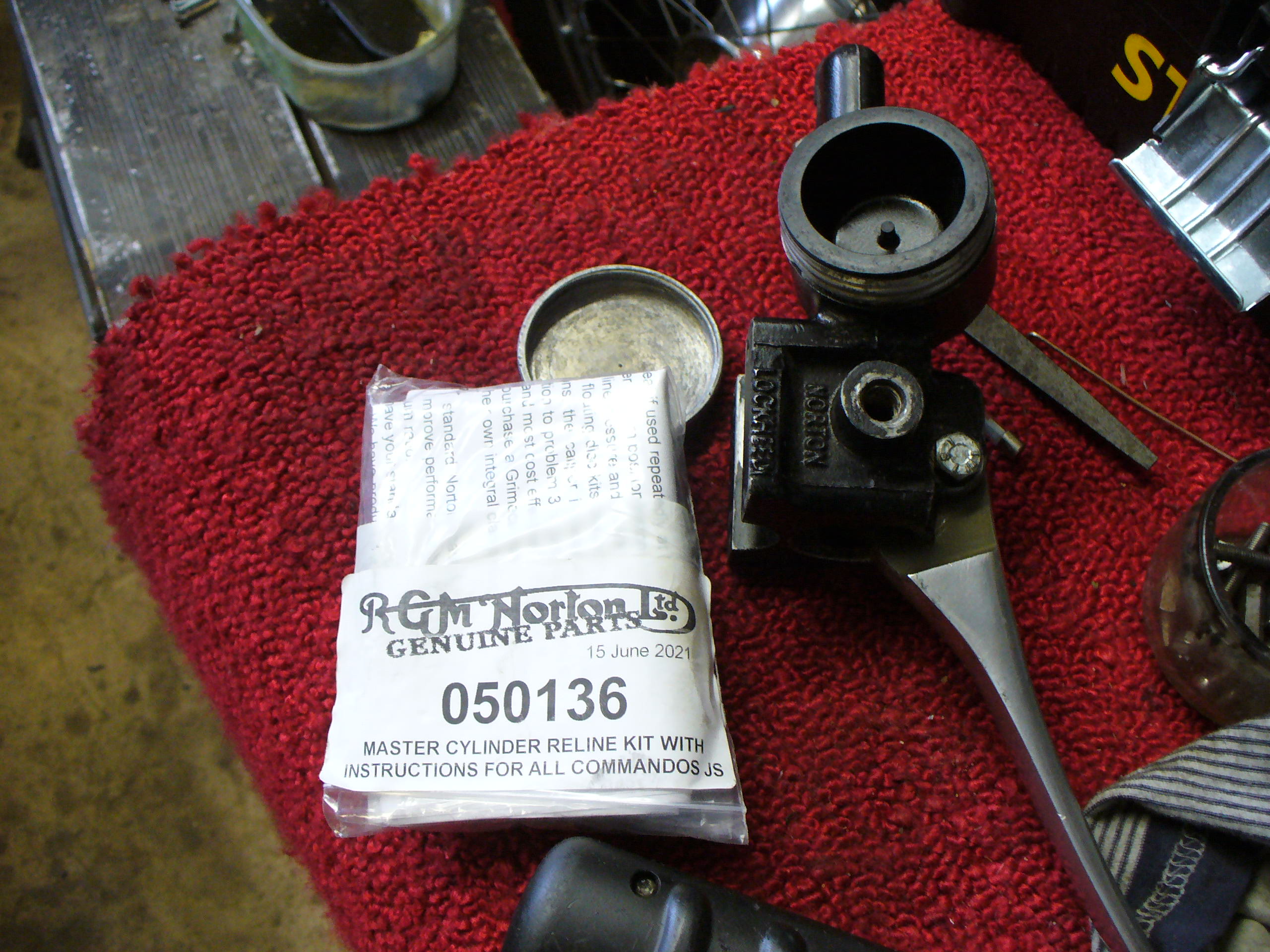

From your previous posts about the front brake did you find out what kind of master cylinder had been fitted? A small bore AN one or an original sleeved down master cylinder? This very much sounds like a sleeved down cylinder that has not been set up correctly. If it has been sleeved with the RGM kit, it is possible to adjust the piston pusher between the lever and the piston itself. You must be able to see a small squirt of brake fluid from the holes at the bottom of the reservoir when the brake lever is squeezed (reservoir cap and bellows seal removed) This proves that the reservoir holes are venting the brake system when the lever is at rest (brake not applied) This is essential to prevent exactly what is happening to your brake. Can you take a photo of the mastercylinder. The attached photo is of the sleeved master cylinder on my Mk3

This sounds to me like it is the problem I have, and it is definitely adjustable as the previous owner told me he had done it but it seems not correctly could someone give me a guide as to the procedure for adjusting this correctly the previous owner said he adjusted it because the lever was coming back to far before activating the brake and he I assume adjusted it as you would a cable brake regarding lever coming back towards handlebar to far, please forgive my ignorance but this is my first bike with hydraulics and if I knew where the brake should activate when cold I might be able to do it myself. and not knowing who the cylinder came from but that it is adjustable all seems to fall into place and him saying the lever was slack would probably be taken up when warmed up, but it being a modification I would appreciate a copy of the instructions for adjustment if anyone has a copy, anyway many thanks everyone for your help and if anyone can please indulge me a little longer with the procedure for adjustment on this mod thanks again Chris

It is obvious that the previous owner didn't know what he was doing and just gave you a load of flannel to cover up his dodgy efforts. He had compensated for NOT bleeding all the air out of the system by adjusting the piston pusher... You need to get an experienced motorbike mechanic, familiar with this kind of system, to have a look at it. I know this might not be the advice you wanted to hear but this is brakes we are talking about. A mistake or failure can have fatal consequences.
