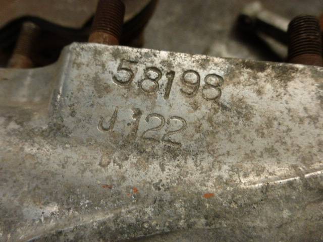

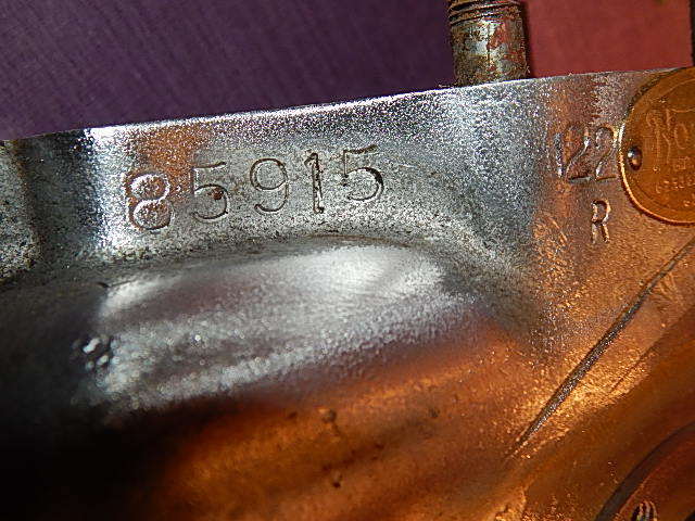

Greetings , may I know how do we read the chassis & engine number ?
Is it chassis 122 97161 engine 122 97161 or chassis 122 97161 engine 97161 122 ?
Bracebridge Model 88
Thanks and so the reading…
Thanks and so the reading sequence will be always as 122 97161 for both Engine&Frame number ?
The Bracebridge numbering for the Model 88 is as shown in the attachments. When Norton bike production moved to Plumstead in 1963 a slightly different method of numbering was used.
