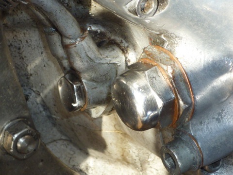

Hi,
I have a 1961 Dominator and the engine is stamped 14R which I think is 1961. However can someone tell me what the large dome nut(which in turn fits onto alarger flat nut) is next to the mainoil inlet/return connection on the crankcase? There is a spring under the dome nut so I believe it might be the oil pressure relief valve. However the model history here says that the valve is inside the cover from '58. Please see pic.I can't see this in my Haynes manual. Again thanks in advance. I'm on a steep learning curve.

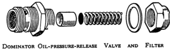

The Dome nut you have been looking at does indeed, underneath contain all the parts of the oil pressure release valve. If you can undo the bigger nut you will find all the working bits of this unit. Check out the attachment. This is quite an important part of the engine which does benefit from a clean every so often. But try not to lose the metal disc shims which sometimes fall out of the inside of the piston. These are used to tension the spring so that the piston operateswhen theoil pressure exceeds45 psi. Generally on a cold engine start-up.
As a rule, these components are quite robust and only cause a problem in engines that have been sitting around and not run for years. So a very corroded piston or bent/rusty spring might need changing. The good news here is that this item was common to almost all the Dominator and Commando range of engines for nearly 30 years, so are easy to find at auto-jumbles and also new replacement parts can still be obtained from norton sparesdealers.

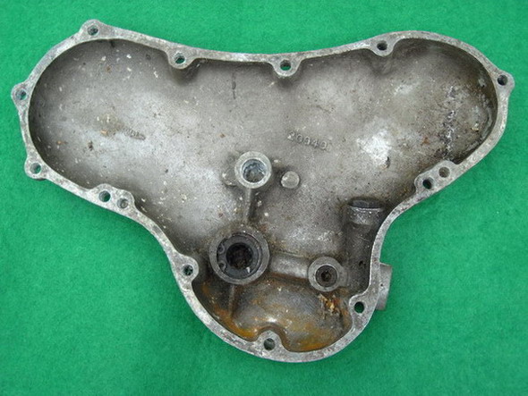

Just to add to that handy image of the pressure release valve diagram from Phil.I thought you might like to see what the timing cover for coil ignition Dommies looks like. They are 10-a-penny, with stacks still lying in peoples' sheds & lofts (but why dopeople always bruise the price up to £30+ on 'Satan's Swapshop'?) they're worth £5.I usually cut the coil ignition ones up for the cutaway tool, to use when removing/replacing the cam sprocket, or adjusting timing chains.Makes a great Christmas gift and stops your mates tearing their intermediate shafts out of their crankcases. Leave yours as it is.

If the bike has a rev counter fitted (cafÃ? racer) it may explain the reason for the change in cover type, I donât believe there is an internal pressure release valve cover with Tacho drive boss!
Engineering wise itâs not nice as the cover and case are a pair.
Ron C.

There were/are quite a few varieties of timing cover, from the range of Norton Twins,that will fit on a model 99. Plus, there were almost just as many versions that could mount a Rev Counter Drive. The factory produced several types withacastboss and a choice ofeither verticalor inclined mounting holes. Several 'Go Faster Goodies' shops also produced and sold their own versions of the cover. Some with a cast boss, others with a built-up welded boss and the cheapo with just a ground away mounting area.
The proper factory produced covers, with the boss for mounting the Rev Counter drive, will all have had a pressure release valve fitted as standard unless someone has done a bodge job. They are opposite ends of the cover so there is no reason to mess around with the release valve.
