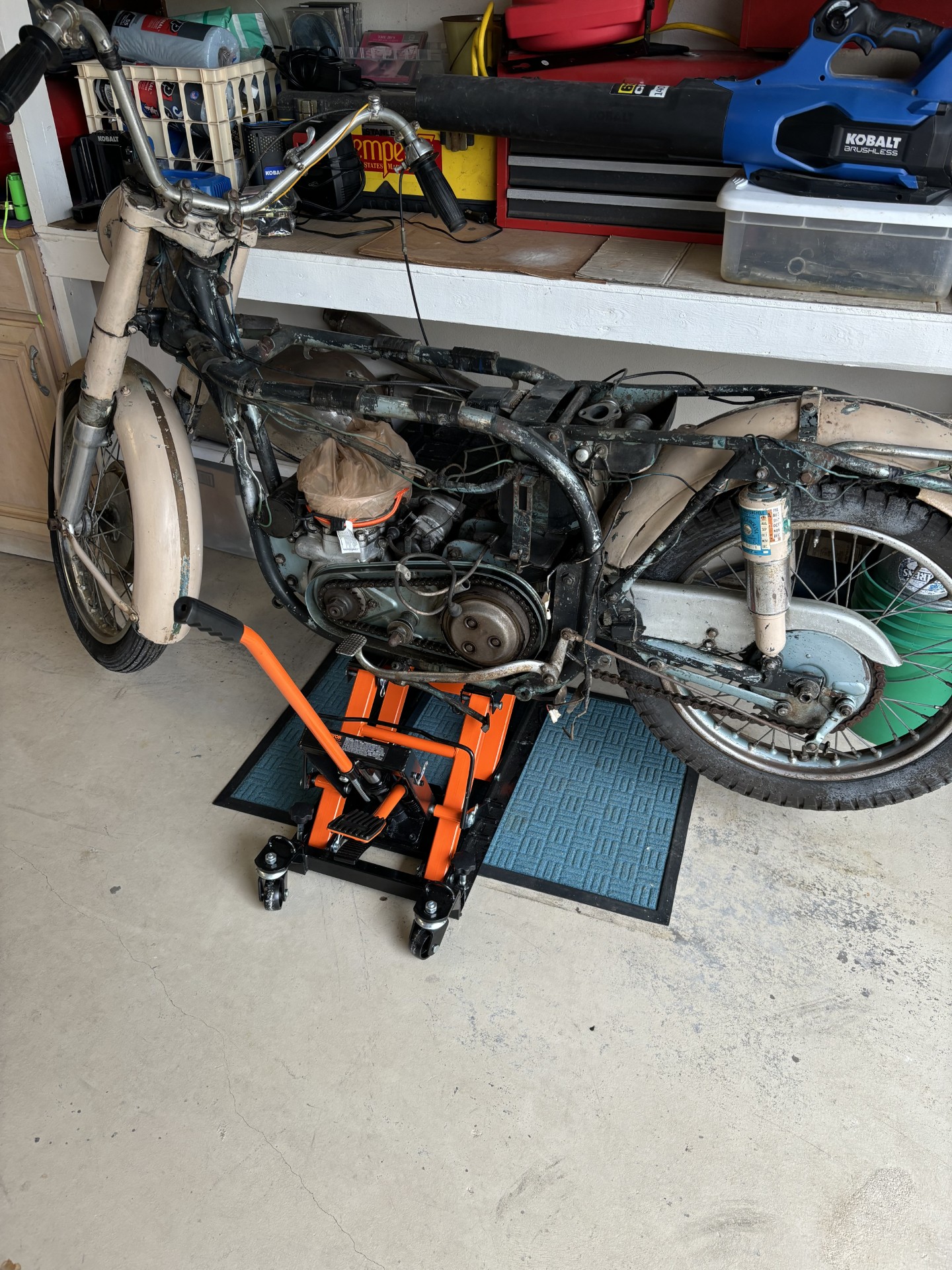

Hi all, I'm Jeff and I live in Florida, USA.  I am beginning the rebuild for my Grandfather's 54 Model 7, Dominator 88.  I am not a mechanic, but I can usually figure things out with some help.  Some background, Granddad bought her new in 54.  It has 22,200 miles on the odometer.  In the early 70's, he took the cylinder head off, valves and springs.  From what I can see, I believe he wanted to do a valve job.  He passed away shortly thereafter.  My father retained all of the parts and kept it inside for the next 50 yrs.

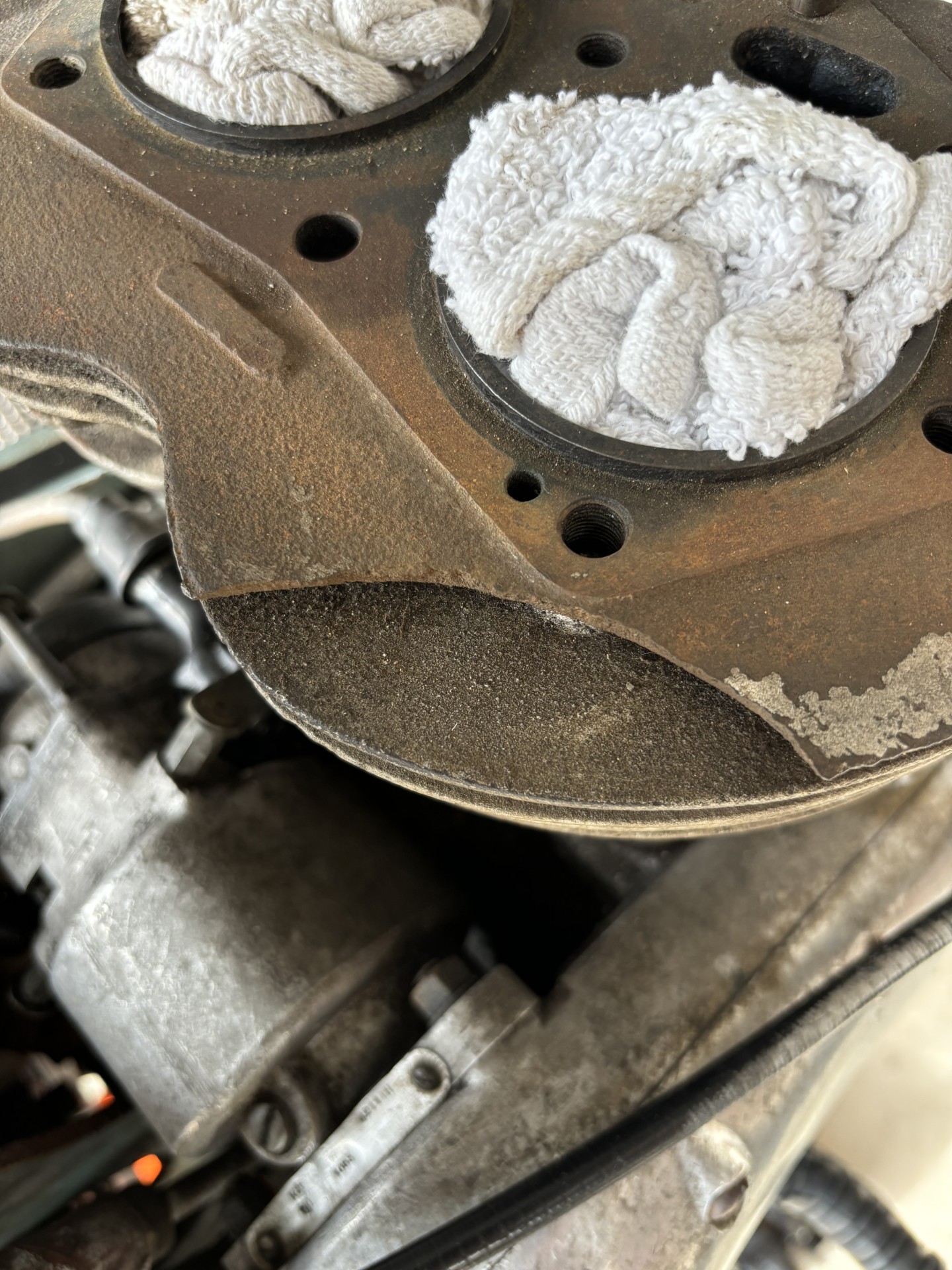

Some quick questions, I have the Floyd Klymer workshop manual and  the original Maintenance Manual for the bike.  Is there another renovation publication out there that is more step my step with pictures? Or a video library? I look at the bike and literally do not know where to begin given its condition.  I believe the first thing I should do is verify that the engine is sound and will fire.  Then verify the transmission.  It does need a new wiring harness as well, in addition to many other components.  Any advice would be appreciated.  The picture of the missing metal on top of the cylinder is a concern for me.  Would that be heat related?

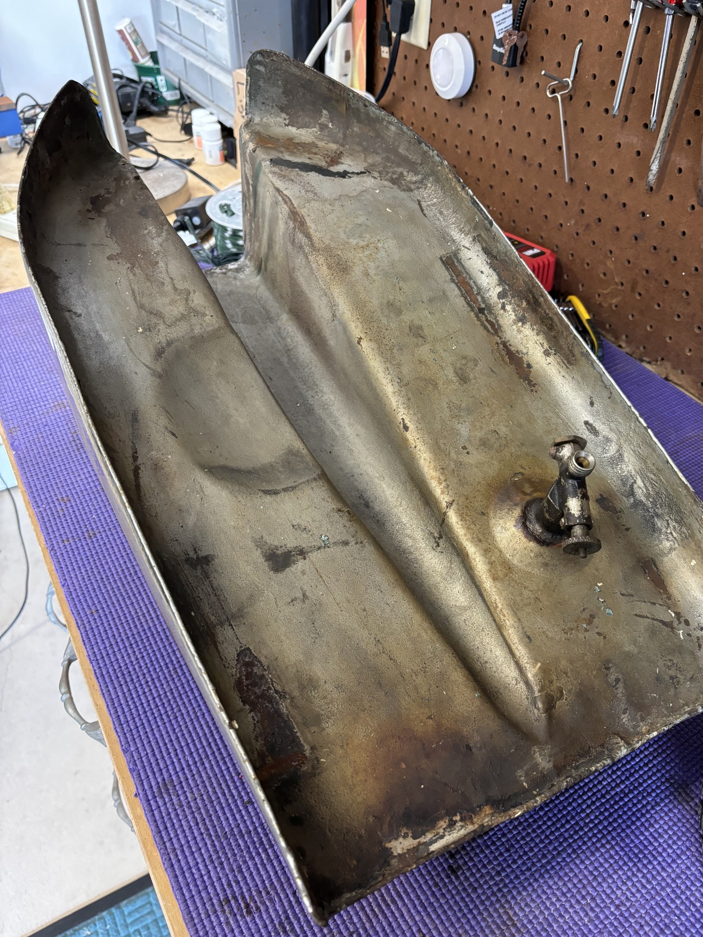

I took the gas tank off and noticed that it was not bolted on the frame.  I noticed on the tank itself that there were no bolt holes or fittings to secure it to the frame vs what the manuals show.  Am I missing something?

Nice model there; an early bolt up frame featherbed 500. One of the original capacity engine in the best frame of the period. Tank is held on my a metal strap down the centre of the tank fixed just under the headstock and an adjustable fixing in front of the tool tray under the seat. Some one took care to preserve the motor but what goes on with the frames out there!
collect the parts you have and lay them out against the parts lists.
Plenty of information on this model in the tab on top of page labeled LIBRARY, on line offline or order a hard copy of the Heavy Twins Compendium. There are videos, some on line showing the restoration of general components. Restoration of Classic Motorcycles titles are available on Amazon but they are pretty generic guides.
My approach would be to get it built up as it should be. So you have an idea of what may be missing. If there is confidence in it starting, do so. Magneto spark can be tested,charging verified and gear selection confirmed while you are static.  Then you have a baseline to work from.
You will get plenty of advise here, many different ways to approach this.  Your skill level, facilities, time and finance all play a role.
As previous a very nice machine to start on, in my view one of the best of the breed.
photograph everything from all angles and get a scrap book going, online or in a binder.

With respect to the broken fin on top of the cylinder barrel that is not a critical issue, it could be repaired by a competent welder or left as is and not effect the bikes performance.

The broken fin on the barrel could be from someone trying to lever the head off or any type of impact , a good engineer will weld a donor fin on and shape to nearly invisible mend. Spare decent barrels are hens teeth . If bore is not too bad a hone and new rings may do.

I believe you are right regarding the break.  Looks like it was trying to be pried off when it happened.  I appreciate the information.

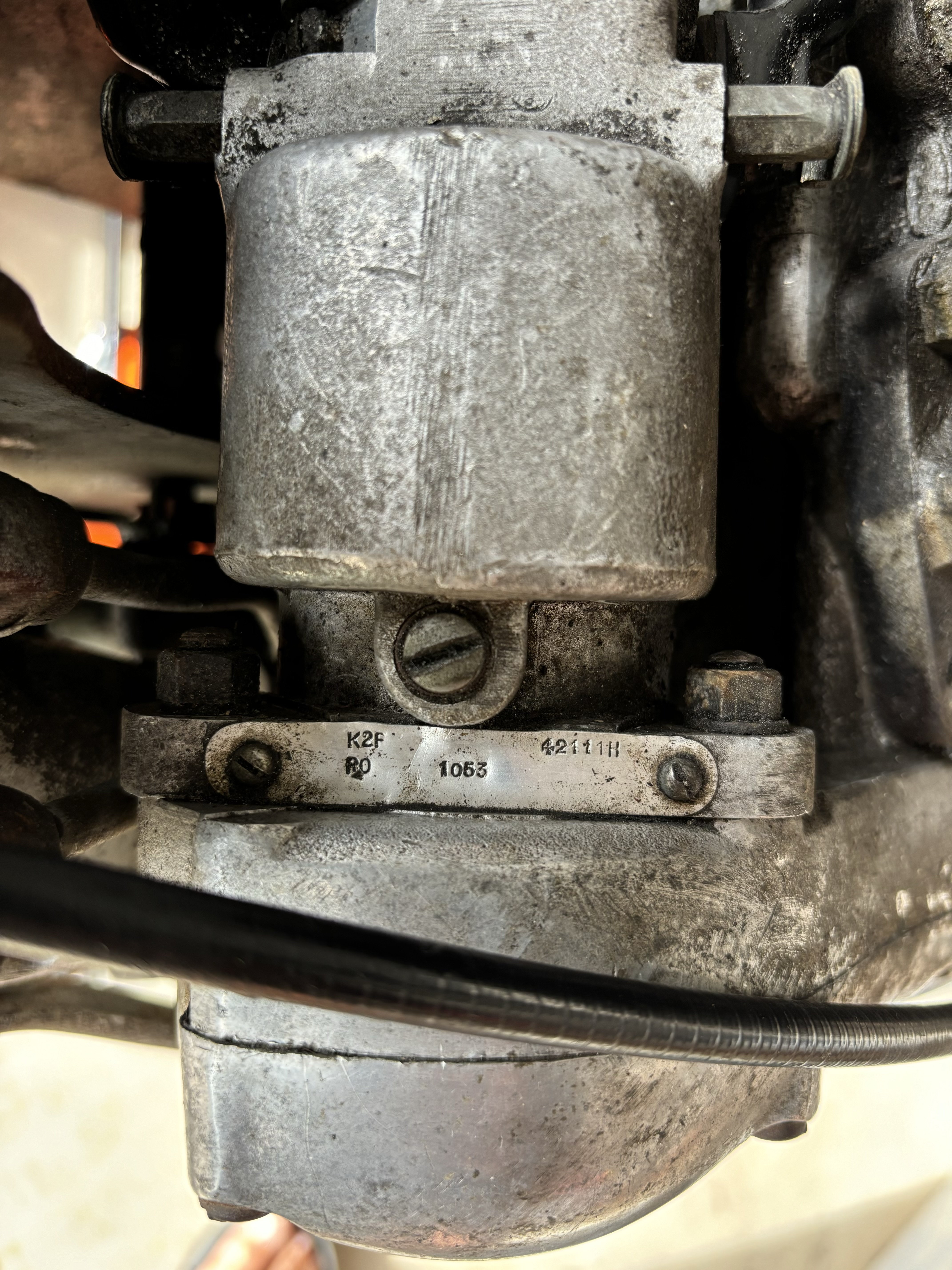

You seem to have a very unmolested machine with the correct carburettor still sitting in the tool tray and the correct date on the magneto (October 1953).  The bike should have matching engine and frame numbers. (Should be J for 1954 manufacture, 122 for the model and numbered between 57,000-60,000)

These bikes were a very well made item , I would not be surprised if you were able to clean, change oils, battery , and tyres , lubricate , clean out carb and tank unstick clutch and ride away . It's what  I would do to find out what is the plan going forward while I gather parts and information. Throw nothing away and if at all possible avoid new parts as they may be inferior to what you have .

Clean every thing you have, parts that 'appear' past their best throw in a box for later reference ie do NOT through anything away. Even throw the wiring loom in the box (although it is past its usefulness) but take a picture of where it sits on/in the frame. The tank is held down with a steel strap which sits in a rubber 'belt' (new one). Magneto probably needs rebuild (not cheap). dynamo needs rebuild and refitting but do not concern your self about charging, regulator or battery at this point, get parts clean-painted rebuilt, get magneto giving spark, get engine running, carburation fettling, oil circulating, even a short 'gallop' down the road. THEN worry about rewiring, lights, battery, and charging.
