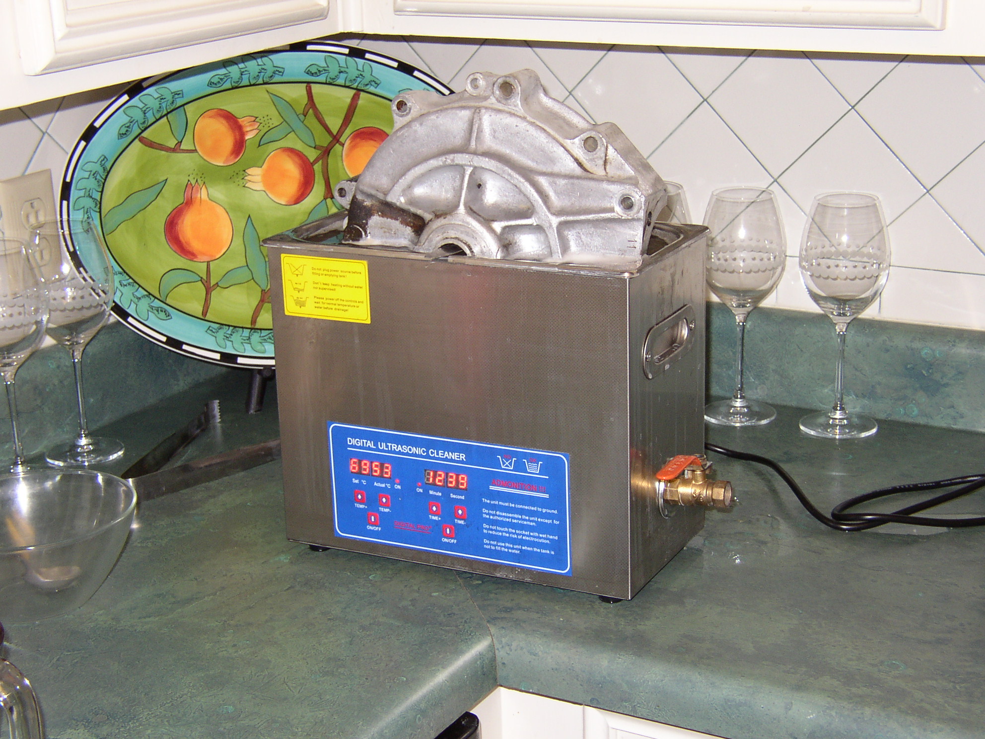

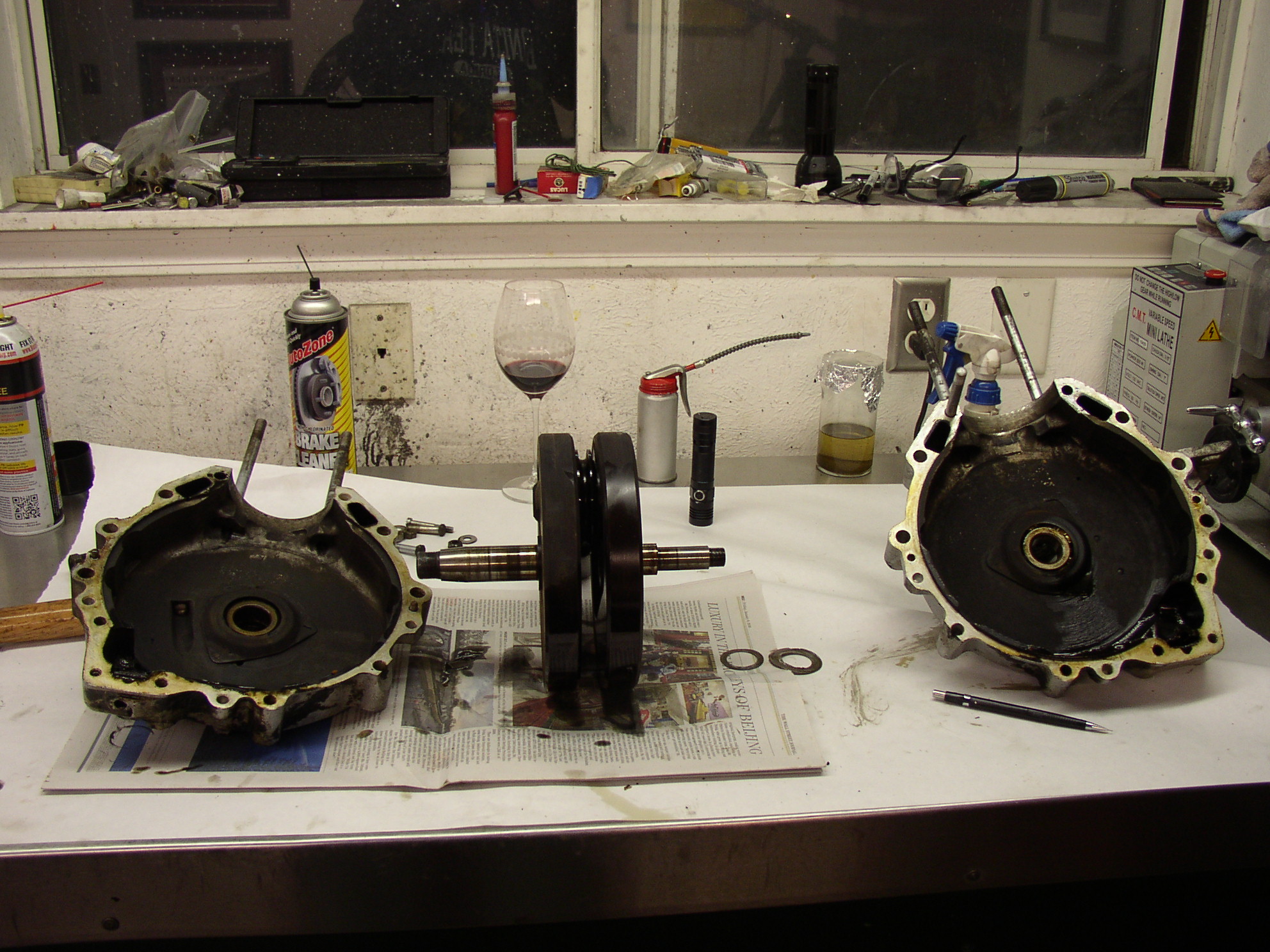

Arne - I'd hoped to avoid splitting the crankcases, but decided to go ahead having dismantled everything else. It was a good call, since the brass cage in the timing side main bearing had fragmented.
I found that an ultrasonic cleaner did a good job removing baked-on deposits, without damaging the original silver paint on the crankcases.
