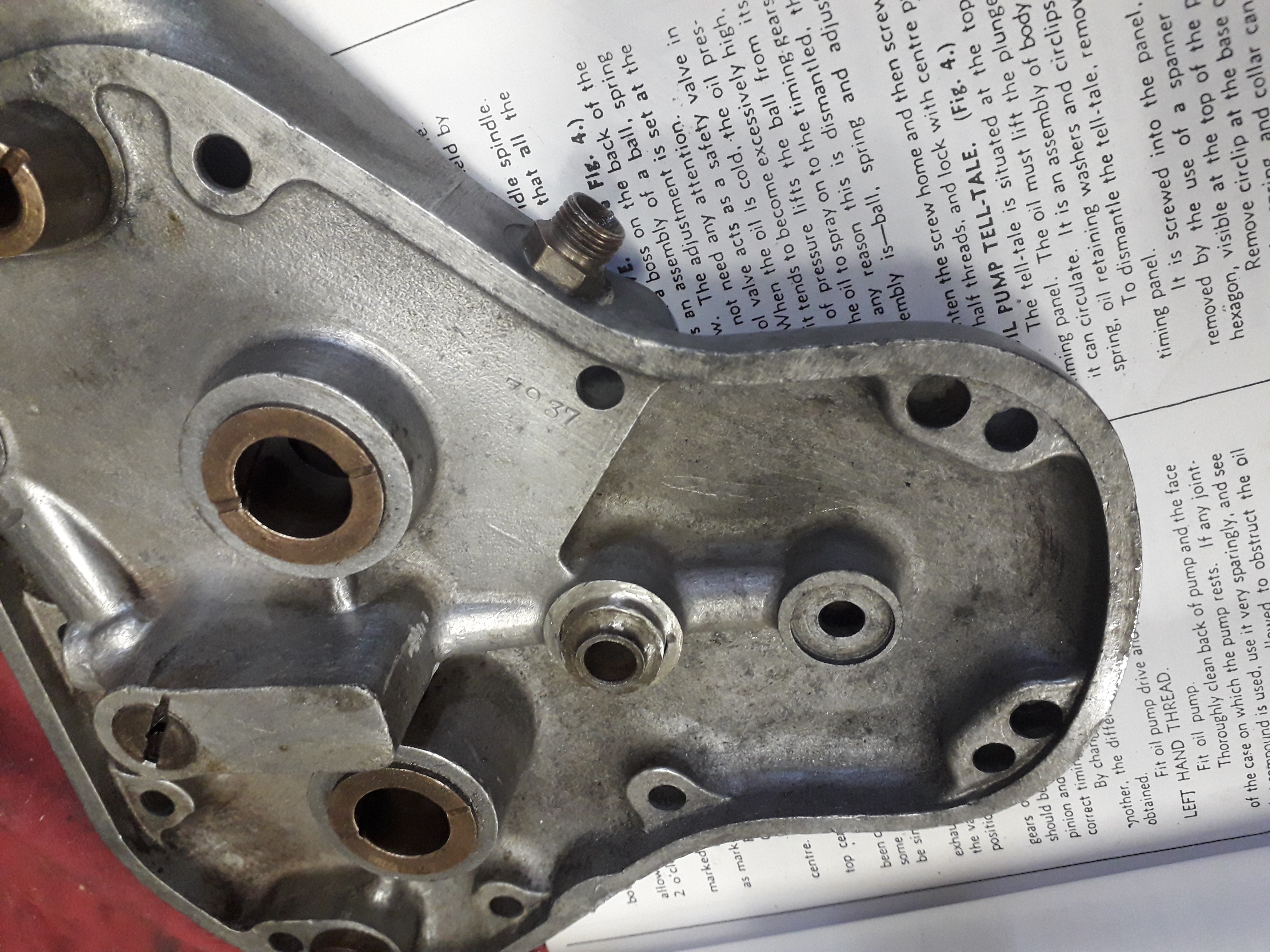

Seems from Ian Richtsteig's posting I have the wrong timing cover, as mine has a fixed (steel) chamfered oil jet that fits quite nicely inside the oil pump worm gear but has no spring-loaded element.
See attached picture of my panel.

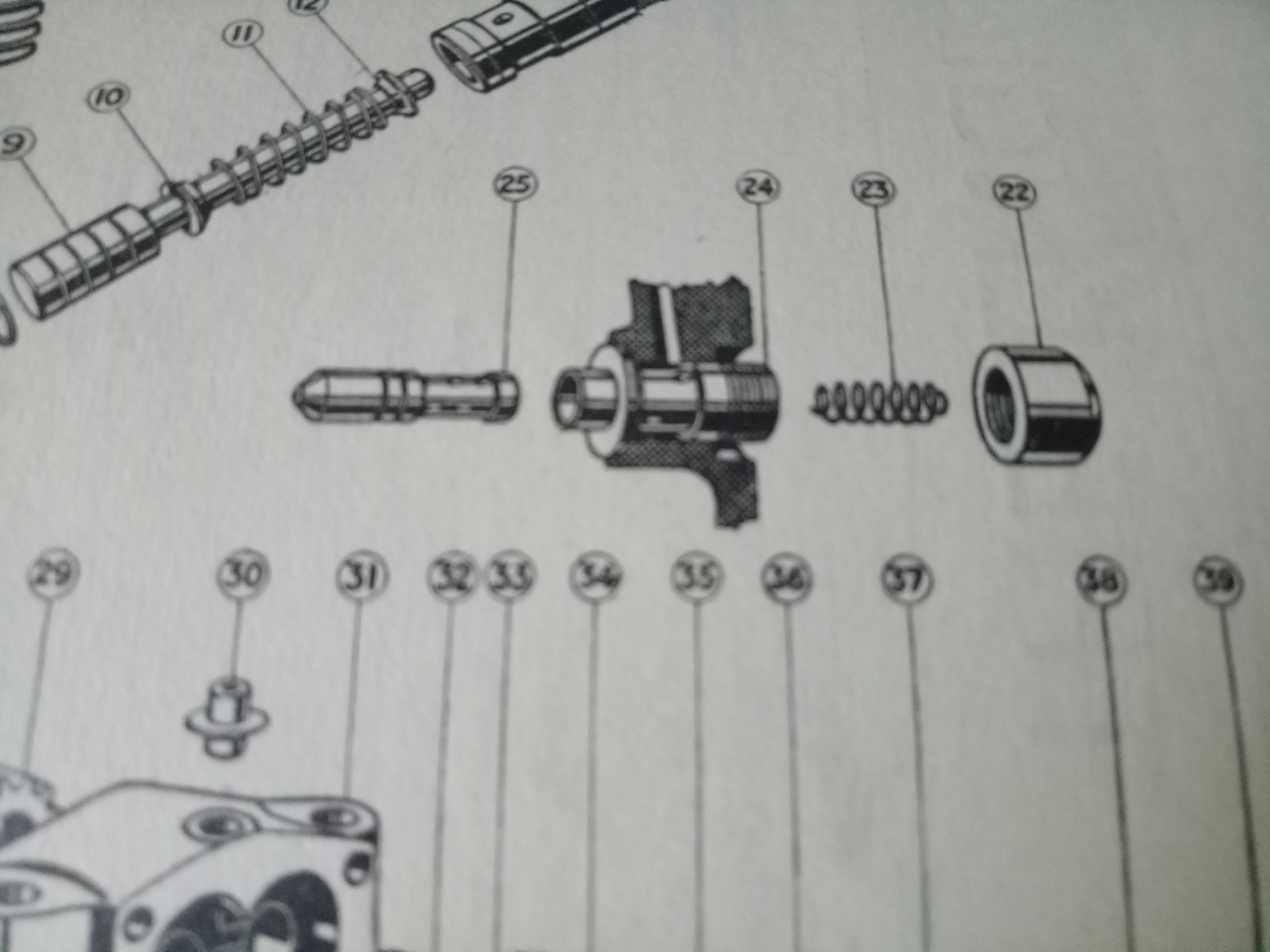

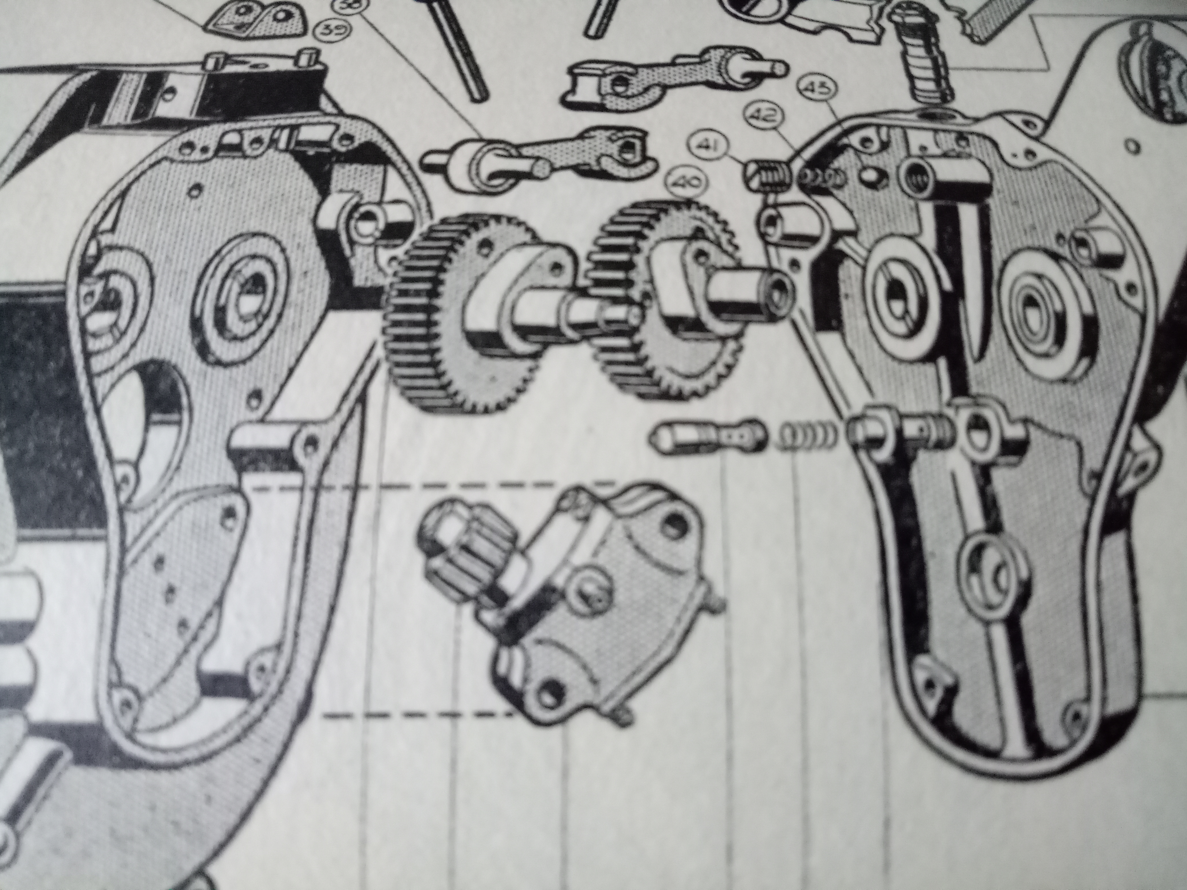

Hi again Russ,
Just to clarify what your set up should be I have attached a couple of photos from my prewar 16H manual.
The second photo shows the steel jet holder fitting through the timing cover and the brass oil feed quill and spring.
You should be able to unscrew the round cover (part no 22) on the outside of the timing cover to replace the quill and spring.

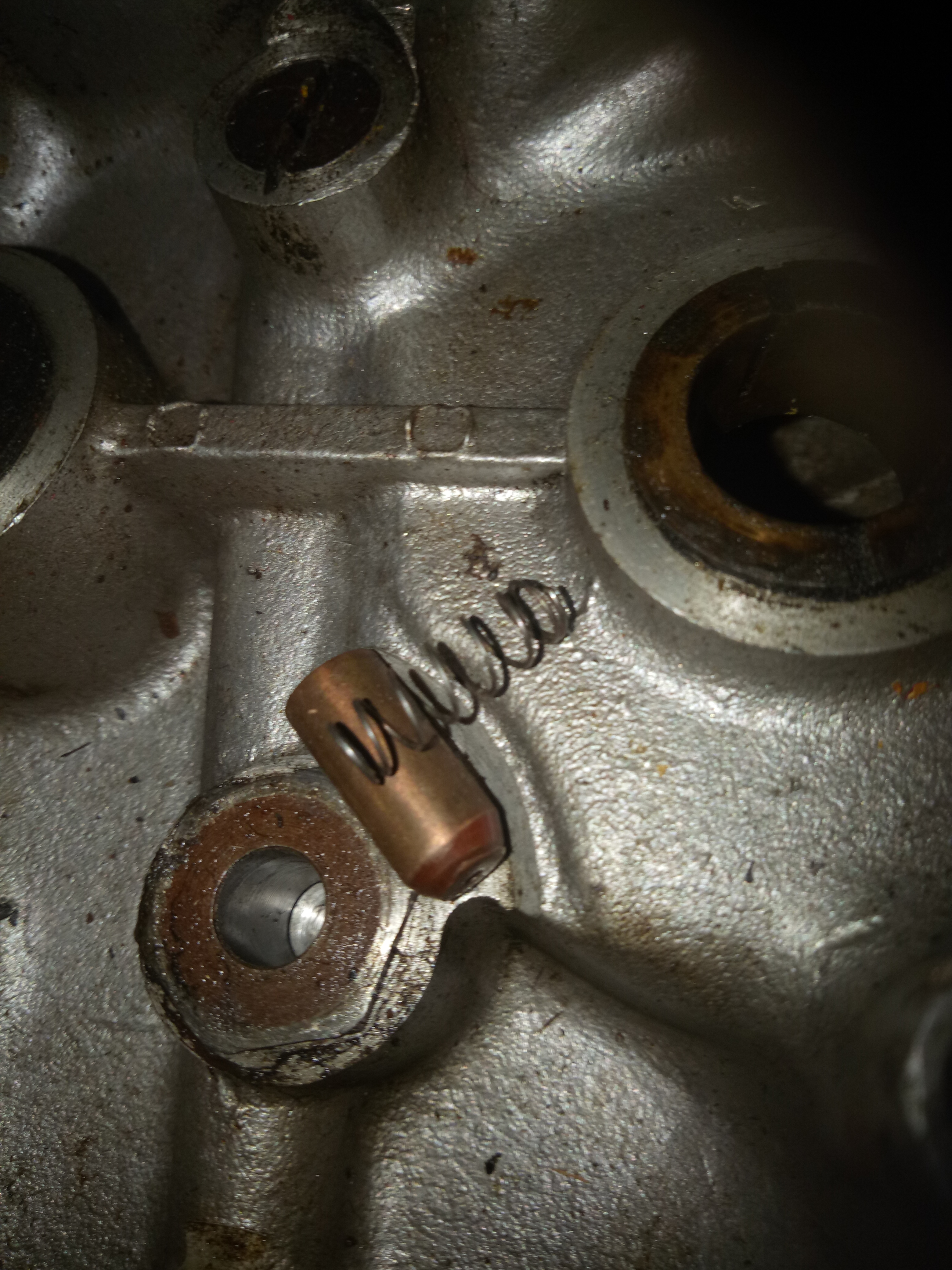

Thanks for the really useful info, Ian.  Makes perfect sense (although there's going to be a fair bit of wear with this set up).
Alas my timing cover doesn't have any external access to the oil feed (no 'part 22') so I'm guessing it's a later part.
I don't want to give up on this cover though, as the fits everywhere are really good (inside and out) and it's only this one issue now, so I'll try to unscrew the steel feed jet on the inside and see if that gives me any clues.
