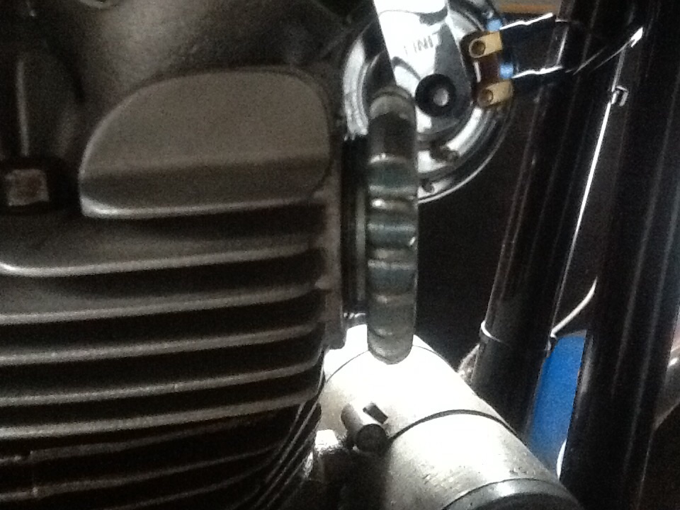

Having purchased a pair of bright shiny exhaust roses to go with my bright shiny pipes, I set about instalation but even after wringing up the roses the joint was not tight, i.e. the pipe was not gripped. The depth of the exhaust port and the length of the threaded portion of the rose are identical so the run out, or lead, on the two components must be in conflict. Can I simply turn off the threads from the front of the rose or is making a gas tight joint more complicated than that?

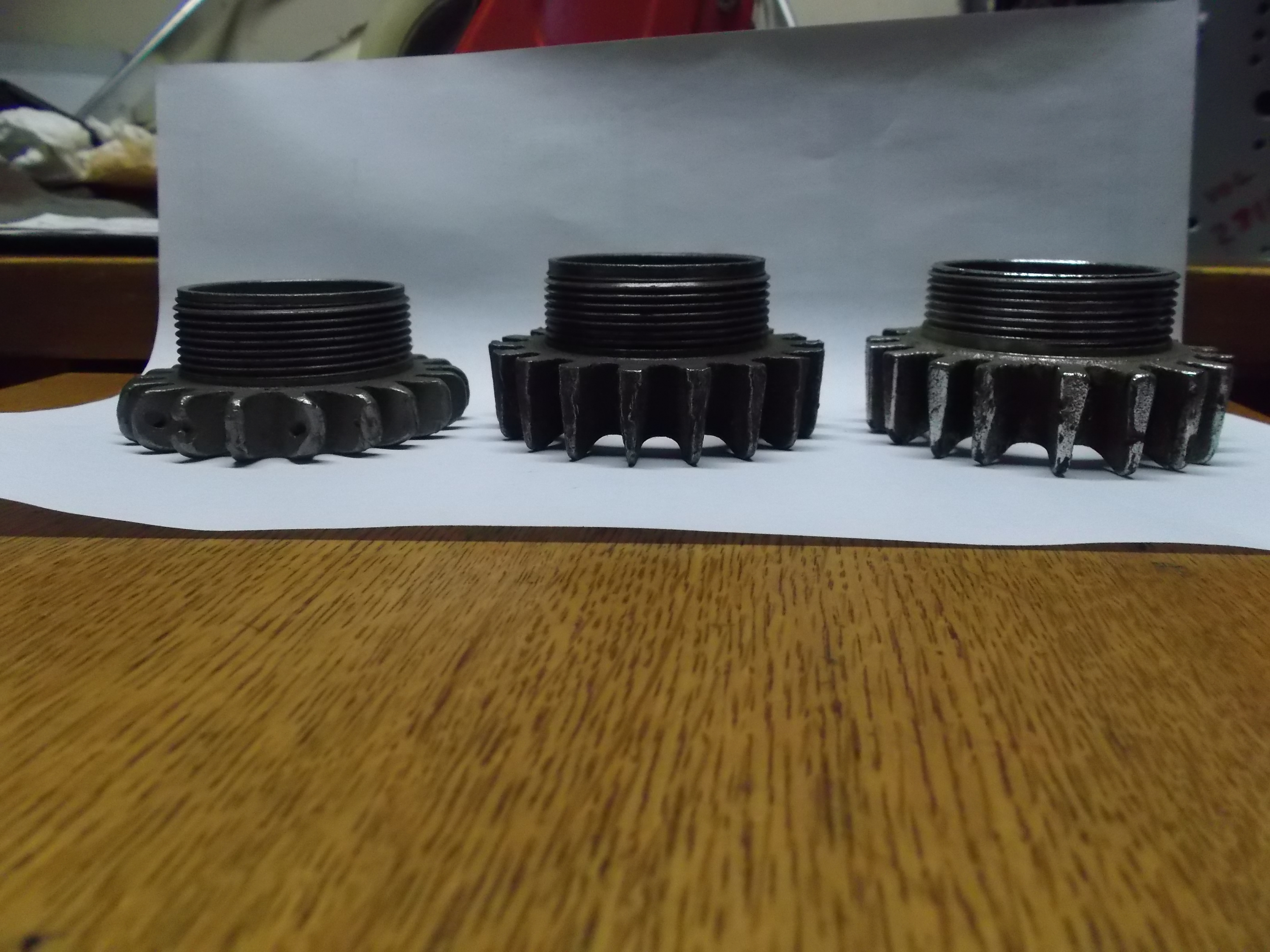

There are 3 original variants of NHT roses. All NHT ports are 3/4" deep. The first 2 are for full depth flange mount pipes that also use, as mentioned, the port bottom gasket. These first 2 type roses have a clear cut 1/8" before the threads start and may be why your roses don't seat fully in a bare port. Are they aftermarket? The pix does not show whether chamfer or a clear cut lead in. The first rose is for 1949 thru 1972. The second is almost identical except for the big fins for 1973 750 only. The 850 ports are 3/4" deep but the 850 style pipes fitting dictated the changed later 3rd big fin rose depth dimension. Prior port thread damage from loose pipes can contribute to roses not seating fully unless threads are chased with a clean up tap..

Wow! How do you guys accumulate such information.? Really appreciate your valuable input David. I got the new roses from Norvil as the seemed to be the most original and definitely the best price. There is no clear cut lead in and I have it in mind that this is where the problem lies, with the leading threads on the rose conflicting with the trailing run out in the port thread. In all honesty I was looking for a confidence booster as I was basing my thought process on apprenticeship skills from 60 odd years ago.

Only had 5 Nortons. There are roses with different thread lengths. The short stroke Manx and maybe some other singles have a longer thread rose. Guess due to the large head finning that makes it hard to tighten. Had to grind off a large portion of a standard tool to make it possible to to tighten the rose without breaking any fin.
Forums Heavy Twins !!!
left t 1949-72
center 73-750 big fin
right 850 shorter thread & big fin

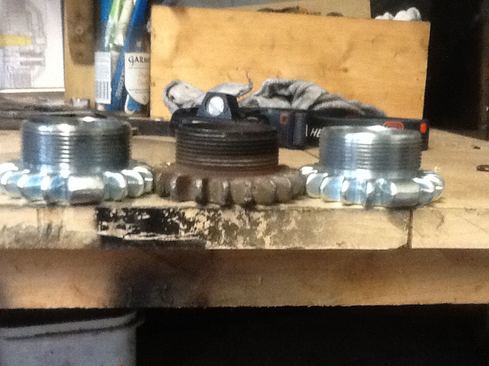

The final 1/8" or thereabouts of the outside diameter of your new ones looks to be bigger than the old one. Maybe the tip is jamming before they are screwed fully home. That seems to be the only possible reason why they won't go far enough in to squeeze the swaged flanges on the pipes against the copper washers. The threads are parallel not tapered, so the only other possibility is if the thread pitches are a bit different. Can you put the new and old ones side by side facing opposite each other to see if the threads interlock and match each other? If so, you could turn a little off the outside end edges so they will enter further. The inner edges bear against the pipe flanges so you can safely lose some off the outsides.
The issue might be an incorrectly toleranced part or something to do with an earlier thread repair.

Thank you all for your highly valued comments. You have given me the confidence to adapt my new roses to suit the head. I will turn off the leading threads of the nuts which should eliminate the current interference
