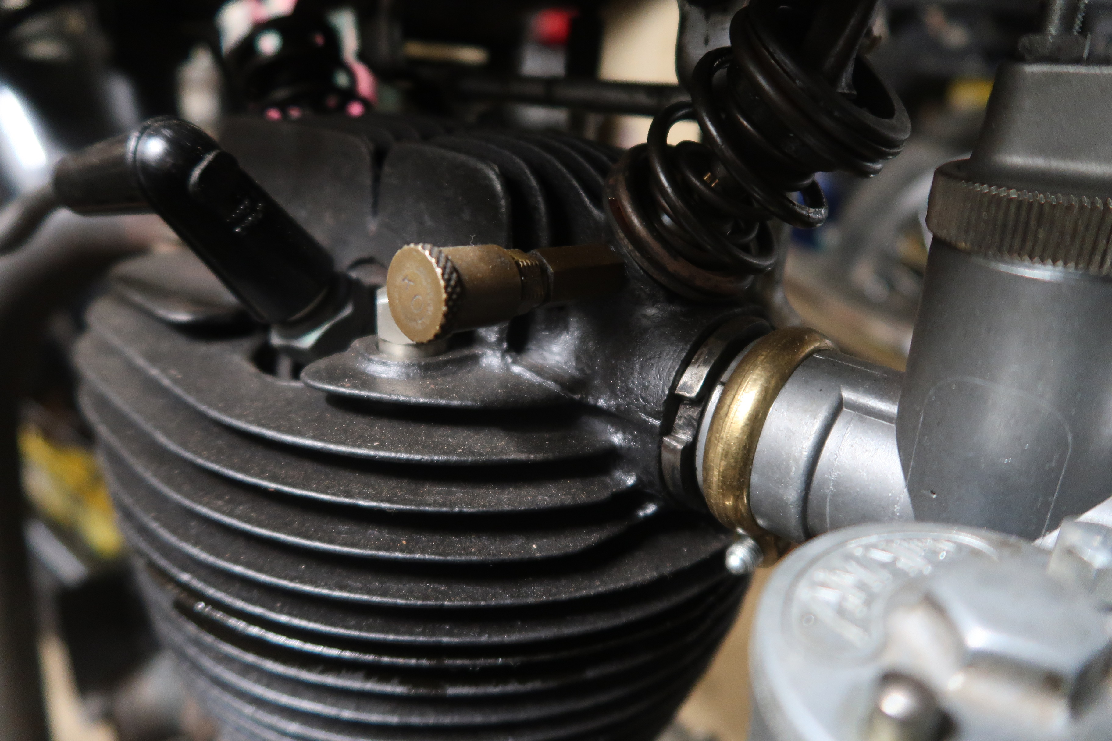

Rodge,
My 1927 Model 18 has open valve springs but my inlet valve has a brass lubrication device. The body is filled with grease and the cap is screwed on bit by bit to push a little bit of grease through the drilling in the valve guide. See attached photo.
It was already on the bike when I bought it, so I do not know how common this is.
I've wondered whether the exhaust guide should also have one of these, but maybe the heat from the exhaust valve would melt the grease.
