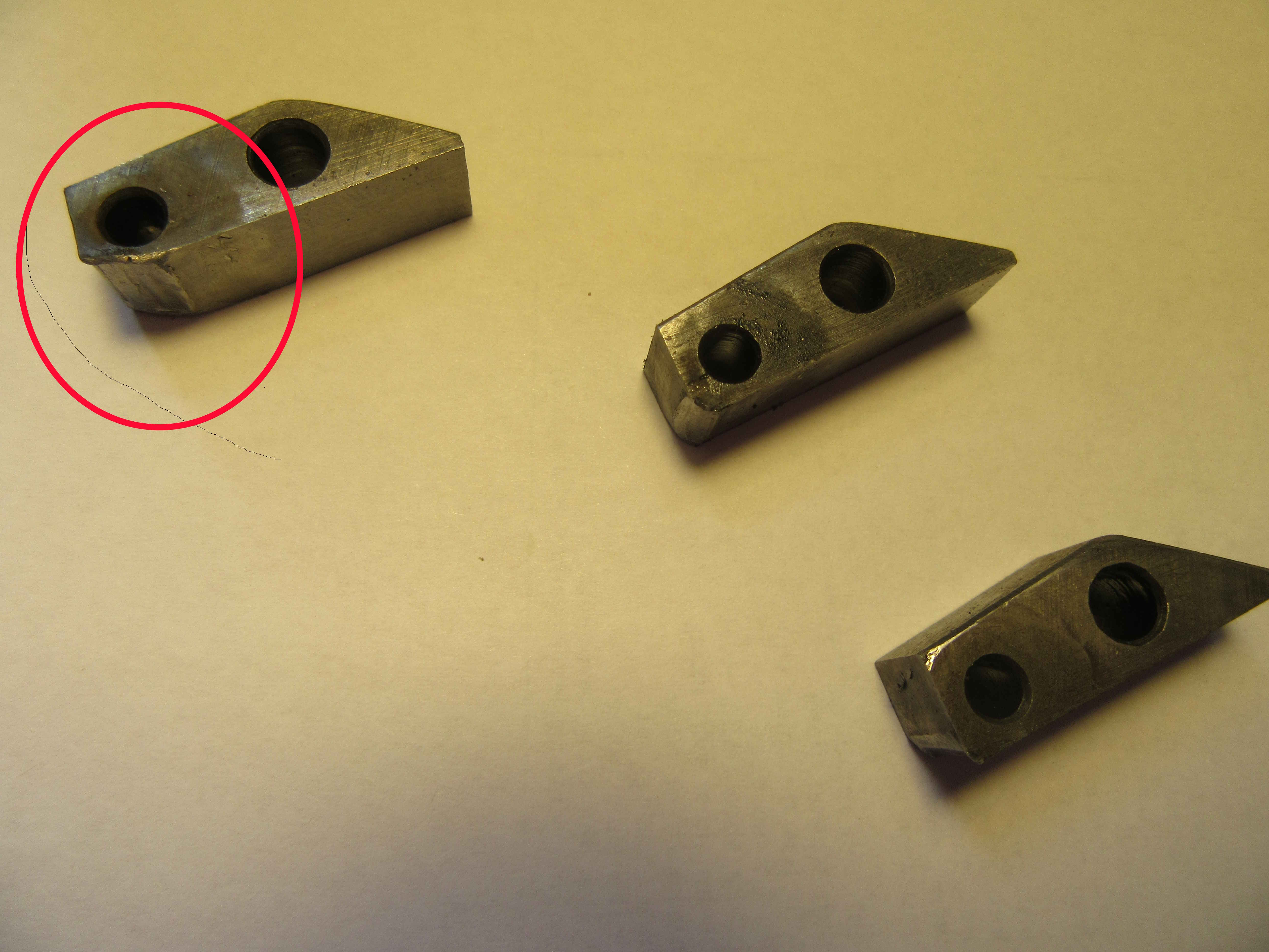

... but the drive has failed again. The silver steel pin has bent! So I have now tried 4mm drill shank and silver steel. I've asked on a model engineering forum and there are 2 suggestions: hardened and ground dowel pins and piano wire. I'm quite attracted by the former as they arrive in exactly the right size.
I've also noticed that there seems to be a huge amount of play on the pawl pivot pins. I was hoping not to have to do anything with them but this can't be helping anything. Plus the pawls are now showing significant wear so I'll try the weld repair suggested by either Al or Andy.
I have to say it's getting me down, and the hot humid weather doesn't help.

I've now dismantled the whole thing, grinding the peened part of the pivot pins and driving them out. One of the pawls (actually not the one with the offending drive pin) is very badly worn. It makes me wonder whether that pawl has not been engaging but has been riding on the ratchet.
The pivot pins are worn giving a lot of play. Interestingly, even the unworn portions are significantly smaller diameter than the pivot holes in the pawls. This seems to indicate that a certain amount of "slop" is built in although I can't see why that would be a good thing as amongst other things it would let the pawls cant over. Maybe it's to allow them to find their own position?. The holes in the pawls allow a 5mm drill shaft to fit easily. Logic says that I should open up the holes in the main component to 5mm but I have been wrong many times with this bike.
I plan to have the pawls built up with weld - hopefully I can find someone locally to do this - then file back to the correct profile.
What is ironic is that I had it starting and running well earlier in the year but seem to be going backwards...... But I'm sure I will get there eventually.

On the AO Services website, in section Data Sheets, there is a very good engineering drawing of the Electra starter pawl.
it would be worth you checking that your pawls have the correct holes, in the correct places. Also, at the first sign of damaged driving faces, it is very tempting to grind the leading face back to improve things.
Your pawls may already have been in the hands of a grinder/improver, so are short.
From the drawing on AO website you could get a set made in a tough modern material. Perhaps John C could advise.

I have a copy of the drawing and will check dimensions. I've already looked at the hole sizes which correspond to those in the drawing. I've just tried drawing a file across a pawl and it appears they are at least case hardened although when I try on the worn portion the file marks it. There are no apparent wear marks on the ratchet attached to the crankshaft.
I'm still puzzled that the large hole in the pawls (for the pivot pin) is so much larger than the pin size - 0.202" as opposed to 0.184" (on an unworn section). Seems a huge discrepancy and can only add to misalignments.

Have all the (silver steel?) pins bent? or just 1 or 2?
Is the ratchet worn? I would suggest correcting any wear/damage in that first.
Filing the "welded" pawls will not be satisfactory, the pawls will be very accurately made components, as near identical as possible so each pawl carries an equal share of the load. Its a pity the drawing on the AO site doesn't have more tolerances to reflect the accuracy needed. This is why I suggest carefully checking the ratchet and correcting any wear/damage first.
Looking at the photo of the pawls, they are worn out, new ones are needed. Gauge plate should be okay. Again, great care needed in making, they must be all the same, exactly.
Don't mess about with the soft end of a drill or silver steel for the pivots, use high tensile metric bolts as a source of "strong" steel, cheap and readily available.
This all sounds a bit of a faff. I think it the best way forward to get the reliability wanted.
I would advocate using the plain shank of a 4mm Allen bolt instead of the drill shank as they can be brittle and therefore easily snapped.
