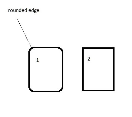

Hello,
when i fitted some new fork bushes to my roadholders they use to jam /stick and not a smooth operation . i tried everything . i eventually changed the new bushes for another set and tried the forks they worked ok. on compareing the two sets of bushes it seemed if the bottom bush hasnt got a radius where indicated on number one in the photo. then they tend to stick like a stiction effect. number two type in the photo were the ones with sticky operation.
Barry
