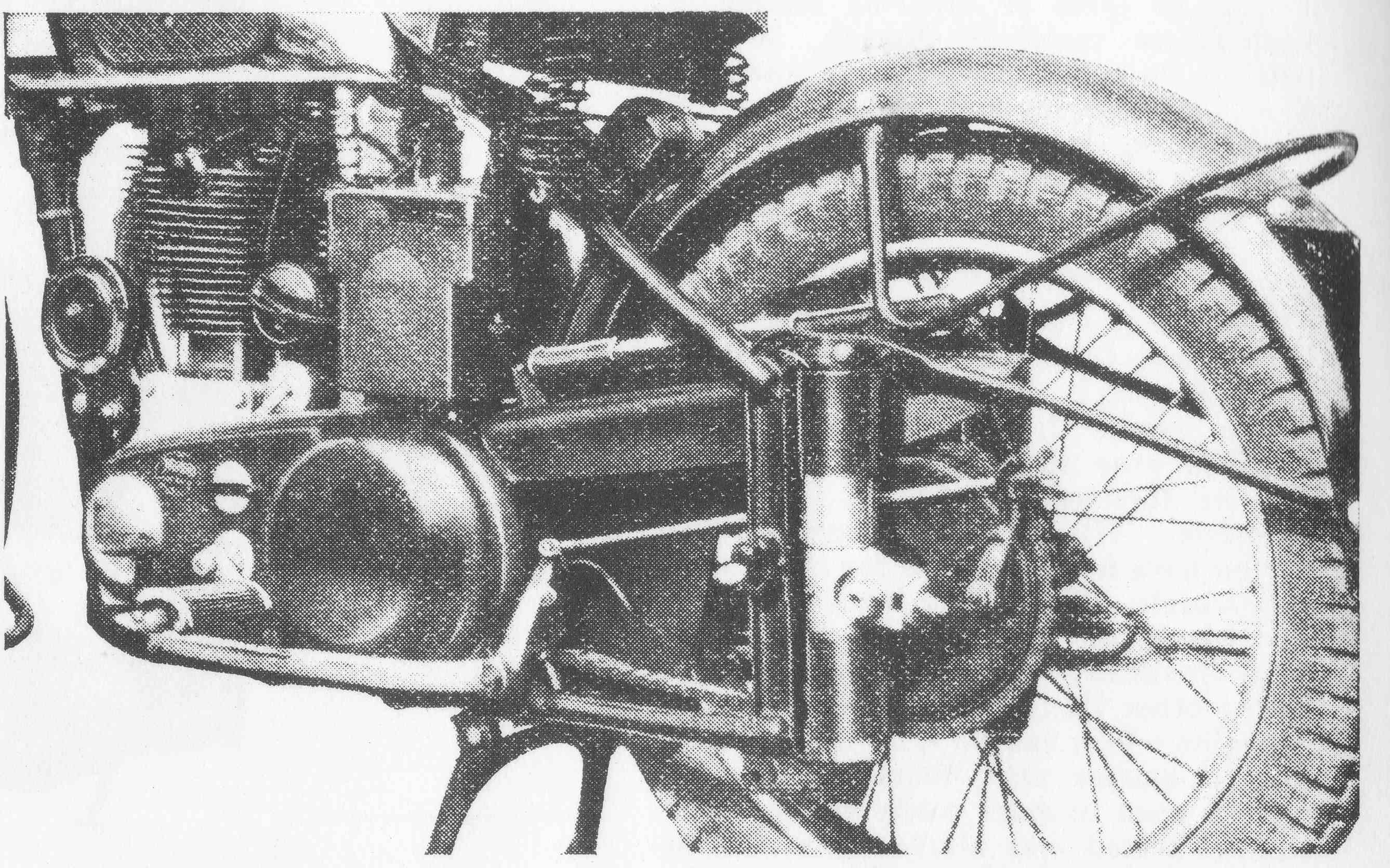

The reason I asked is that…
The reason I asked is that all the photos I can find show what appear to be plating:
The first is from a 1946 road test (very poor quality) but again seem to be chromed.
The second is in Bacon's book and appears to be a contemporary photo of a 1948 16H:
As I understand it, the shortage in the early 1950s was of nickel (which is necessary as a base for chrome plating) due to the Korean war.

The road test photo would…
The road test photo would not have been a show bike and though indistinct does seem to show the hangers (and certainly the brake pedal) as being plated.
In fact the book I took that from (which is a reprint of various Norton tests from the Blue and Green Uns) has other photos of early 50s models all of which look as though they have plated hangers although the reproduction leaves much to be desired!
They include a 1946 ES2, 1947 Model 30 Inter, and a 1949 ES2. One at least of the NMM's early ES2s has plating; another has painted parts although of course this means little.
But it is interesting that no-one (including myself) remembers anything other than painted parts although most of us probably didn't see the bikes when they were new....
