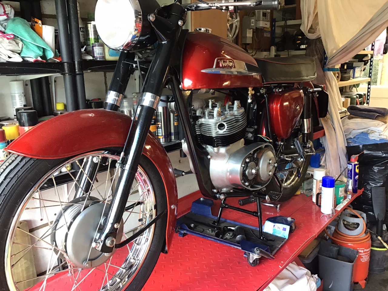

In my parts book (64 on Jubilee & Navigator) it lists a “Spray Baffle” part # 23652. Part doesn’t seem to exist anywhere nor pictures of it. Anyone got an idea what it is (& for) please - also, is it for the later Jubilee? Picture of mine as it is right now - not far to go (hopefully)!
Thanks - Bruce

I know you cannot be sure with colour over computers, but the bike looks neat in that colour, on my monitor it looks an orangey red is that a fair description?
John
I think that’s Candy Apple…
I think that’s Candy Apple red, a red metallic over a yellow/gold base coat.
Dan

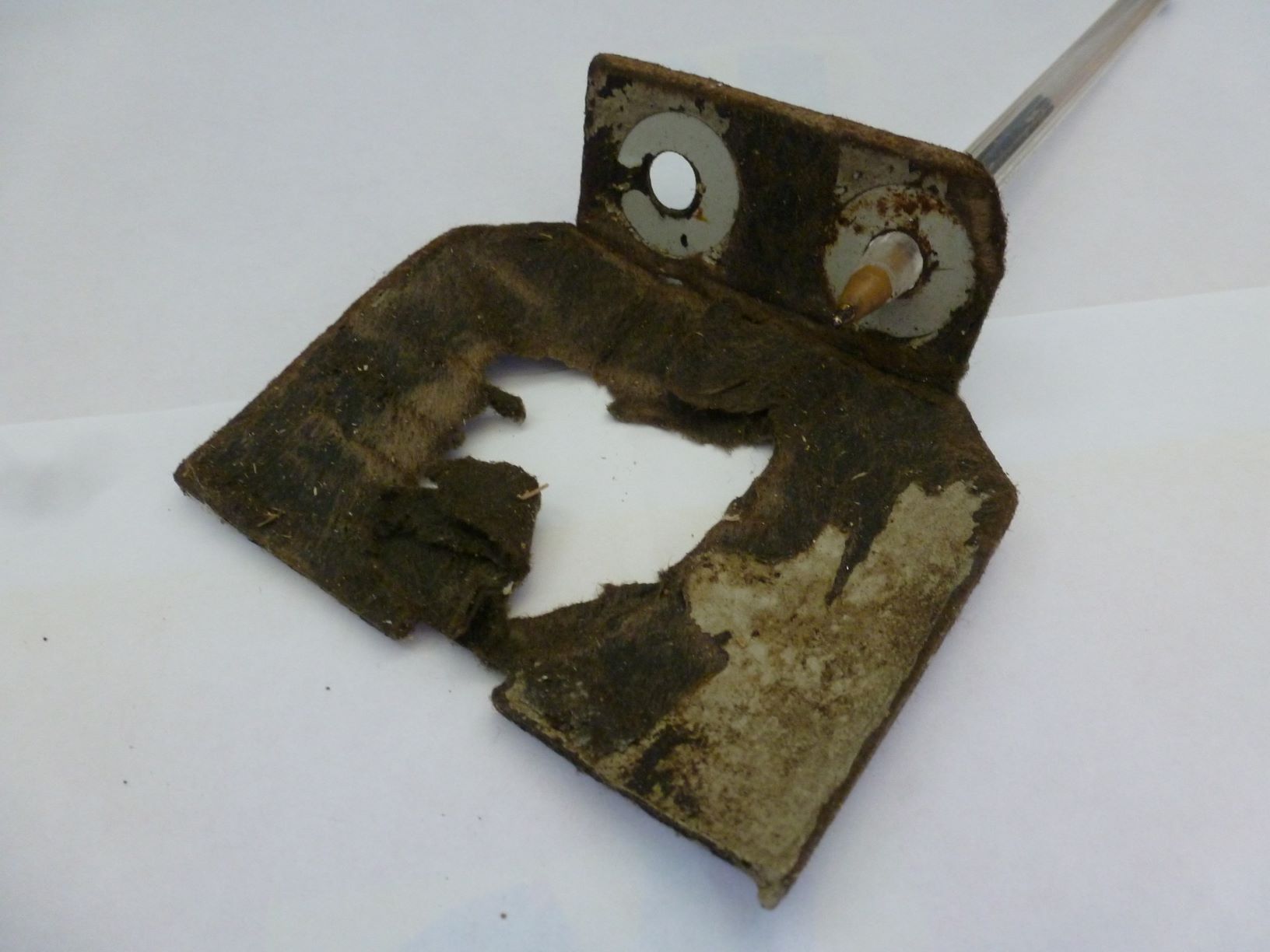

Lightweight spray baffle
Good morning Bruce,
This item is made from something that looks like old suitcase material. Waterproof cardboard.
It has two mounting holes and is fixed on the lower two holes of the centre frame member by the same bolts that secure the centre stand stop.
It goes on the forward face of the central frame member, the inner face opposite the centre stand stop, and is shaped so that it prevents spray from the road going up the central channel and towards the carb belmouth.
You could make something out of aluminium which would be just as satisfactory, and would not compress under the bolt load. The original spray baffle always compressed over time resulting in loose bolts and a stand stop that moved upward when struck by the stand.
Hope this helps.

That’s really really great info Peter & Robert - thank you. Now where did I put my old suitcase in the loft! I assume it was flexible but not too much (until wet that is).
Yes, colour is Candy Apple Red over a Yellow Gold basecoat. Couldn’t find (at the time) an original colour to match but saw this at great motorcycle takeover in Gt Yarmouth last year on a car. Rather liked it so went with it for the Jubilee - haven’t really seen it in sunlight yet though!
Bruce

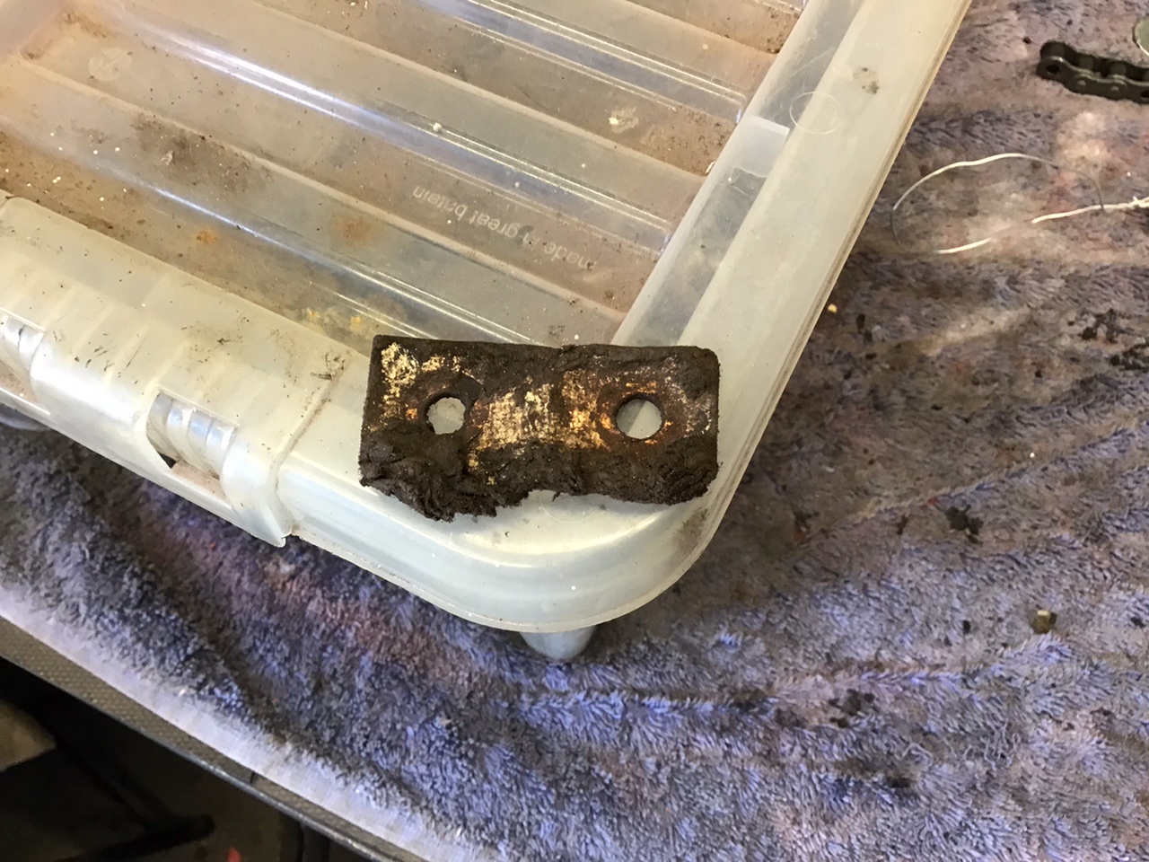

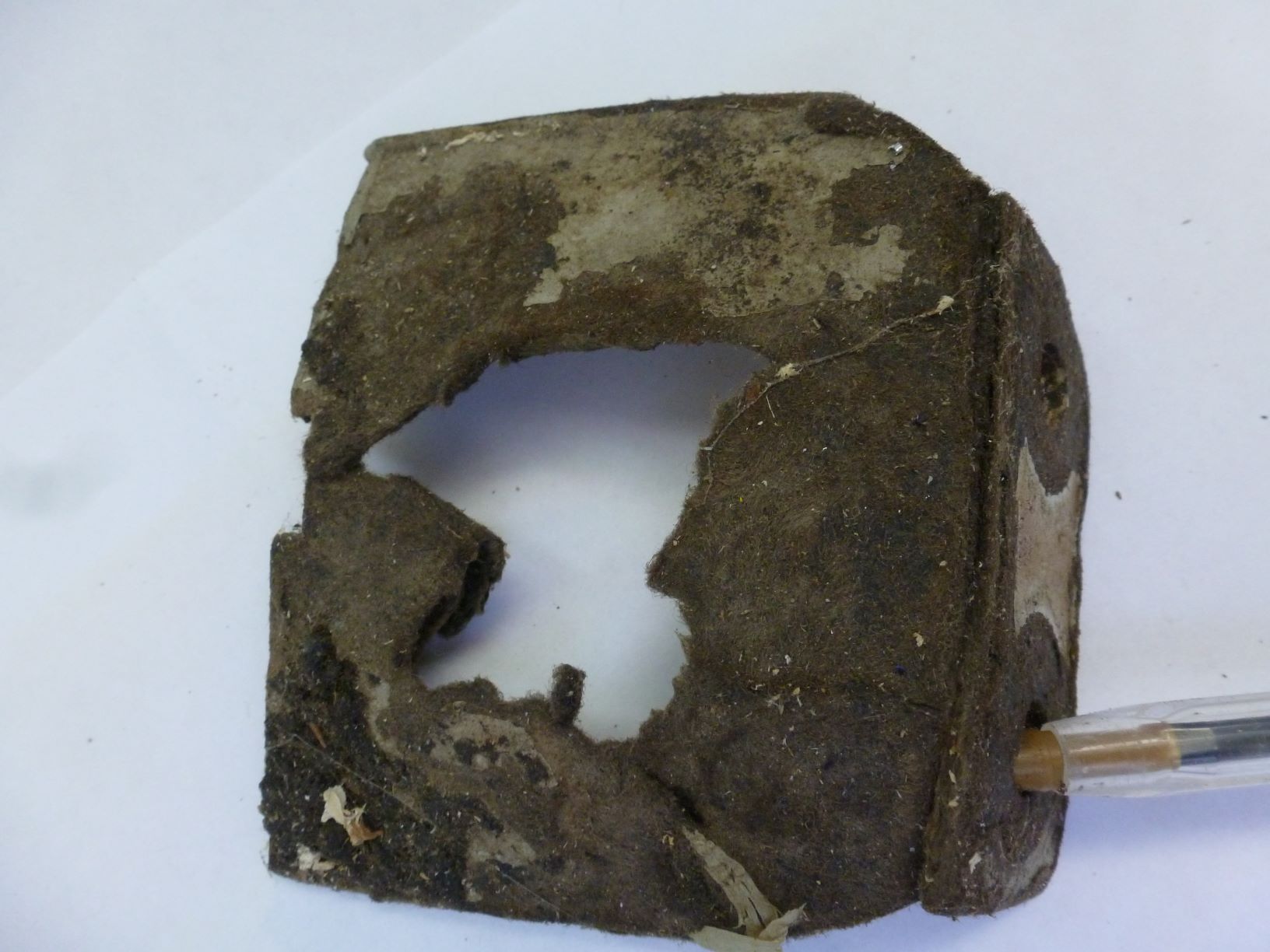

Spray baffle 23652
Hi Bruce,
Try to imagine it without the hole. Interesting that it was painted ivory to match the frame.
What attention to detail by AMC!!
Ah Ha - that would explain…
Ah Ha - that would explain what this “bit” was originally. Cheers Peter!

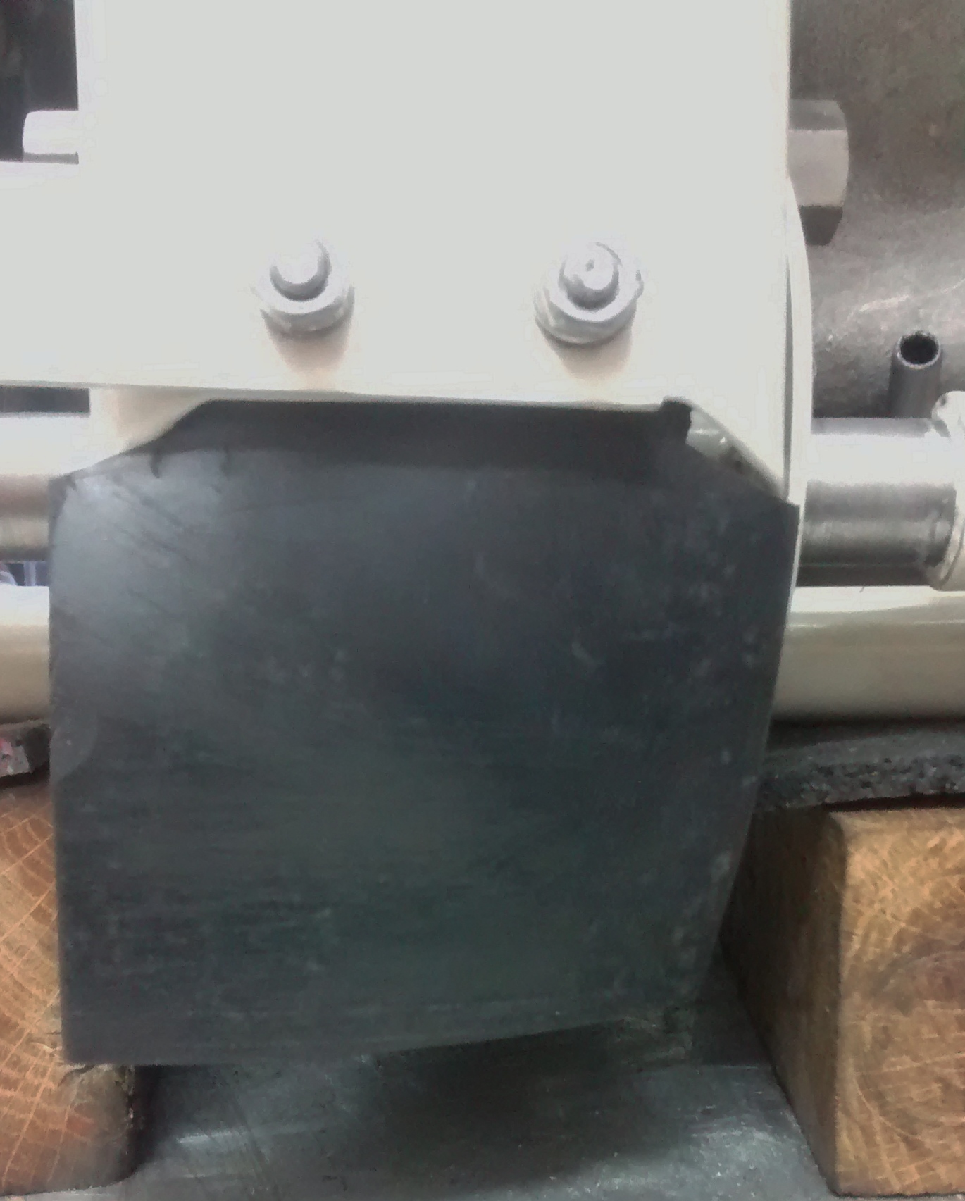

Homemade spray baffle
This is my attempt to recreate the spray baffle. A piece of rubber fixed with the main stand stop.
Thanks all - this is what I…
Thanks all - this is what I’ve gone with. 5mm ABS sheet, heated & bent to shape. I reckon it’ll do the right job!
