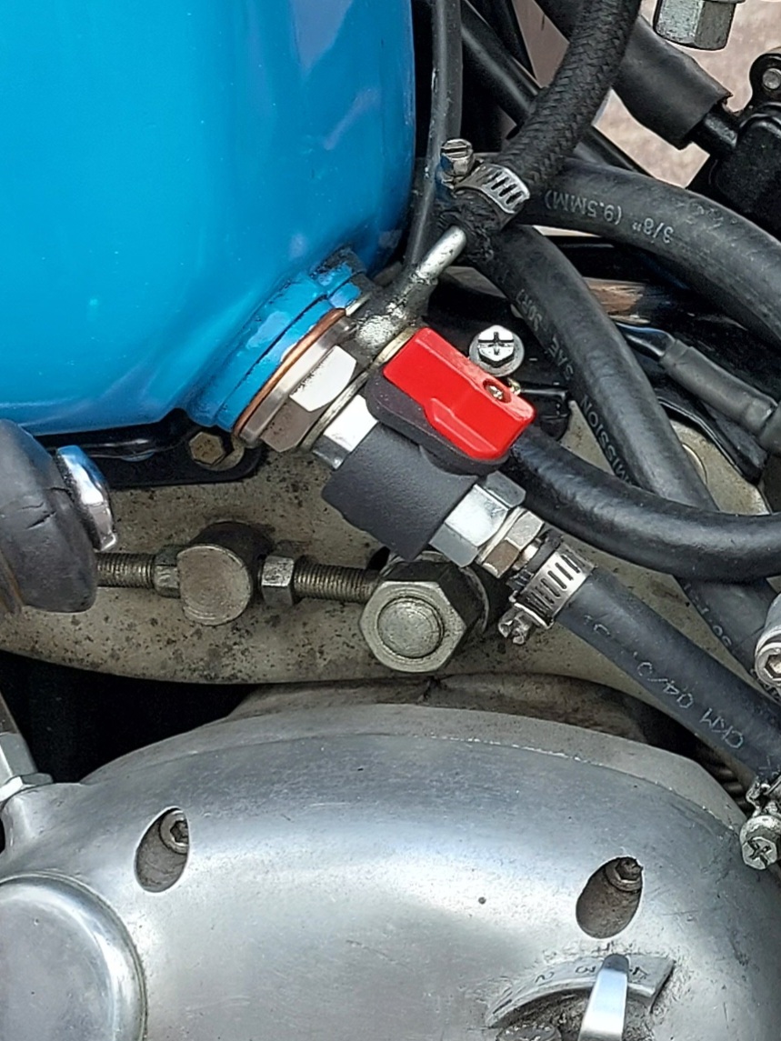

I first fitted a 'Velocette' type valve in the feed line (RGM) and it worked fine, but I always had the nagging doubt of 'what if' it stuck shut and the consequences of that.
Following the lead from others, I now have a tap in the feed line with an ignition cut out on it - switch not open = no starting. When testing it, the power supply is cut should the tap close even by a tiny amount, so I'm happy I'm not going to wreck the engine by a compromised oil supply. The tap I have was supplied by Kingpin Components, but there are other suppliers.
Bottom line is that I find myself using the bike more often because I no longer need to mess about simply to start it.

I've also fitted a tap with a cut out switch to my mercury. Also fitted to my commando.
Loads better than mucking about with draining oil etc and it saves on wearing out any threaded parts.
win win.
