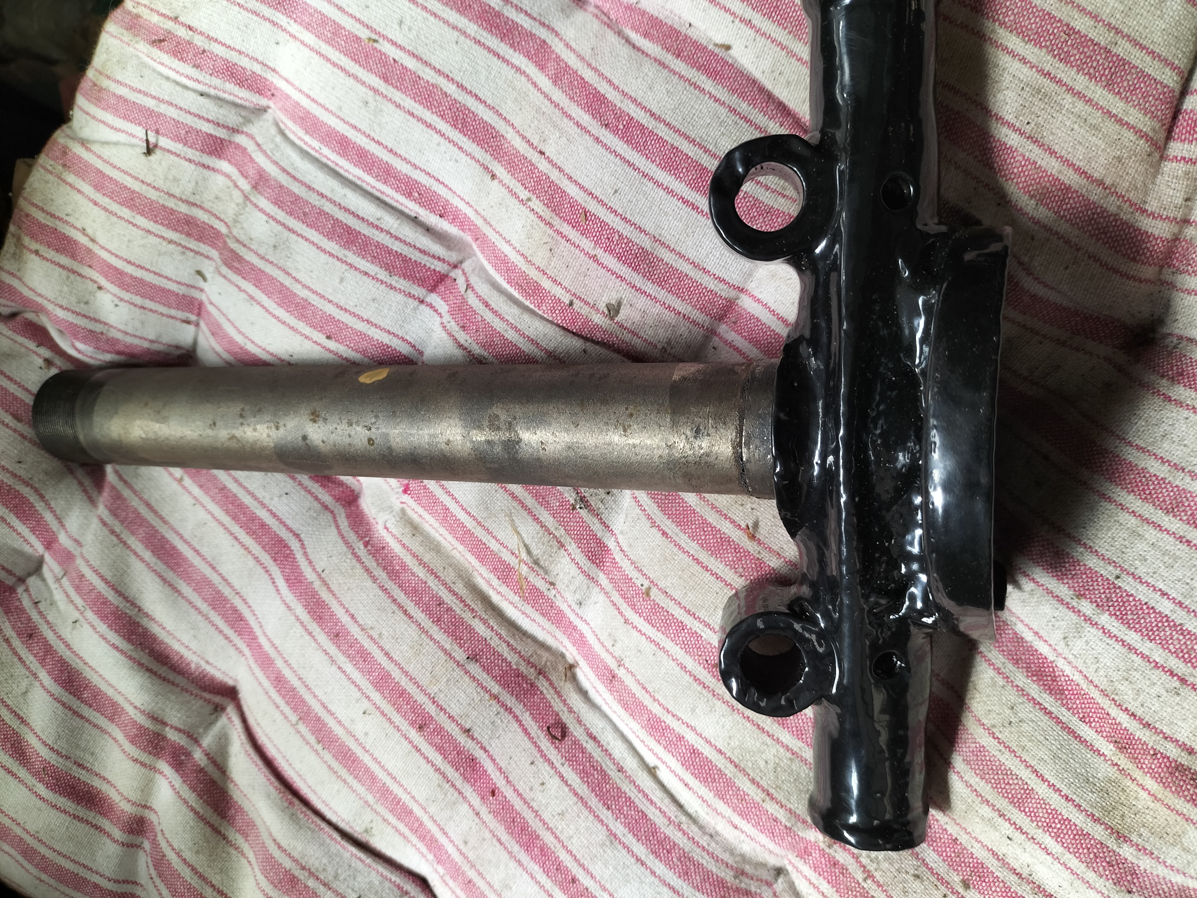

I have a 1928 CS1 that I am rebuilding. I have come to look at the forks. Everything seems ok except the bottom yoke. Mine has the lugs on for headlamp mounting rods which I believe is wrong. I have seen a yoke with these lugs cut off so assume they are the same dimensions.
So has anyone a picture of the correct yoke or better still a spare one!
I will be running lights, so will need the small brackets that attach to the front of the blades for the headlamp rods. Again, has anyone a picture of these brackets?

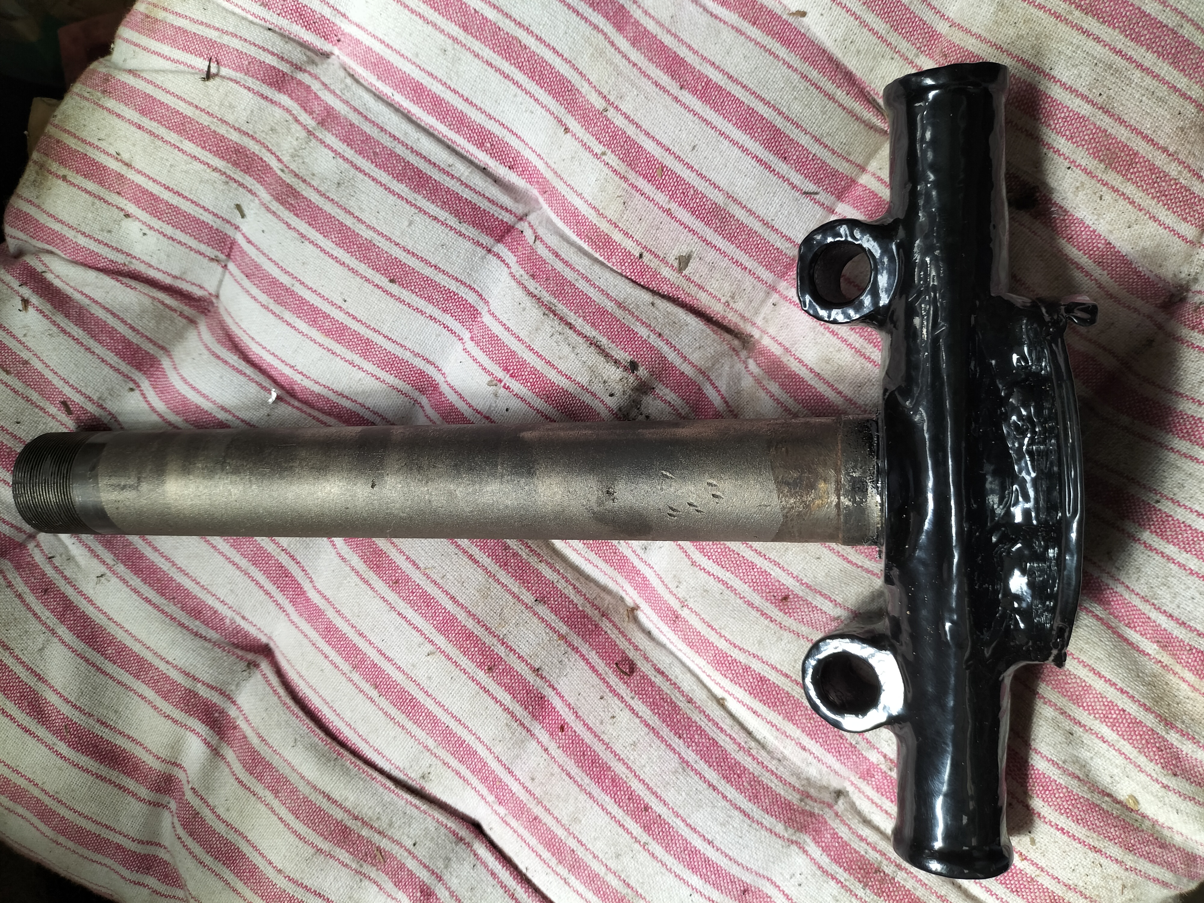

Hi Paul,
Attached are a couple of photos of my 1928 CS1 headstem (just back from the painter).
The bike is fitted with lights.
