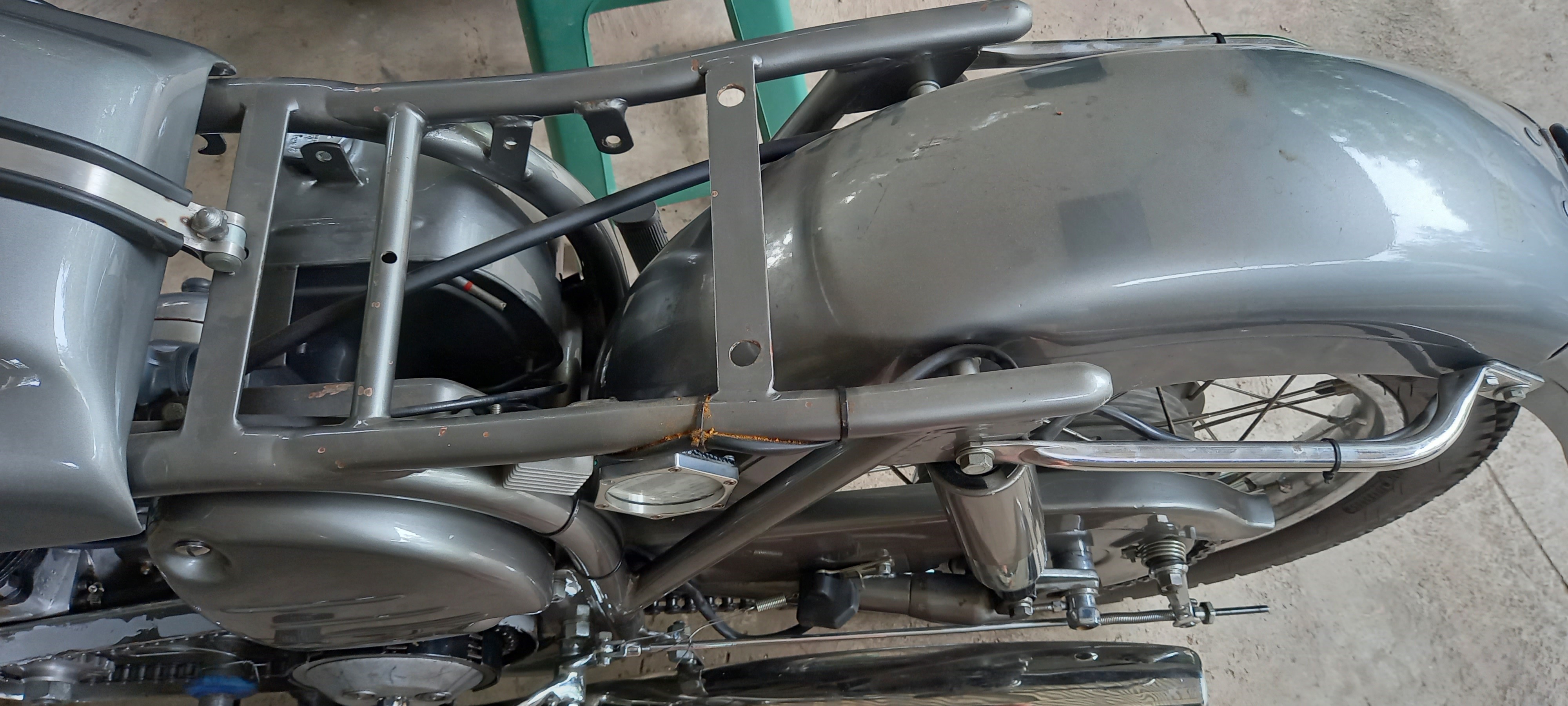

Surely this pipe should go back to the oil tank? As there is no pipe on the oil tank and there never was a pipe to the rear number plate originally??
Further-IF you fitted a Slimline oil tank, you would get a Froth pot that would take this breather pipe. it would also change the tool tray over to a Slim Line one. The two rear mounts still work, but front mount will need some 'arranging'
Other wise have it original-what ever that was?

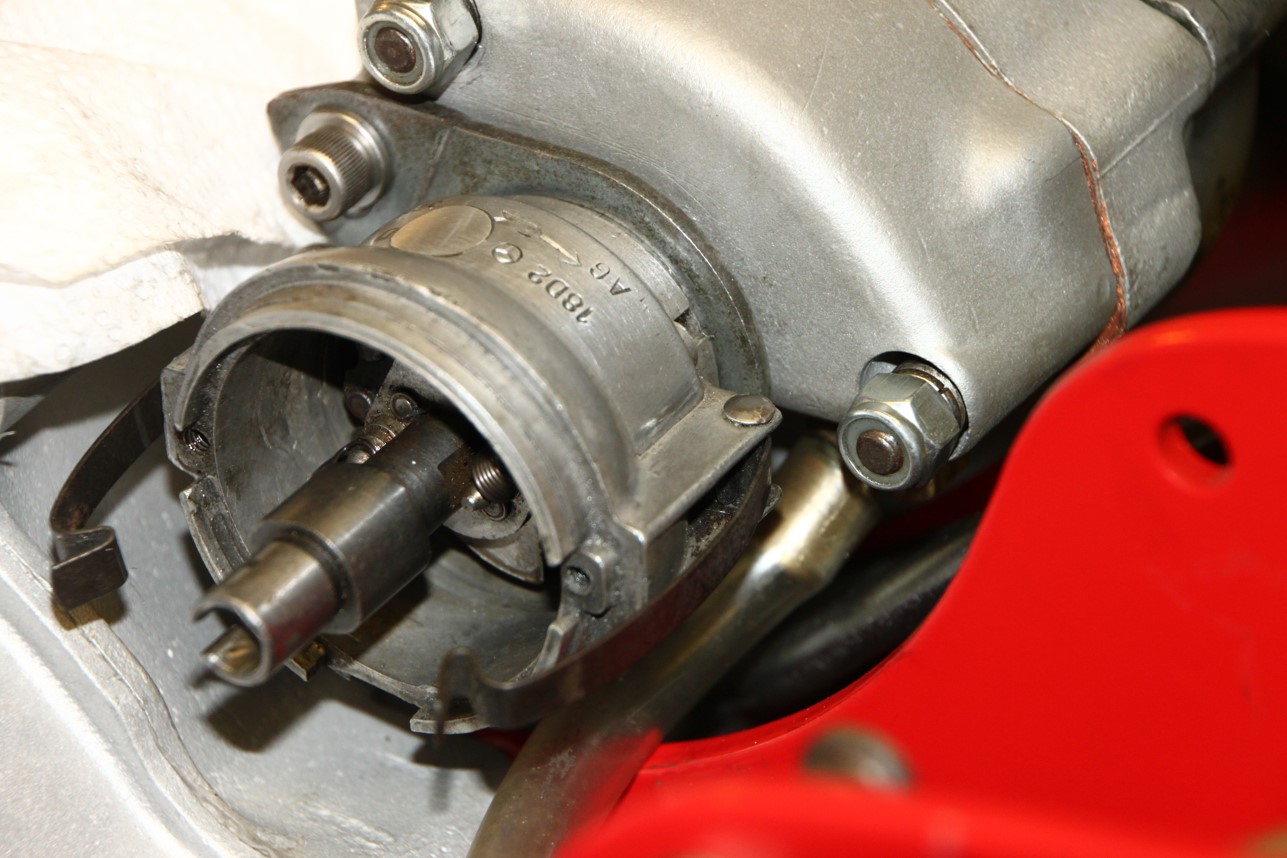

Newly rebuilt? Was the crankcase split and the camshaft breather disc either removed or correctly engaged?  Sounds like your breather pipe routing needs altering. Engine breather to oil tank then oil tank to atmosphere.  If you have fitted a NRV to the oil pump supply, beware as if it sticks shut it will destroy your engine (a better one is the type that have a cutout switch so preventing the engine starting without the oil on)

Peter,  The breather on the camshaft end was fitted correctly.

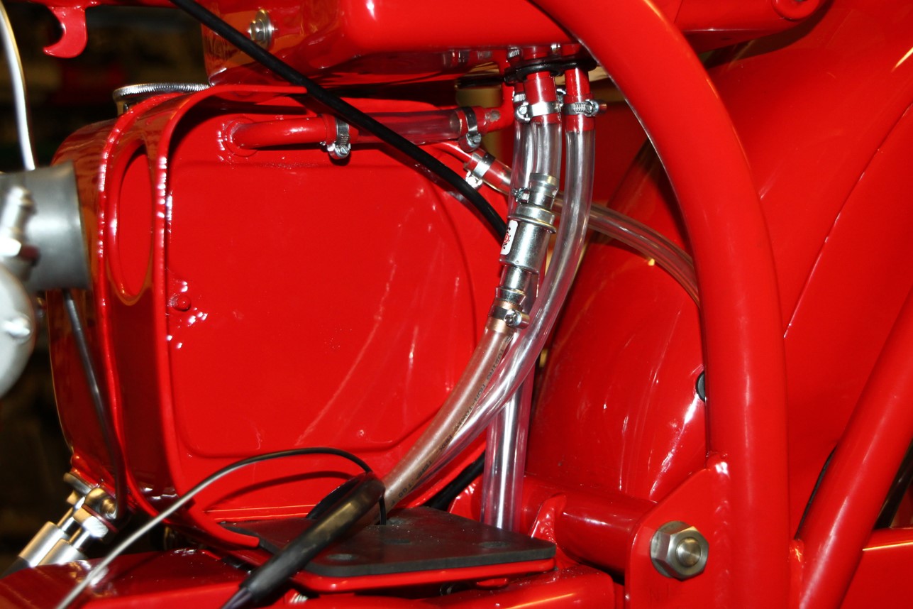

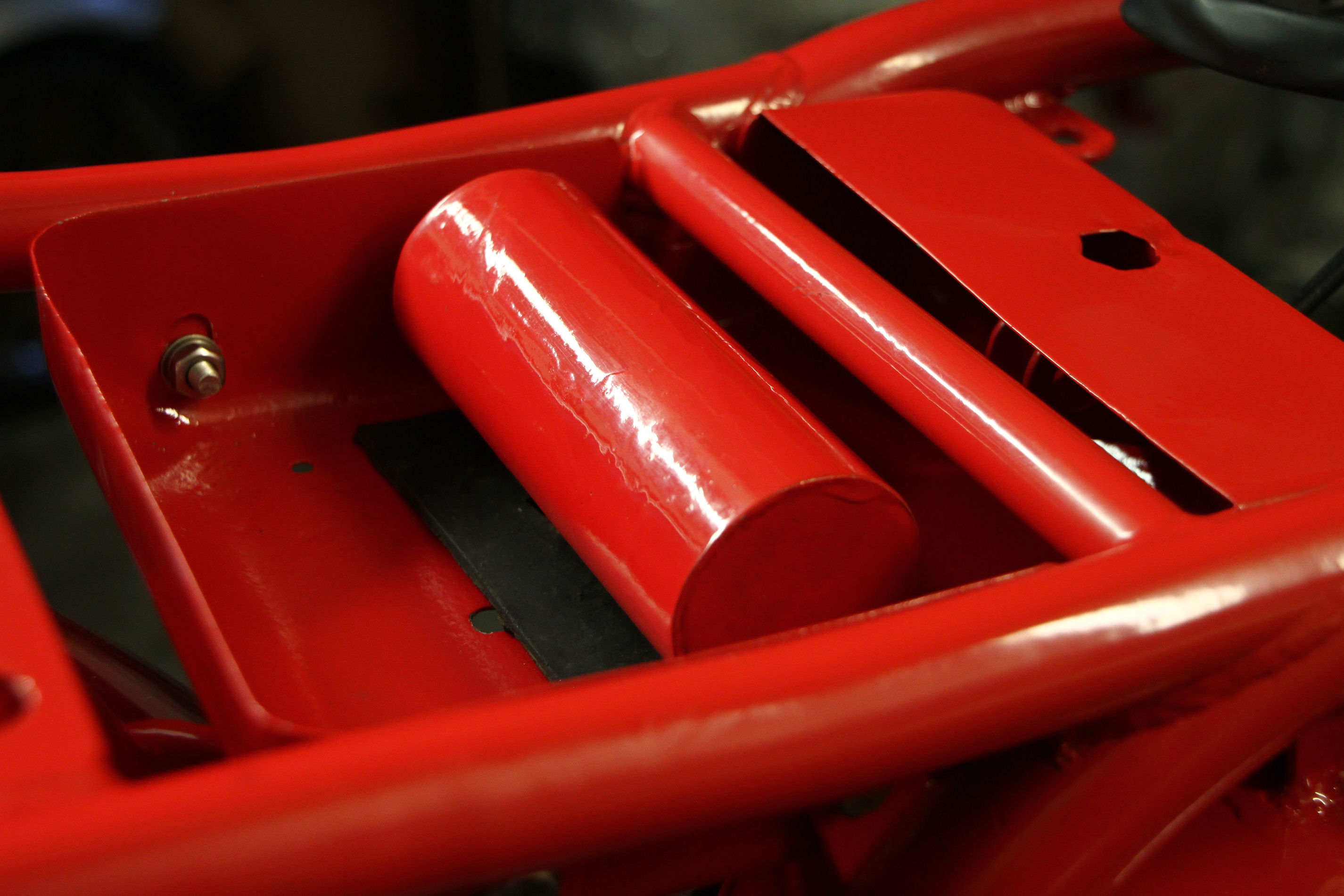

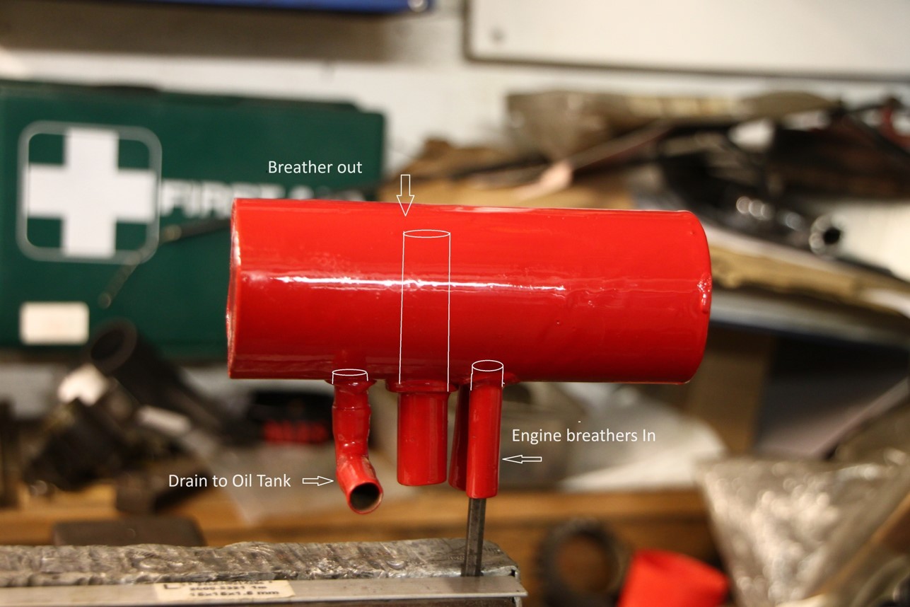

My Dommi always used to blow oil out of its breather - no matter what I did to the pump. When I rebuilt the bike I came up with this system which has worked very well now for 5 years (I made a similar set-up for my ES2 18 years ago). I also added an extra breather (+ NRV) coming from the mount that takes the distributor - it's well hidden - I'm not altogether sure that it's necessary but the engine is oil-tight and it's used quite hard. I think the pics make it fairly self explanatory - just make sure room is left to be able to get at the nut of the top oil tank mounting. The large tube out of the unit just drops behind the gearbox and little or no oil is ejected from it.
I ought to add that the reason that I didn't just go straight to the oil tank with the breathers is that the oil tank itself only has a very small breather tube out and speaking from experience, if the oil tank is pressurised in any way, it tends to eject quite a lot of oil.
