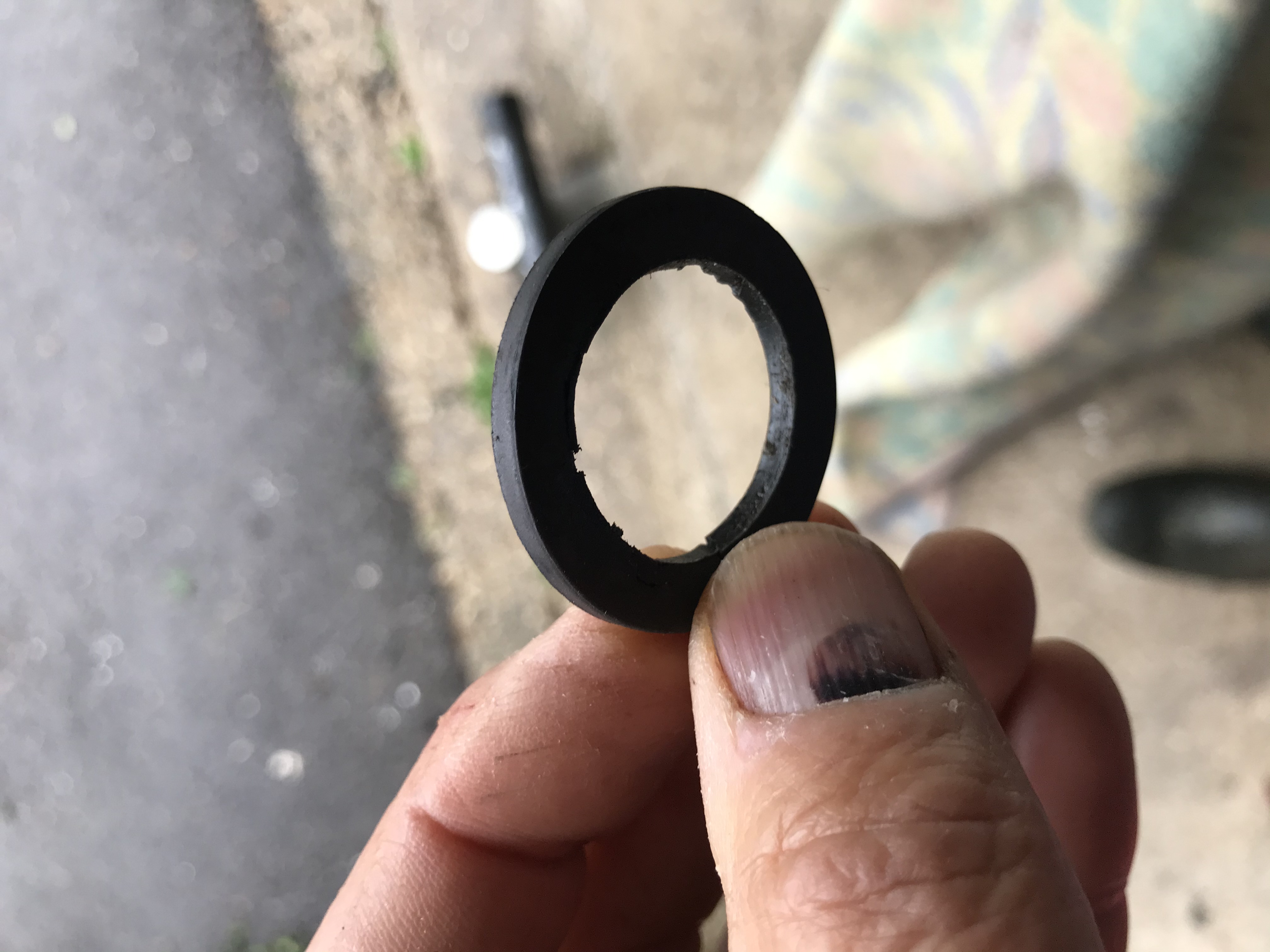

Managed to damage my new purchased clutch oil seal witch should fit in the rear of the inner chaincase. The part number is 22474. Will not fully fit in the recess as the rear riveted retaining cup protrudes slightly into the recess and is preventing the seal from sitting flush. Is this the right seal, spares do two types, the 22474 which is 40mm and a smaller one with is 38mm. The engine is 1960. What am I doing wrong.

It looks like the riveted plate internal diameter is fractionally smaller than the inner plate seal diameter. This is preventing the seal from sitting flush. I`m putting a order in for some other bits so I will order a couple of seals. If the new seal is a tight I might use the Dremel to make the seal fit.

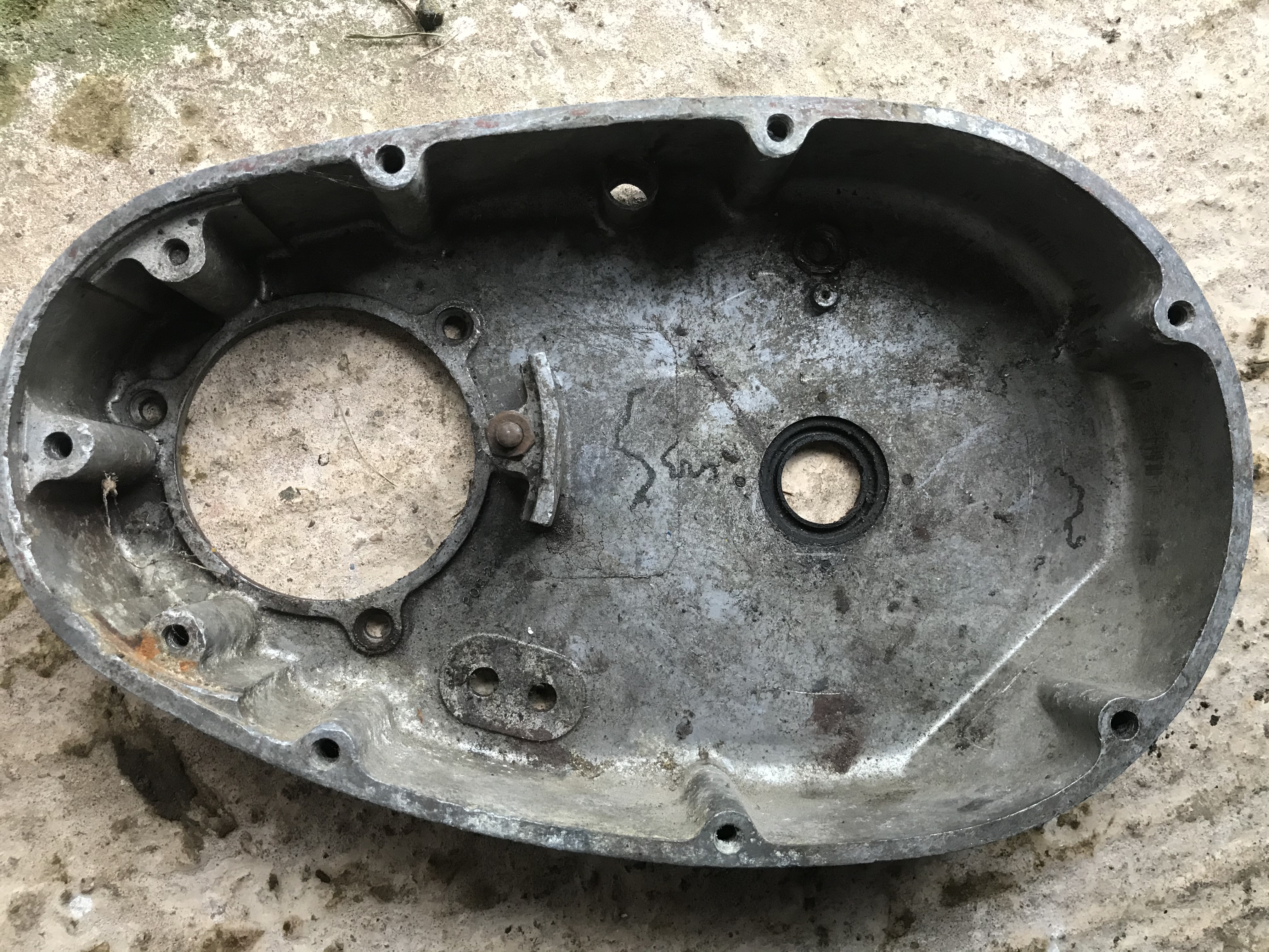

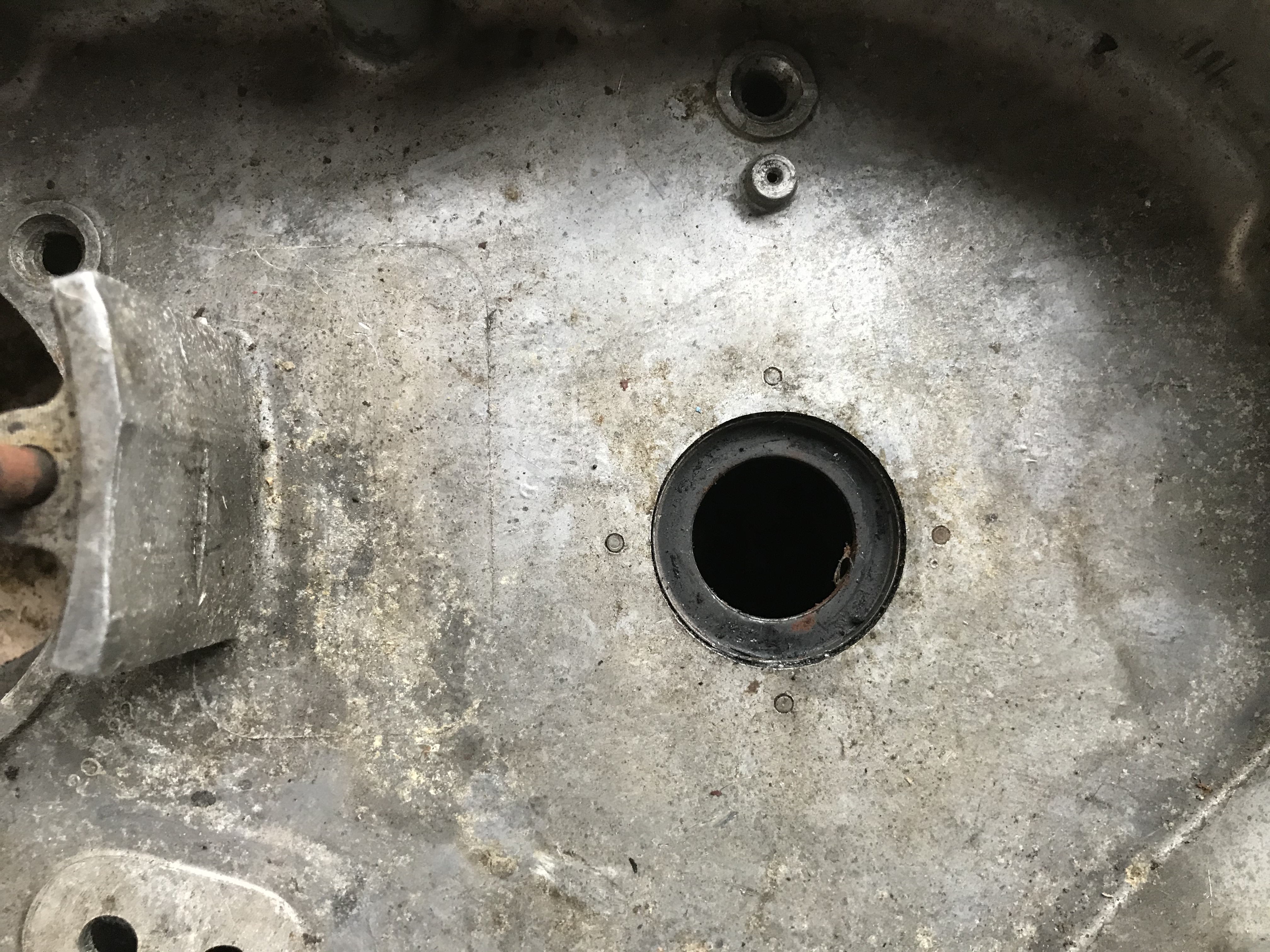

John apologies, having looked in my pile of spares I can see that it was the drive side crank seal that was a pain in the bottom. The chaincase seal fitted in ok. Here’s a couple of pics of one of my chain cases. A dremmel shouldn’t be necessary the seal buts up against the riveted plate.

Thanks Dan. Your seal does look flush with the case, my old one also did. I just could not get the new seal to fit flush. It is the riveted cover that is preventing this. Should there be a chamfered edge on the back part of the seal, has anyone else had problems with these seals. Ive ordered two new seals, see how that goes.

The seal is just a normal seal , no chamfer, bit it is only about 3 mm thick.
If it helps the number on…
If it helps the number on the seal is RTB 3371. 53. I’m guessing 25x40x3, 25x40x5 seems readily available but it will protrude by 0.5mm it’s worth checking whether it matters if it protrudes a bit, if there is clearance with the back of the clutch I wouldn’t worry about it.

I agree, thats what I did, the problem is the recess for the seal is less than 5mm the width of the seal (readily available from simply bearings). But it may not matter if it doesn’t rub on the back of the clutch. That’s what I would check first.
