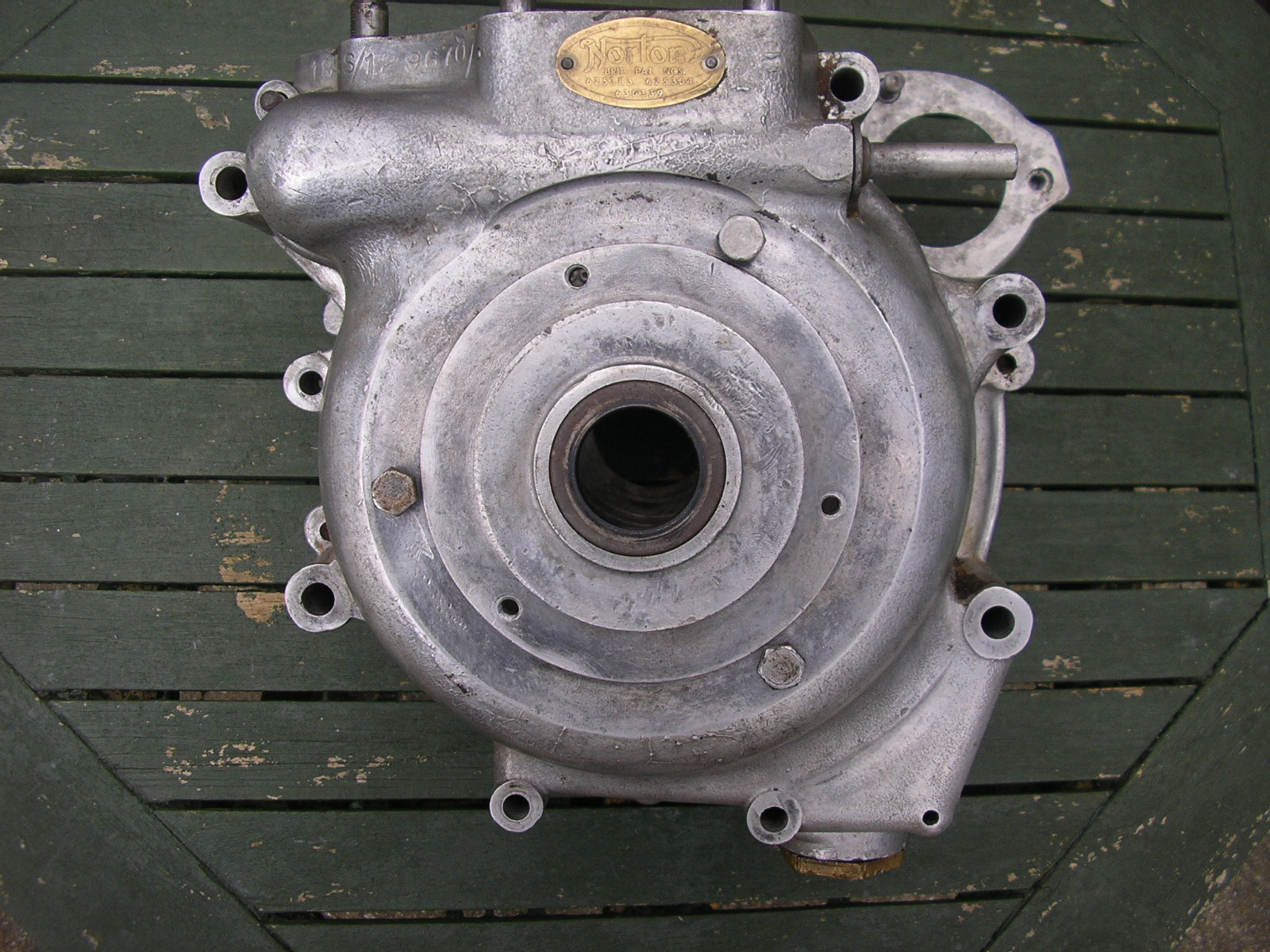

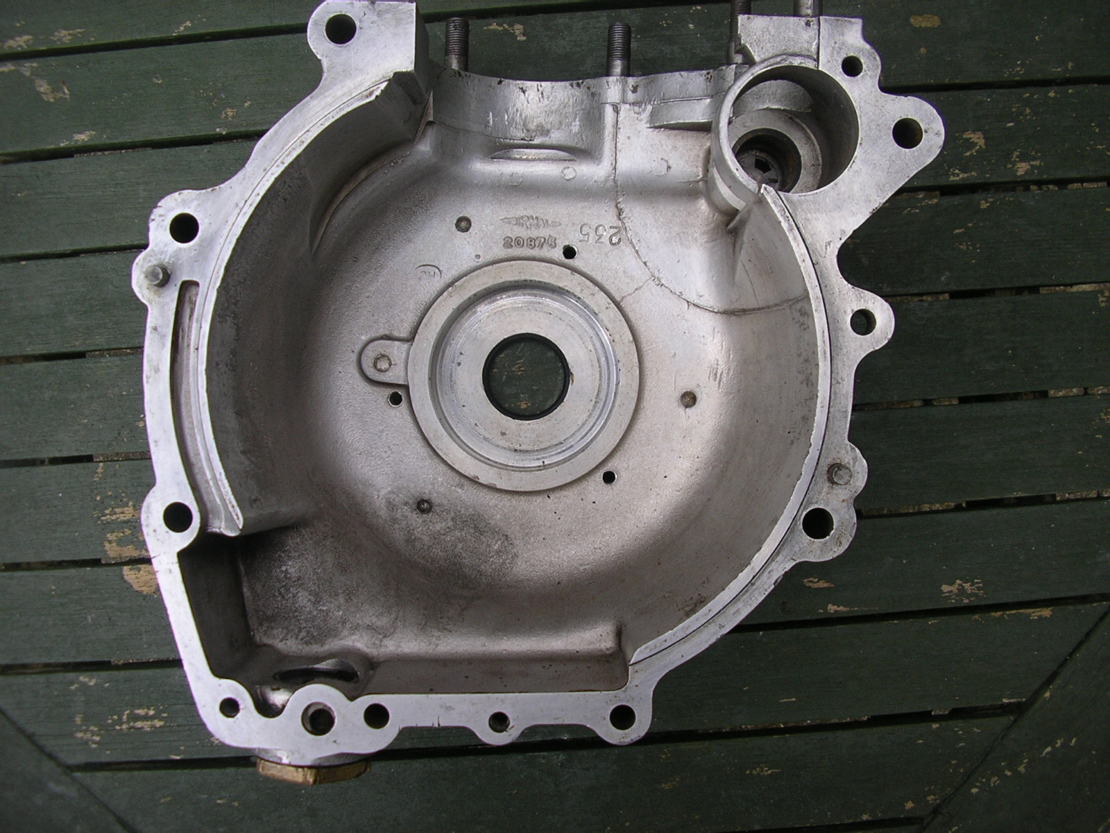

As you can see from the photographs of inside /outside my Mercury cases.......all the primary case holes are drilled through roughly the same thickness of metal. But slightly thicker metal for the alternator stator cradle holes.
