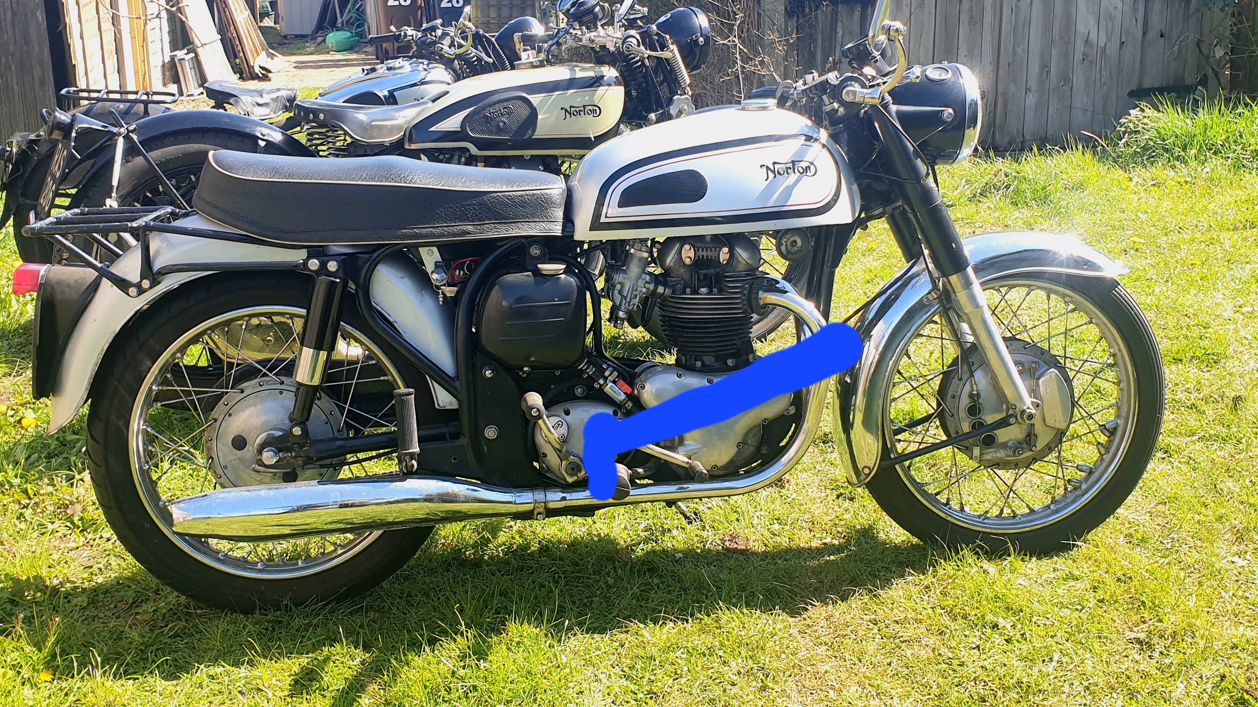

Has anyone thought of grafting a commando  primary chain case to fit our engines - then we might we be able to fit starter motors and keep us riding for a while longer?

I have not measured them, but I believe the Commando primary case is shorter than a Dominator one.
Various engineers, worldwide, have looked at providing the Dominator with an electric start. This includes two versions that use a timing side mounting and one that is sits on the primary side. I do believe that one of these electric starters got a serious mention in a Roadholder a year or two back. Our RH  magazine editor, Mark Woodward, would probably have the latest news.
Most of the Hybrid 750s use an alloy primary chain case set-up similar to the Commando. Although the gearbox is mounted differently, could this be another starting point to help go electric?
Thanks Phil, I have emailed Mark for his remarks. I would think a starter running through the timing side would be problematic - would it be robust enough.
2020 saw an article in RH with a timing side starter.
