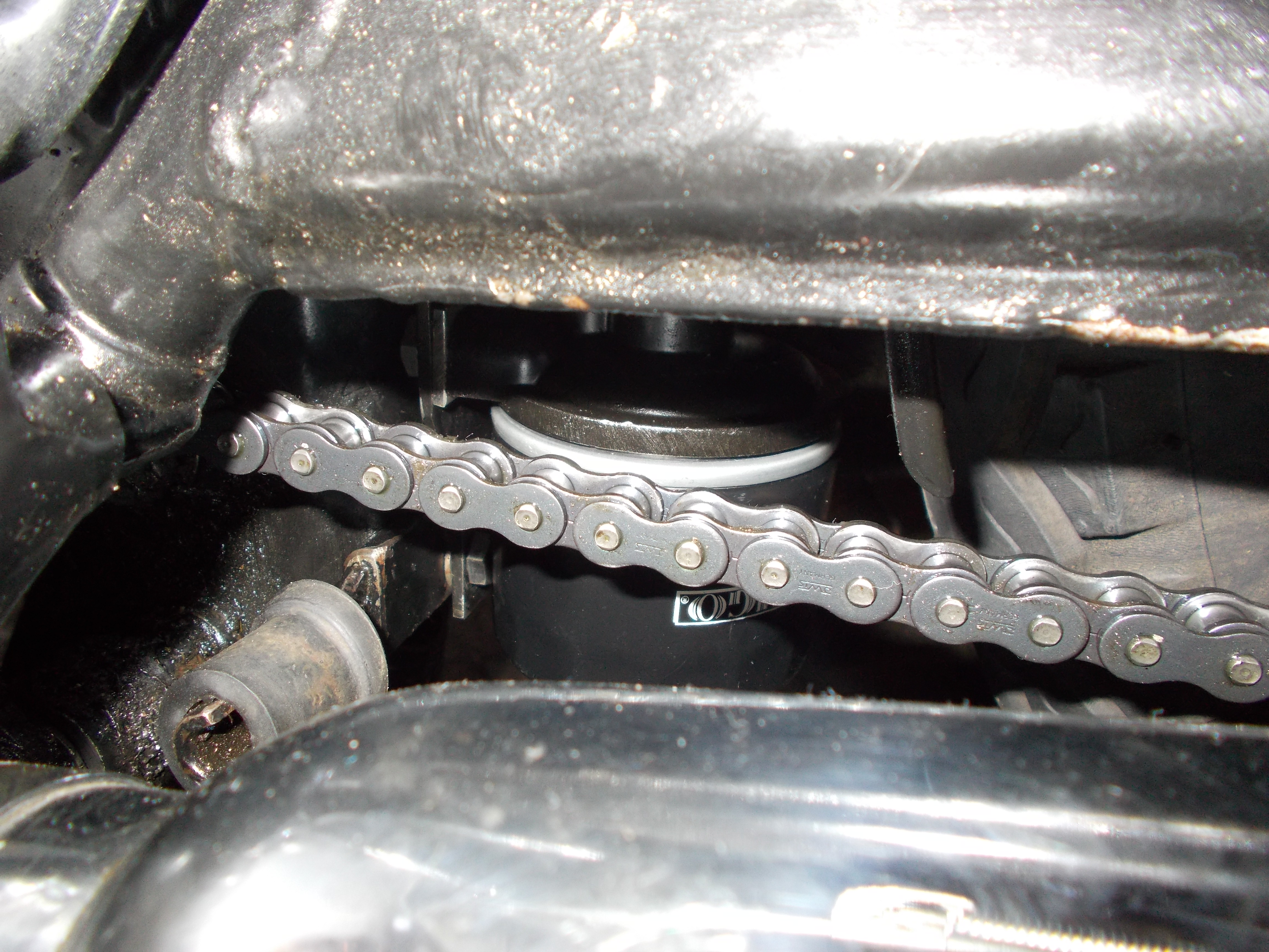

Photo showing position of the oil filter I fitted to my Electra .

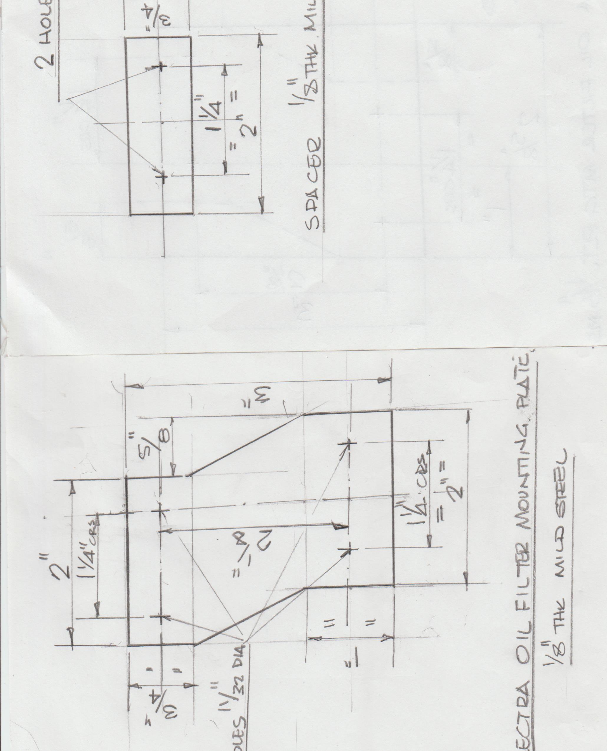

Hi Dave,
I found the sketch of the bracket I made to attach the oil filter on my Electra.
Frank

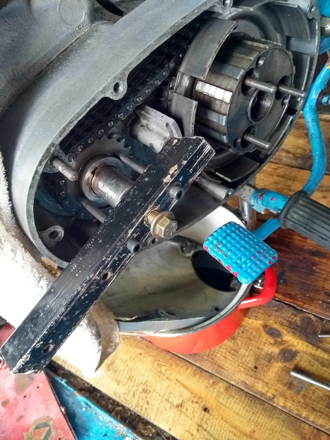

Crank Oil Seal Replacement - Electra
Sorry, Ron - missed this one!
The Crank Oil Seal is fitted from the outside - so it can be replaced without splitting the cases.
However - it sits behind the engine sprocket!
This sprocket is hard to shift if it has not been off for some time, as it sits on a taper, & the fit gets tighter & tighter with use. AND, there is only one tool for the job - it utilises the holes in the side of
the sprocket, as you cannot get behind the chain to fit a conventional puller..
Although, a home made version (such as attached) will also work.
Sprocket & clutch come off together, having removed the alternator first.
The oil seal is now accessible.
The remove the old one, drill two small holes into the seal opposite each other, install a couple of short self-tapping screws into them and pull on the self tappers to extract.
Enjoy
