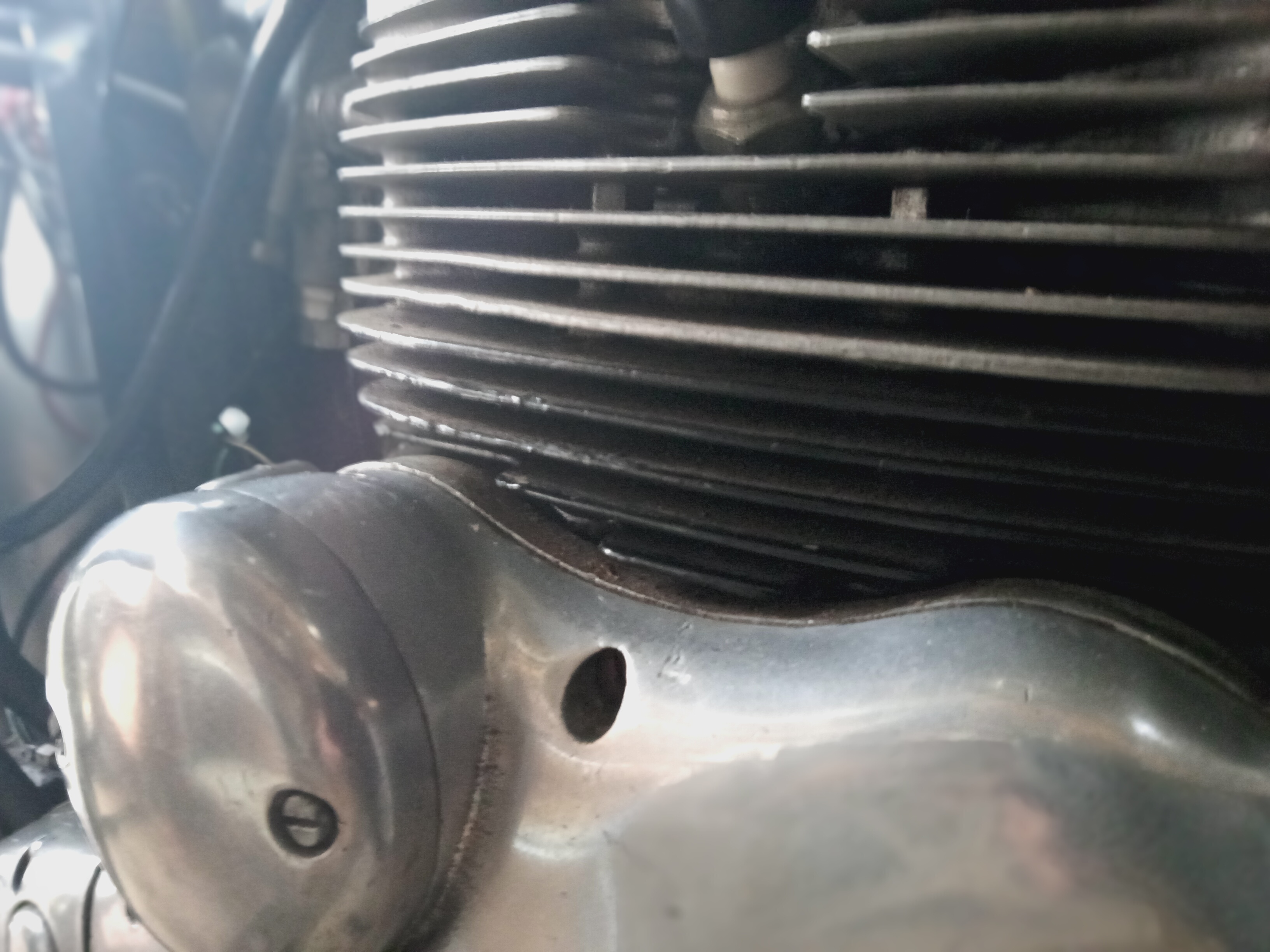

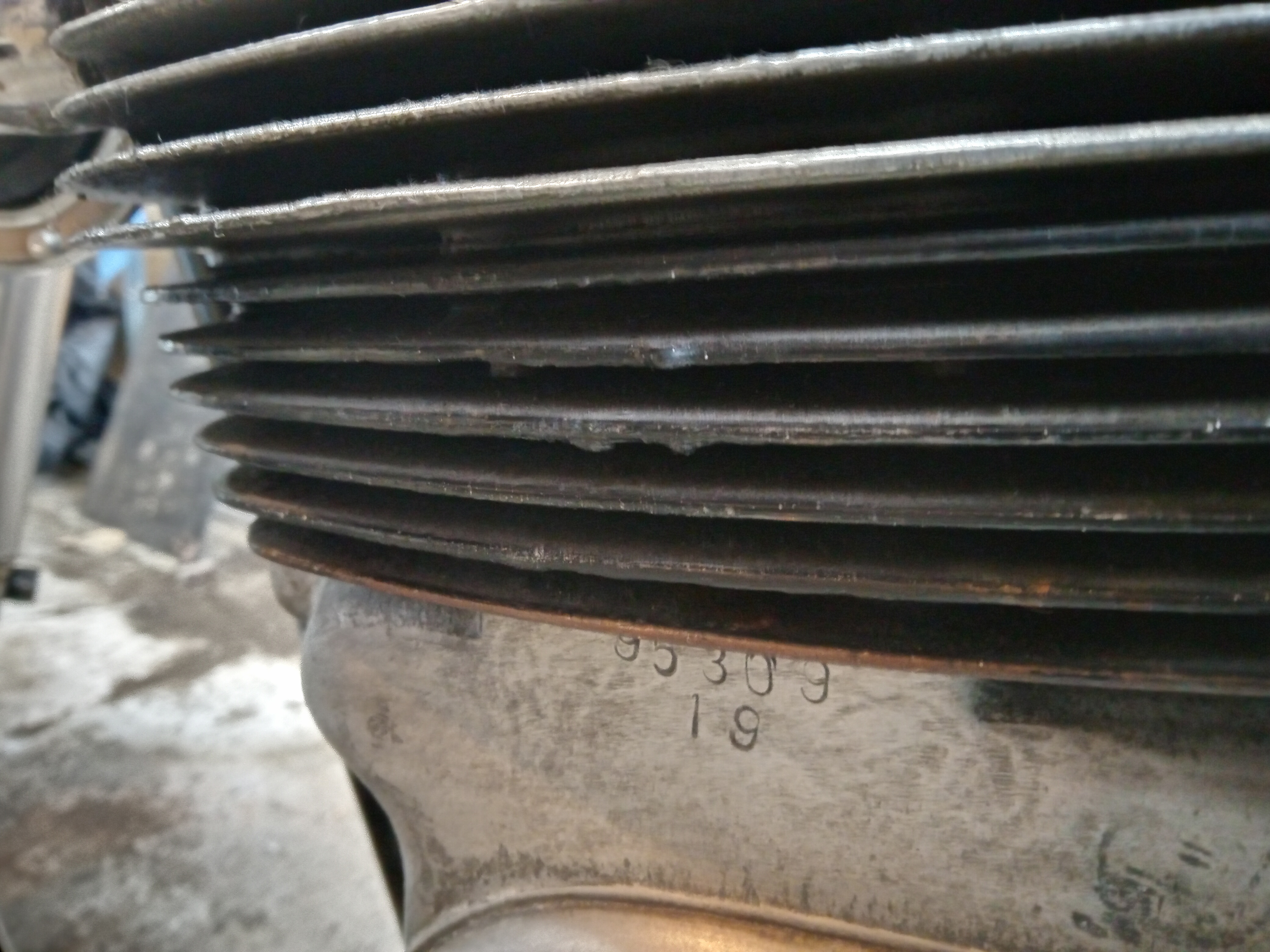

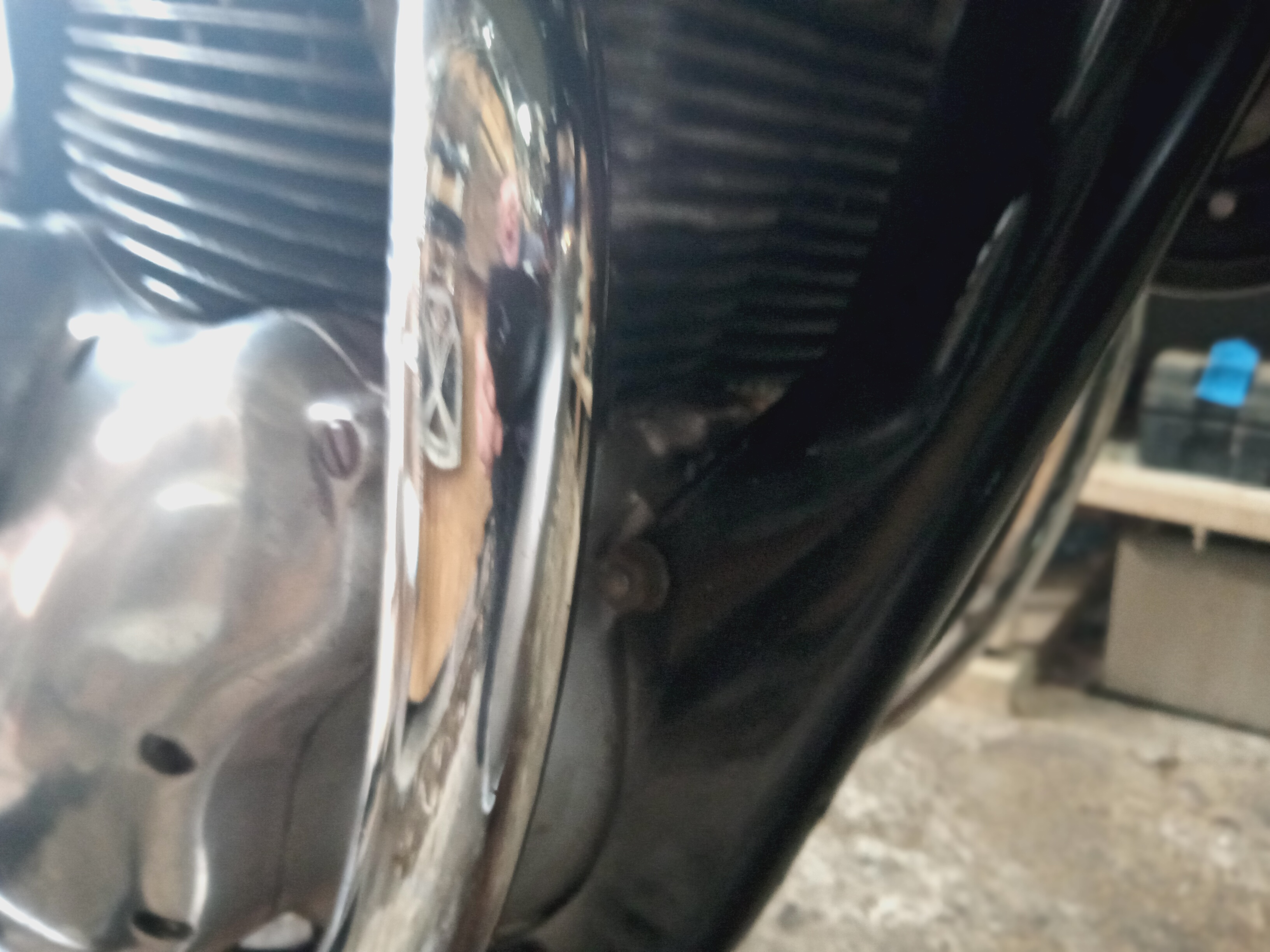

One other thing you wise ones may be able to advise on - have a look at the photos.  I count 6 fins on the barrel.  Has someone turned a 350 into 250?  The engine number - 95309 19 - is definitely 350 and you've probably seen the bike before in NOC publications (it's the one with the yellow tank), but I've read that Navigator barrels have 7 fins not 6.  Am I mistaken?
