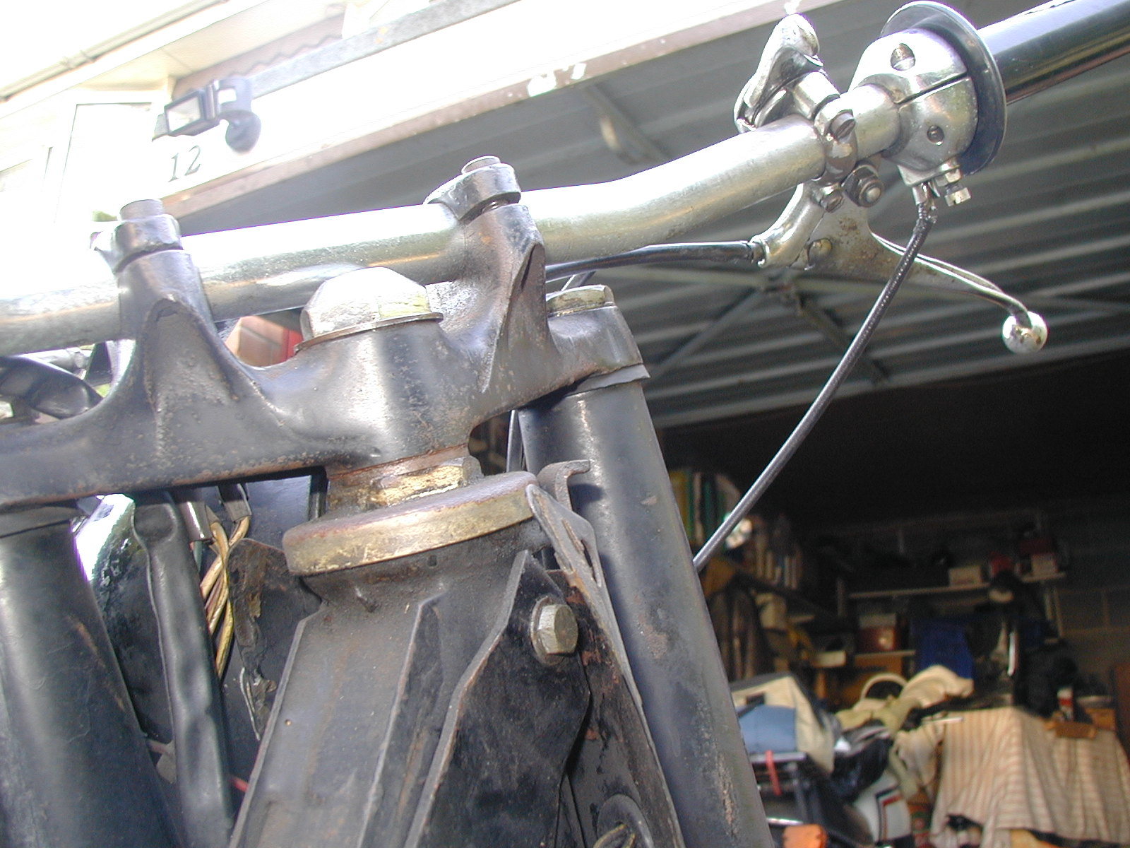

Hi Dan, Finally picked up a…
Hi Dan,
Finally picked up a set of dominator road holder forks for my Jubilee, what is involved in fitting them?
kind regards Gary

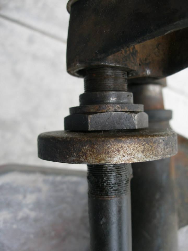

Hi Gary,
Good Luck in your search for the forks.
They should fit easily to your Jubilee - as the Navigator & Electra with a similar frame used them.
There are two proviso's:
1) You will need the Navigator/Electra cones fitting to the stem, as its thicker than the Jubilee item. NOC Spares are currently out of stock. Russell Motors may have them?
2) You will need an additional spacer under the fork crown, if fitting a Roadholder type headlight bracket holder, as the Featherbed headstock must be a fraction taller.
