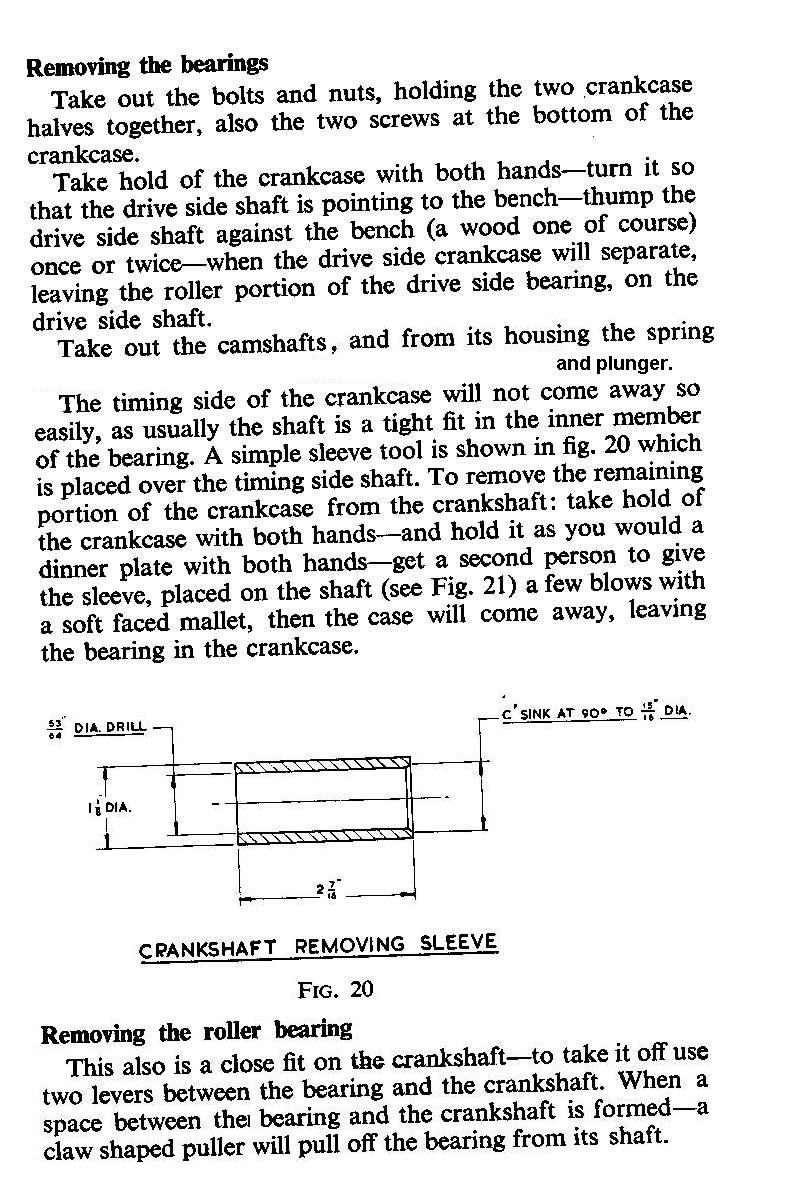

I've got to the stage of trying to separate the crankcases on my navigator. (I believe) I've removed all of the bolts etc holding them together - including the hidden ones - does the separation require pullers of any description (as someone has mentioned to me) or should they separate with a small amount of heat and persuasion? It's one of the original 'de lux' models 1960 and I would think the engine hasn't been split since it left the factory 60 years ago so it's being slightly stubborn. But for obvious reasons I don't want to 'push it'

What you need is a steady pressure between the case halves while you heat around the bearing housings and bump the case mouths appart using a softwood drift and mallet. I have not have had to resort to wedges but have had to fill the bruising caused by clumsy use of metal wedges.Its also likely that the bearings are too tight a fit to the shafts , so heating around the cases may allow the bearings to come out of the cases. Shafts can be eased a bit for re-assembly.

Find a likely place like the rear of the crankcases or near sump, put the sharp edge into the joint, and tap the back of the blade with a light steel or copper hammer. Don't use force and just let the blade taper do the work. No levering. Move along as the gap develops.
Robert and John probably don't realise that the drive side roller bearing will separate without any resistance. The inner stays on the shaft and the outer stays in the crankcase.

When you undo all the visible bolts and screws, there are 4 more to find. Two are in the timing case along the gearbox wall, & you need a very long Allen key to reach them - and there are 2 more between the cylinders - which are fiddly to remove.
Once they are all out, the drive side case should come off first. Make sure the conrods are at BDC. You can try to coax it with wood and a mallet, between the cylinders, back of gearbox & sump - or (if strong) try to thump the engine sharply down onto a solid bench - or lump of wood - onto the alternator end of the crankshaft. If its 60yrs worth of gasket goo, then work it gentry with the mallet approach.
Once the drive side is off - then support the timing side case as best you can (I use old shelving & car axle stands) with the crank hanging down and lots of old towelling below to catch it. You then need a sleeve to pass over the oil feed end (you must NEVER hit the oil feed end) of the crank, such that it abuts the crank under the bearing. I have sacrificed an old AF box spanner for this task.
With everything in place, a sharp rap on the sleeve over the crank should suffice to dislodge it. Again, make sure the conrods are at BDC, so they do not catch.

Over far to many years in mechanical maintenance I've split all kinds of casings, (gear boxes, motor covers, cylinder end plates, etc), many of which hadn't moved since leaving the factory. After checking that all bolts, screws, fasteners etc have been removed, (check then check then check again just to make sure), a tried and tested method is to use thin wedges lightly tapped in to the joint along its whole length. As you move along the joint you should find it starting to open up. Once it opens it will be necessary to keep the faces square to each other until the halves separate enough to clear any locating dowels. Gentle heat applied along the joint should release any sealing compound and lightly tapping with a hide (or rubber) mallet may help to loosen things up. Whatever method just be careful you don't crack the cases. Remember "softly, softly catchy monkey".
