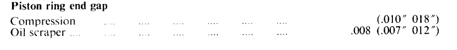

I think you have missed a decimal place out as 0.003" to 0.004" sounds about right, from my Navigator manual I have the following for the ring gap.
Remember that the pistons are oval shaped
Navigator ring gap
The above information as provided is correct. I'm unsure why you do not want to hone them and suggest that this may lead to a glazed bore and the rings wont seat in properly.
