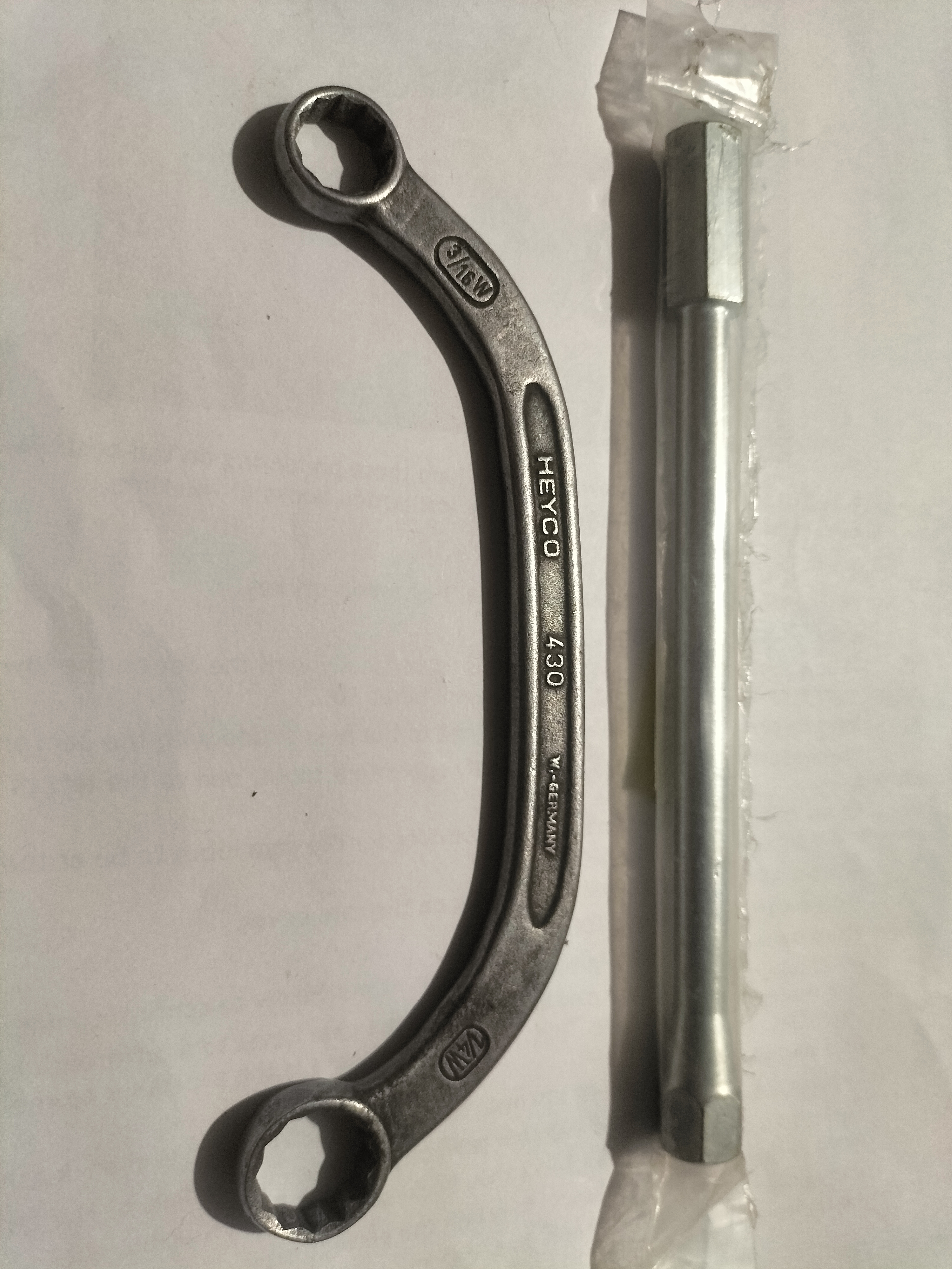

A visit to the local autojumble should turn up a suitable spanner (a combination ring spanner) to modify for around £1 if you good at haggling. Look in the boxes of rusty junk that people always take to autojumbles. Get the shank of the spanner red hot and bend it to a suitable curve. You're essentially making your own obstruction spanner.
They exist!
The Velocette Owners Club shop has the strange magneto bottom nut spanner. When you put the mag back on, make sure you use a BSA twin extended nut. It makes life so much easier. I was able to do a mag swap including timing in an hour last week.

Hi Bob - I use an bi-hex ring spanner from Elora ( old West German brand ). I ground down the outer a little to give easy access ( I say that jestingly) then cut off the other end of the shank. My bikes have always had the reduced hex 5/16 inch Cycle nuts so a 3/16 inch Whit spanner is good. By fiddling the spanner on the nut then pressing up on the shank they will come undone. Of course removing the spanner and turning it over is often required. Eventually careful use of the thumb and middle finger will get it clear of the stud. Don't let it beat you. I once saw John Hudson remove one in minutes but it takes me a bit longer. Once removed fit a Bsa extended nut !! Cheers, H
