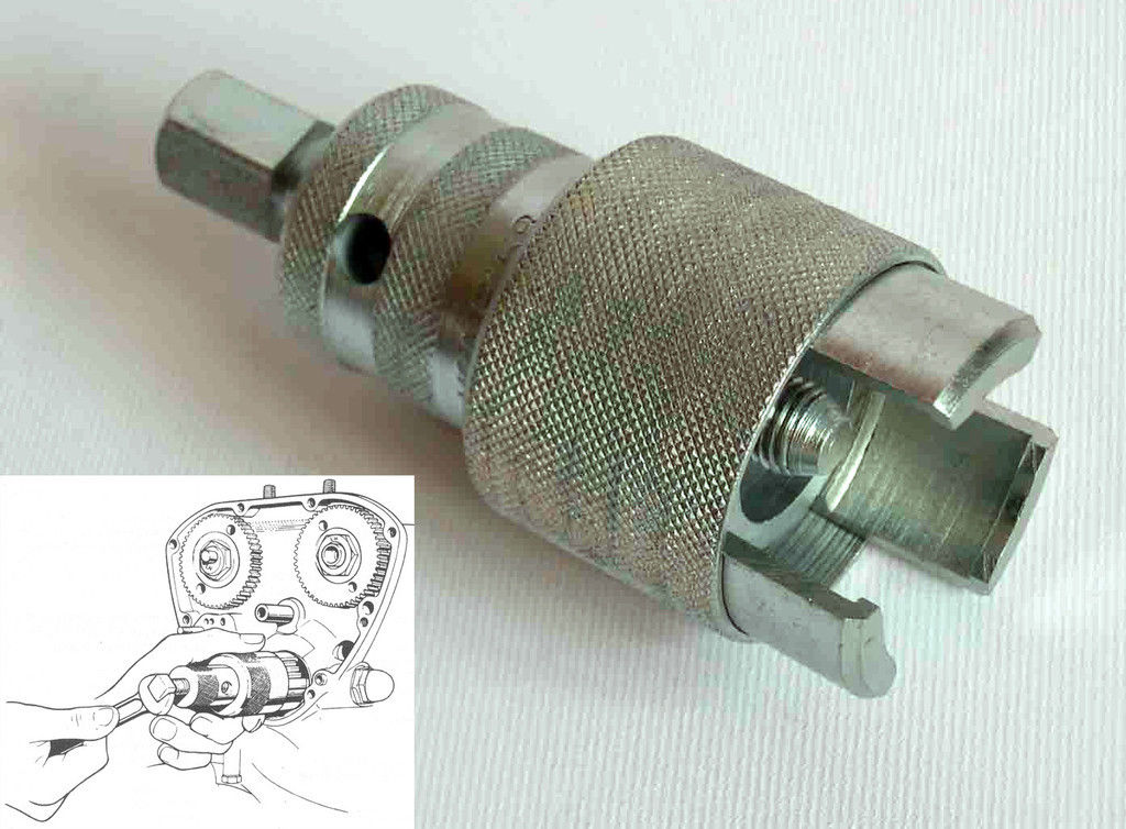

Hello again Tony, the puller is a "special" with three wide legs that have very small flats that engage behind the pinion where the three flats on the pinion washer are positioned.  The puller body is rotated to compress the legs on to the washer and then the centre bolt is tightened to pull the pinion along the key and from the crankshaft.  Sadly the puller has no other use other than its advertised purpose - however they do look nice and get many comments when left around any workshop.  Sorry I have digressed.  I have managed to remove the pinion in the past with small tyre levers and small steel wedges but all the other gears, chains, studs and pump must be removed first.  It is better to have the intended tool but the pinion is not normally too tight and if the key is in good order they do come off with perseverance.  Once it has moved a pair of  flat steel bars can be inserted and supported in a vice with the drive-side crankcase removed.  The end of the crank is struck with a soft metal mallet and hey presto......... Good luck,   Howard
The triangular spacer is triangular simply because you shall use the three-legged timing pinion extractor. On mine I had to grind the tool a bit on the outside to make it fit.

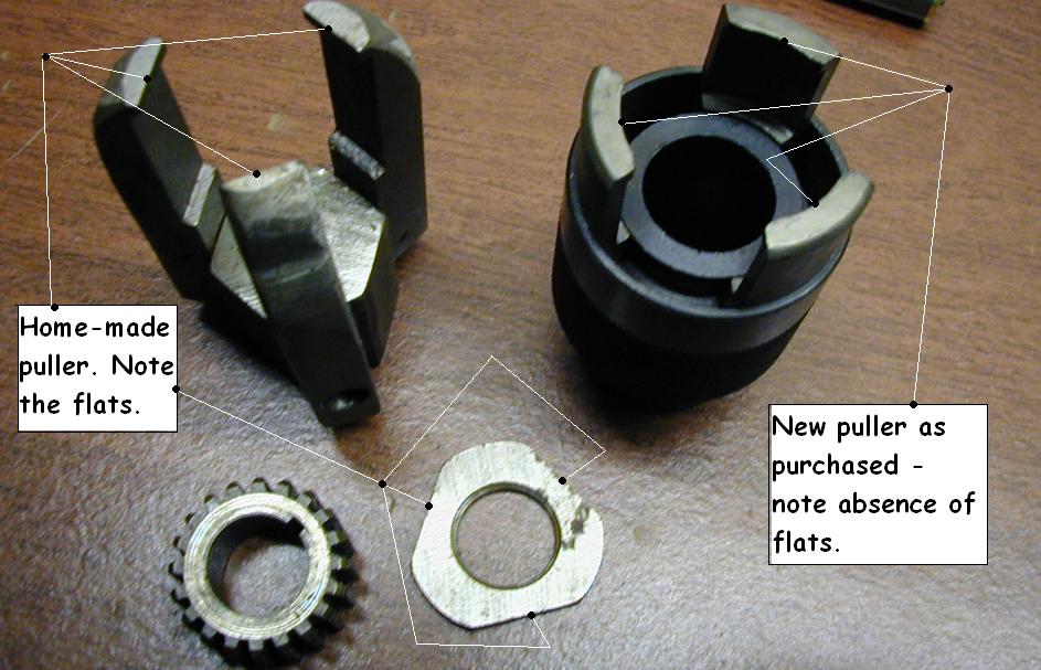

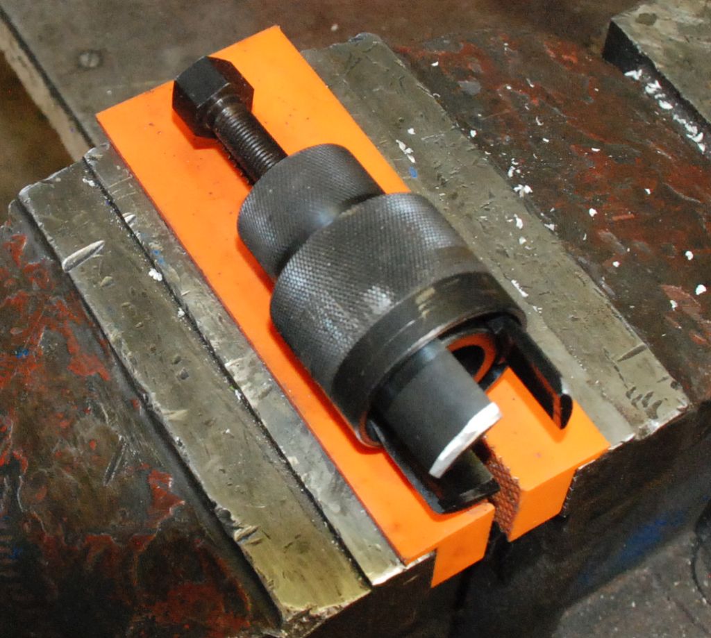

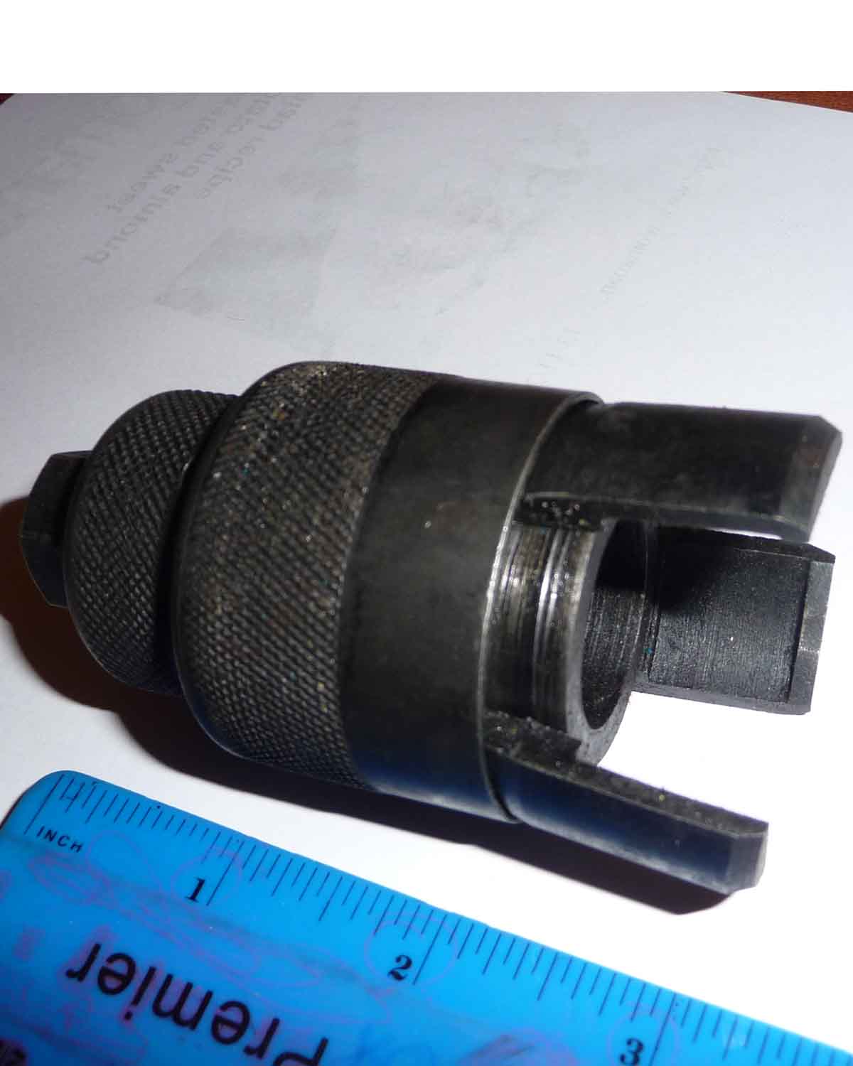

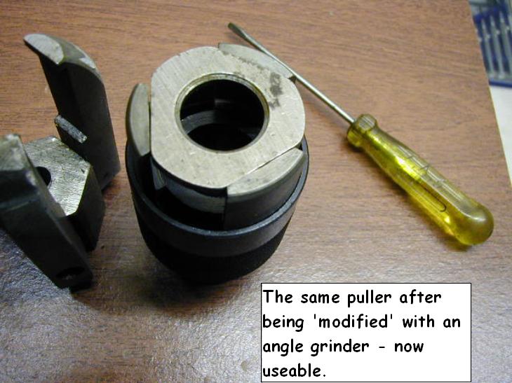

The puller that Robert refers to can be seen in the attached photos. It works by hooking under the pinion. The triangular plate allowing this to happen. However, as can be seen in the photos some of these pullers need a little modification to work correctly otherwise the feet just break due to insufficient points of contact. I retrieved these photos from elsewhere on this Site so a big thankyou to whoever originally posted them.

Nice pictures Phil.  Levering the thing off has been known to fracture the thin alloy behind.The Engine sprocket is the one that can really fox you. The puller currently supplied is about as much use as a chocolate fireguard. The pukka factory tool is the only thing that would shift mine.
The grinding needed on my newly bought tool.
Grinded tool
I believe the Domi half time pinion is the same set up as the Electra where the book says a special puller is needed. You can split the crankcase first and then there is lots of room behind the pinion to use a regular puller so that you can get at the main bearing.
Hi. The pinion is off! Special thanks to Phillip for the photos of how to re-profile the legs of the puller. Once they’d been ground back, they fitted behind the pinion perfectly. I’ve had that puller for over seven years but never managed to get it to work - finally it’s a useful part of my toolkit rather than just an expensive ornament.
