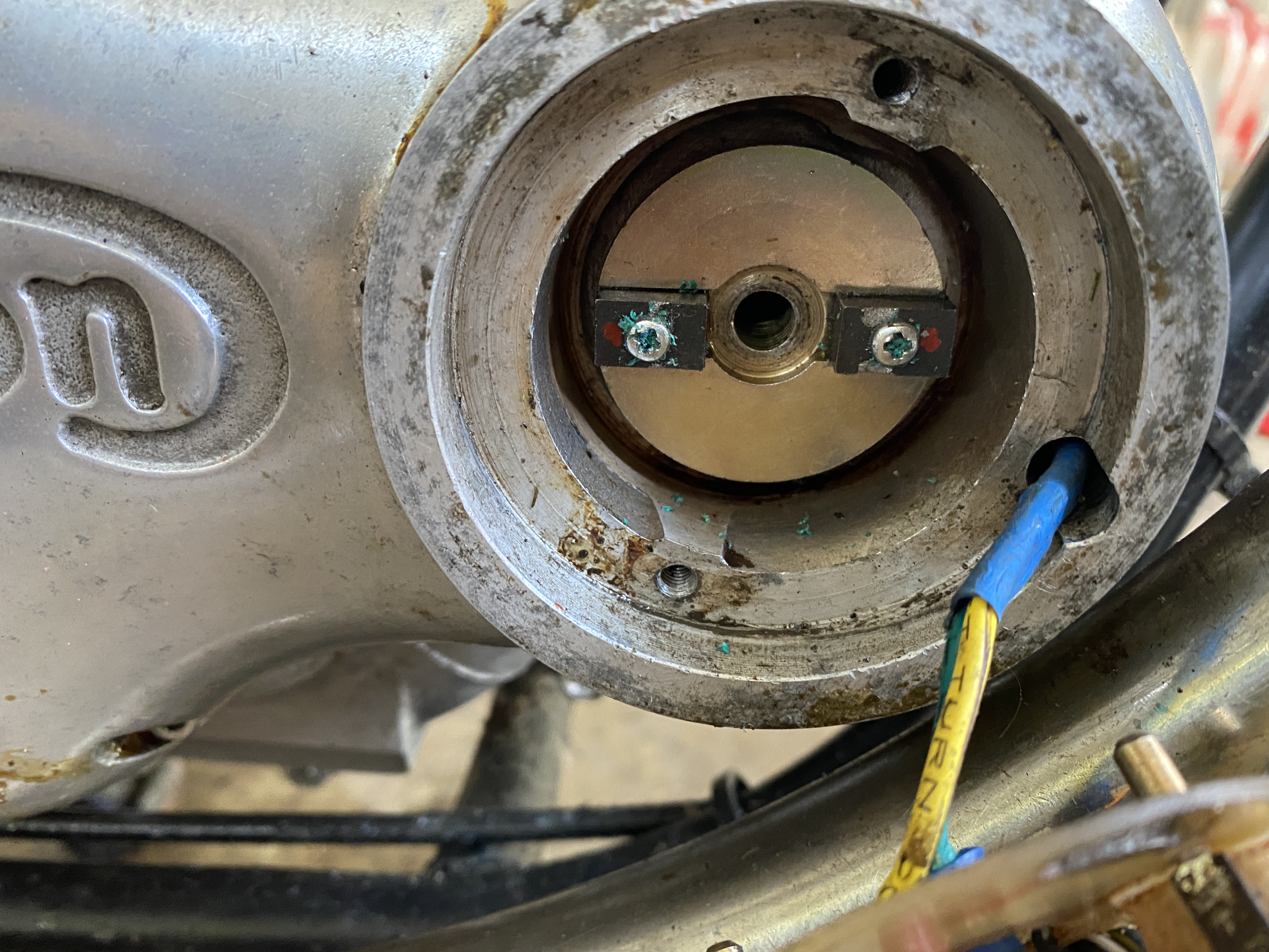

My '74 mk2a Commando will pop but not start. It is fitted with a Boyerbransen ignition. Boyerbransen told me to reverse the 2 wires from the static part. I did and it still won't start.
Specifically I want to know how to remove the rotating part.
See photo below which shows the rotating part. It's stuck and won't budge.

Plastic?
The rotor is a steel plate with 2 very strong rare earth magnets screwed/glued in slots. Early rotors only had the magnets screwed on-they flew off! So dropping them in slots and with a touch of epoxy glue assures us they stay!
By the way if anyone ever thinks of remaking this part for another motorcycle, or even rebuilding into a magneto body, then be careful the magnets normally have South Poles to the outside. If you inadvertently reverse one-it will NOT work. If you inadvertently reverse them both then you loose the advance curve! (See other posts) but of course you would then have to reverse the Pick Up wires to regain the advance curve.

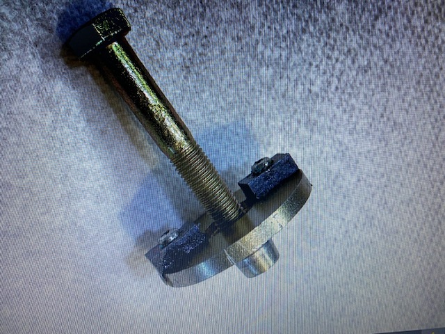

You are using a 5/16" cap…
You are using a 5/16" cap screw and not a 1/4" cap screw ?
Only the 5/16" cap screw is for extraction, the 1/4" screw will hold it in and you risk damage to the cam shaft if you hit it too hard.
I was using the 1/4' Cap Screw

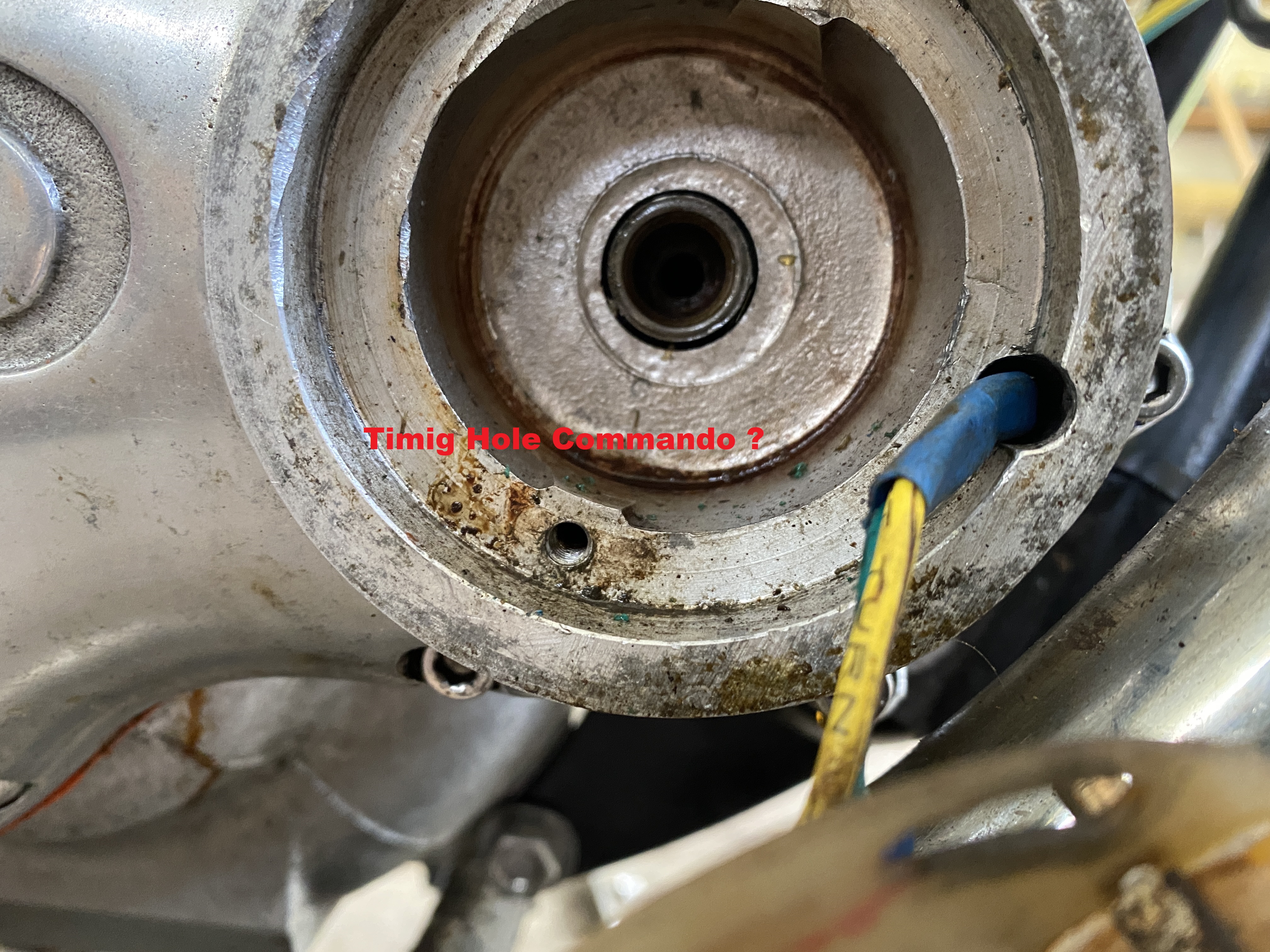

My quandary now that the rotor is off is to identify the "Commando Timing Hole" as per the attached
photo of the Boyer Bransden installation instructions. Please also open CamShaftEnd and pay close attention to the text. The text asks the question "is this the Commando Static Timing Hole" near the number 1
The 2 holes in the timing…
The 2 holes in the timing cover are used mount the stator and show as the 2 black holes with the slotted holes in the stator, the stator has a further 2 holes either side of the pickup coil that you use to get the magnets in the correct position. As there is one hole for anti clockwise and one for clockwise rotation you use the Commando one when the engine has the rotor fitted on the end of the camshaft. I fit the rotor loosely, get the engine to 31 degrees before TDC, fit the stator and move then move the rotor so a magnet is under the Commando hole and then tighten the rotor with the 1/4" allen bolt. That gives you the initial timing that you must confirm by strobe as it is normally too advanced.
Thank You John
Thank You John,
How do I determine "31 degrees before TDC" and how do I determine where the Commando hole is ?
See attached photo. Is the "Commando Hole" the barely discernible circular spot on the rotor ?
The Commando hole is on the…
The Commando hole is on the Boyer Stator plate and is not part of or on the timing cover.
Look at page 4, fig 1 is of the timing cover with just the rotor installed in the timing cover, note no commando hole, page 4 fig 2 shows the boyer stator plate installed and the commando hole identified on the boyer stator plate.
http://www.boyerbransden.com/pdf/KIT00053.pdf
The timing procedure is detailed in the riders handbook, see page 26
http://britmoto.com/manuals/Manuals/Riders_3.pdf
When you take the inspection cap off the primary cover there is a degree scale, with the plugs out , the bike in gear and on the centre stand you can rotate the engine with the rear wheel. You want the line on the alternator rotor to line up with 31 on the scale.

The rotating part (called the rotor) of the Boyer Bransden electronic ignition is threaded with a larger diameter thread than the end of the camshaft.
From memory it is a 5/16” UNF thread.
If you screw a bolt of this thread type into the rotor, it will push against the end of the camshaft and the rotor will drop off.
You may need to give it a very light tap just to break the seating on the taper.
