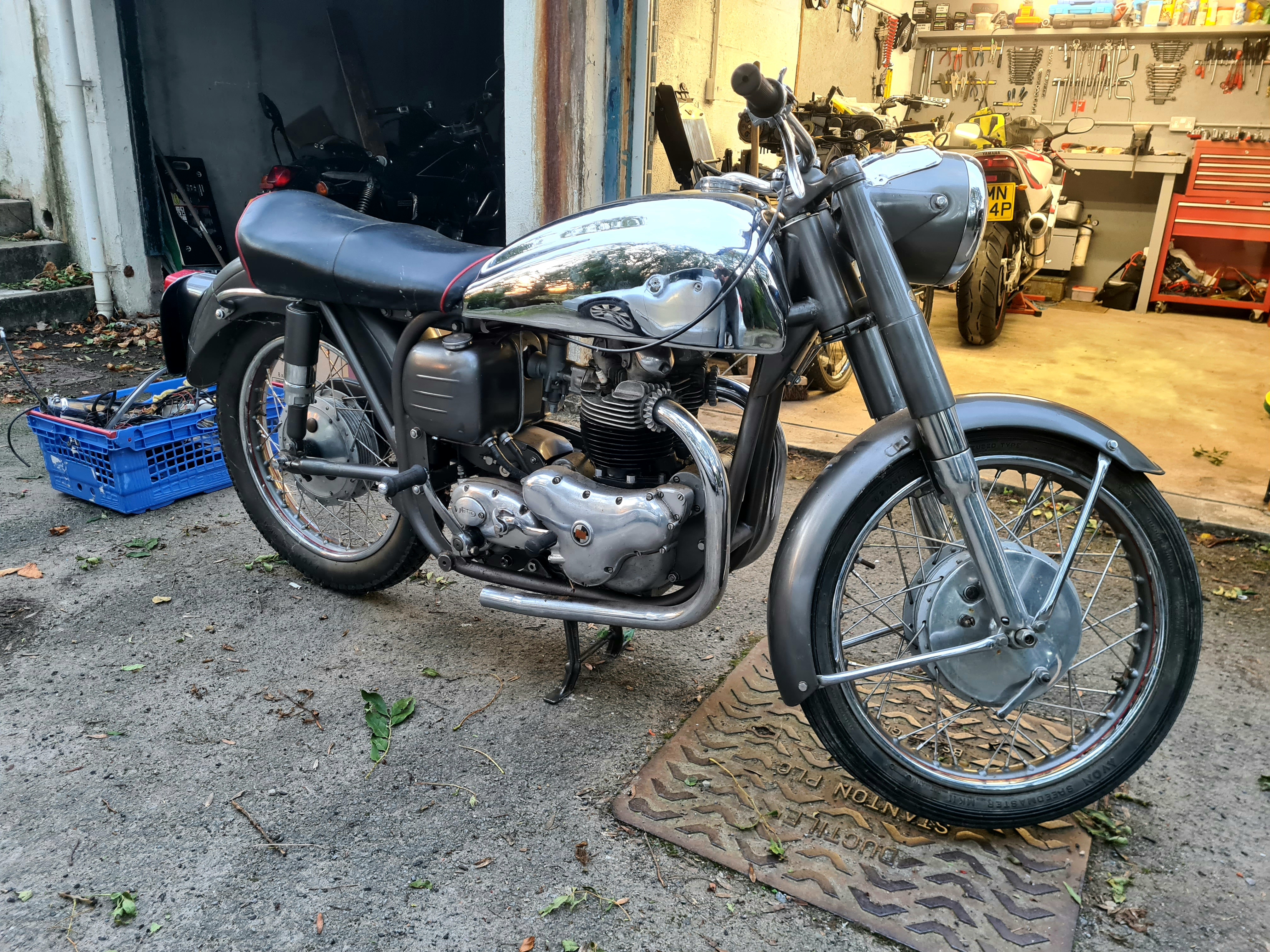

it looks a perfect . get…
it looks a perfect bike . get some carb cleaner now. and strip and clean, Is their a spark.?. timing will not be wrong from parking in a shed.You may have to clean points . check advance / retard is free

Looks like a work in progress
As Richard suggests make sure all the safety bits are still serviceable, tyres have a date code which will help you. Cables free to travel and all fixings are secure. Do you have any pictures of the machine when it was in your uncles ownership? Just to see its original finish.
Have a good look at the mag to determine if it's been refurbished during this rebuild. Points set replaced, commutator clean and undercut, slip ring clean, brushes fresh. The one item that makes a huge difference to how these machines run is the mag! Anything else will be adjustable.

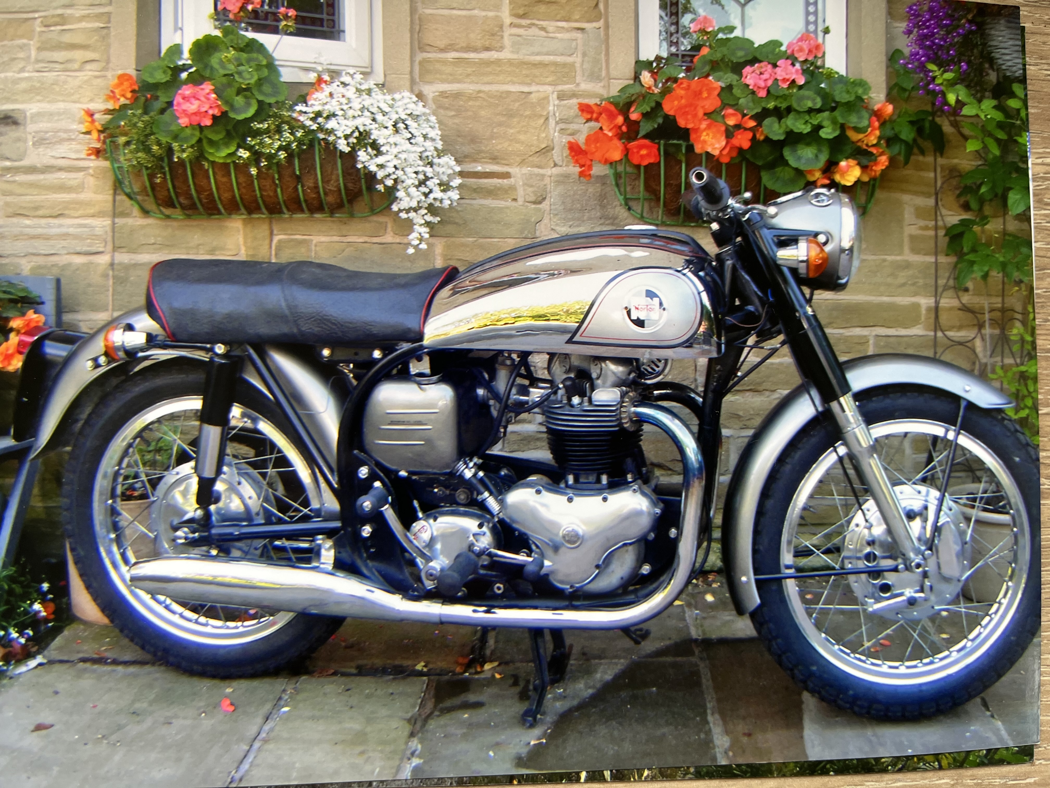

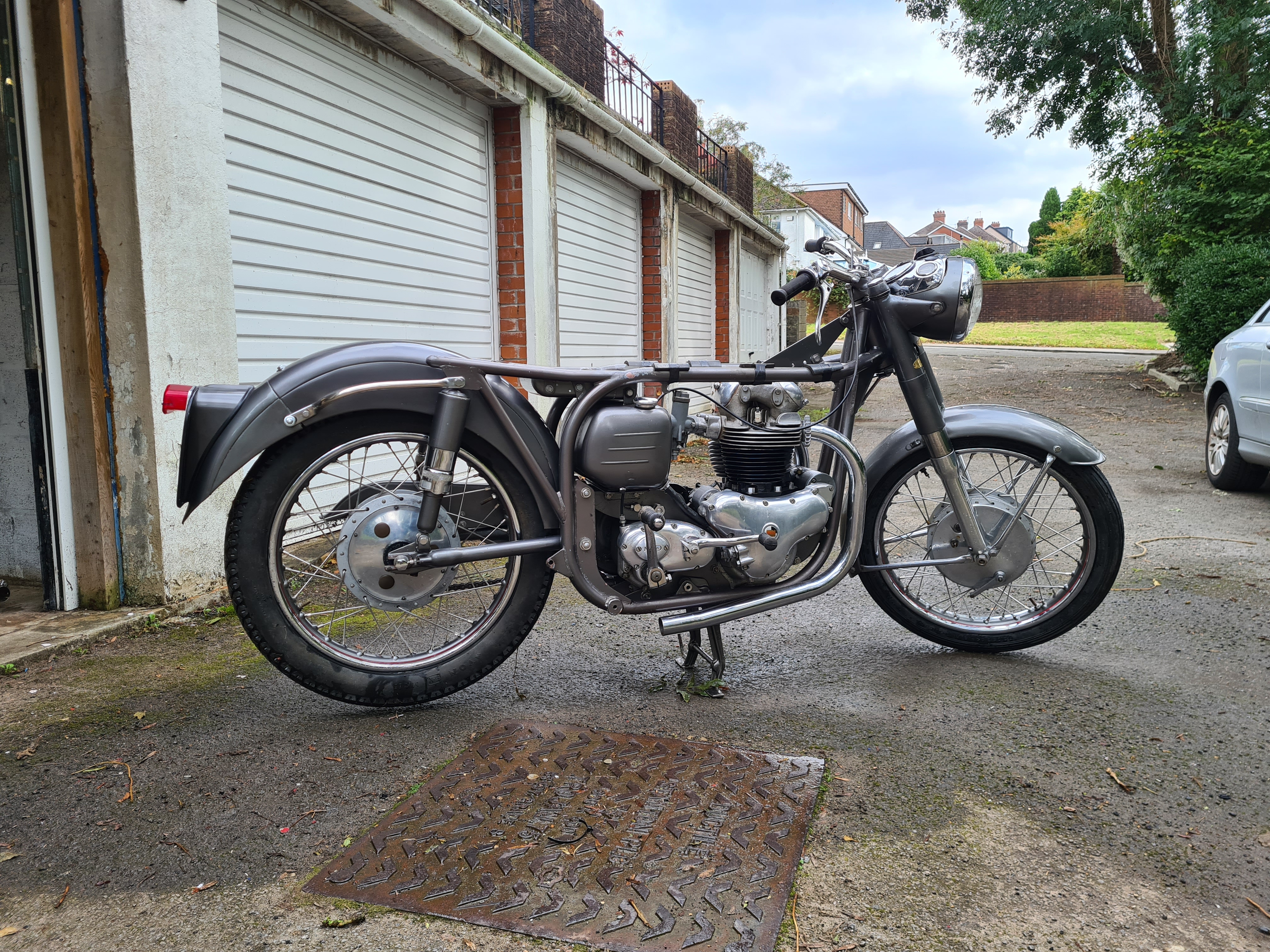

Then colour is correct I need to get the grey put on the tank and pinstripe.
I was told this bike was to be exported but my uncle insisted on buying it and not a British model but who knows.
Maybe the build sheet would help.
The correct colour
It's nice to see the correct grey polychromatic colour for the 1950s & 60s bikes. Many restorations I've seen have a lighter colour. I have a new-old-stock mudguard tailpiece for a June 1959 Dommie, (they were date-stamped) which has been in a dark place all its life with no signs of fading. I intend to take it to a paint supplies shop and check its nearest modern equivalent against their paint swatches. I also have a few bits left from my 1955 Dommie to help verify it. It was that grey, but I was still surprised, when I bought the tailpiece a few years ago, at how dark it was.

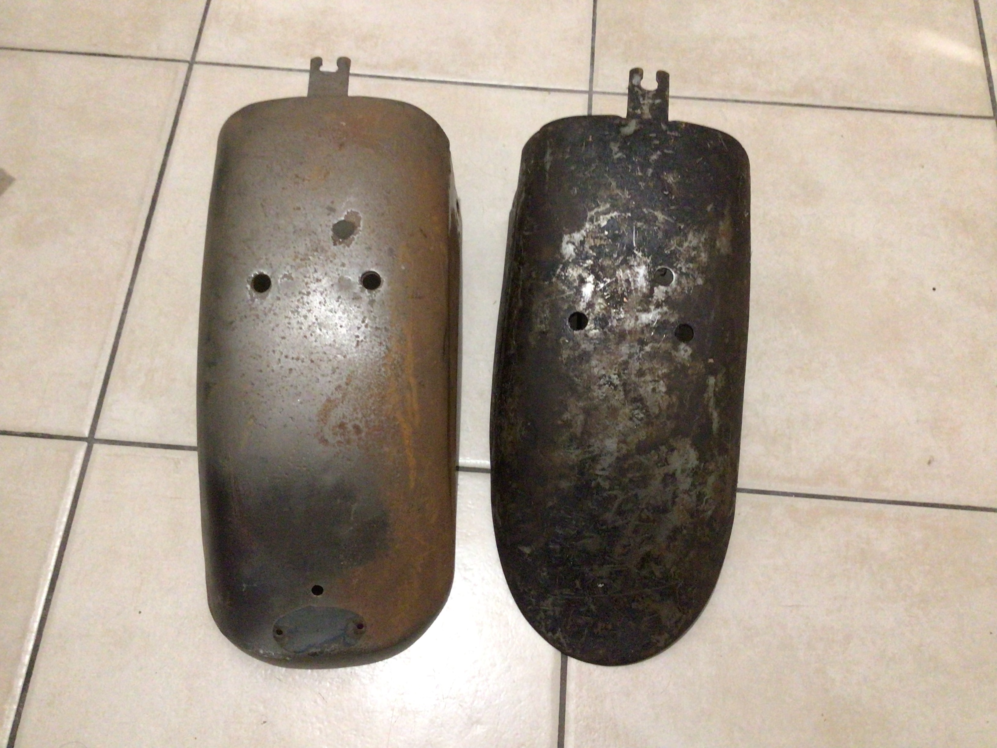

Domi 99 2 piece rear mudguard
Hi Lionel
There are two different shapes of the tailpiece do you have a photo of the one you have. I have a 1956 99 and I'm trying to find out which shape is correct for that year .
Dave.
Mono block
Hi Jon my 99 dom mono block
os not in great condition and the slider sticks, possibly warped? If Craig does not need one could we have a chat? But Craig supported first. Thank you

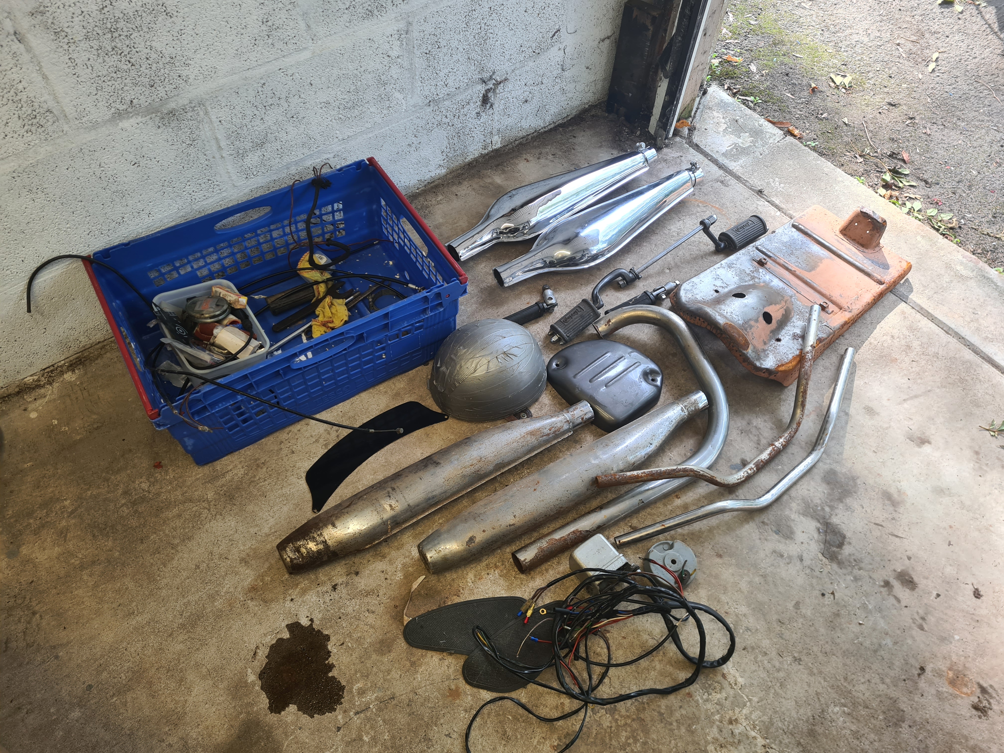

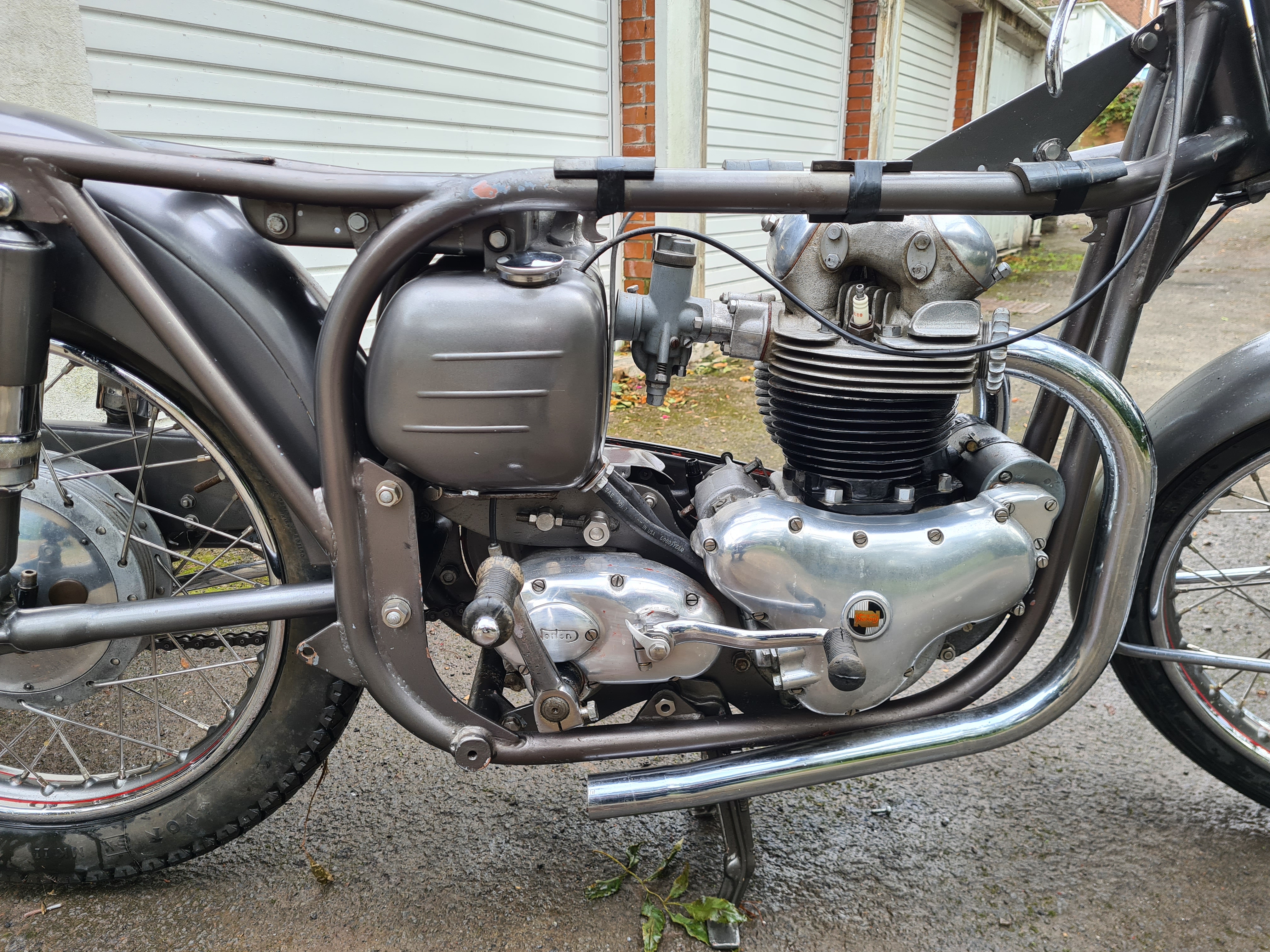

Hi Craig, your Dominator is fantastic, gorgeous colour! In the 'Bits' photo you provided earlier I can see a correct early raised handlebar - I'm in dire need of one for my 1954 88 project, I only have the later Vincent type flat one - would you consider selling it? Hopefully attached is a photo of mine...
Hi Ranulph, I am obviously…
Hi Ranulph,
I am obviously trying to work out what is right for this bike so I have not decided what I need and don't need. If the bars are surplus to requirements I am sure we can sort something.
Craig
Thanks Craig
That's great thanks Craig, I've got most of the large bits for mine (engine, gearbox, plates, wheels, forks etc, just picked up my new front mudguard from Fred Williams at last weekend's Stafford Show), unfortunately RGM are out of stock of the early Featherbed raised handlebars, hence my enquiry to you. Look forward to seeing progress and chatting more!

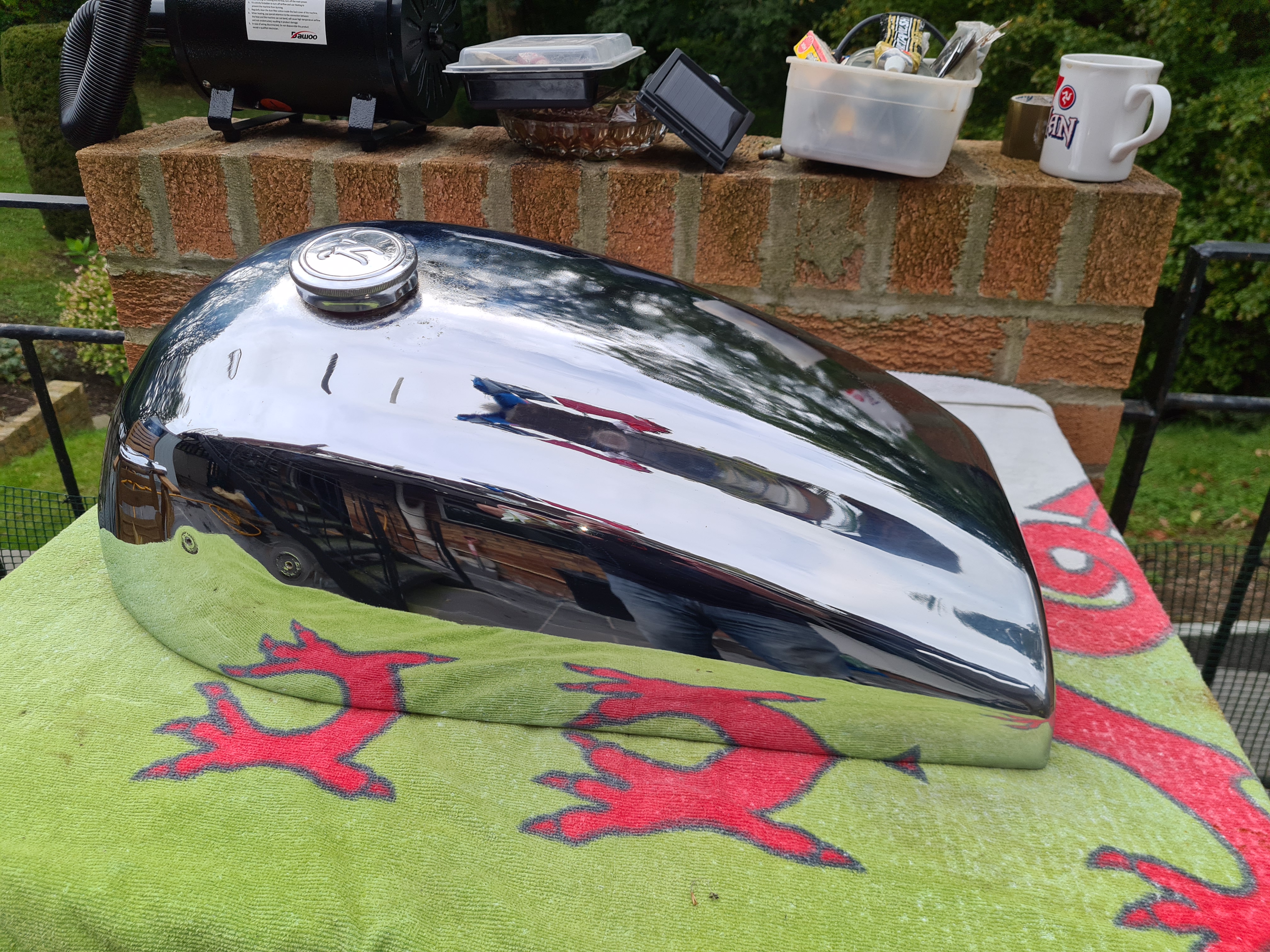

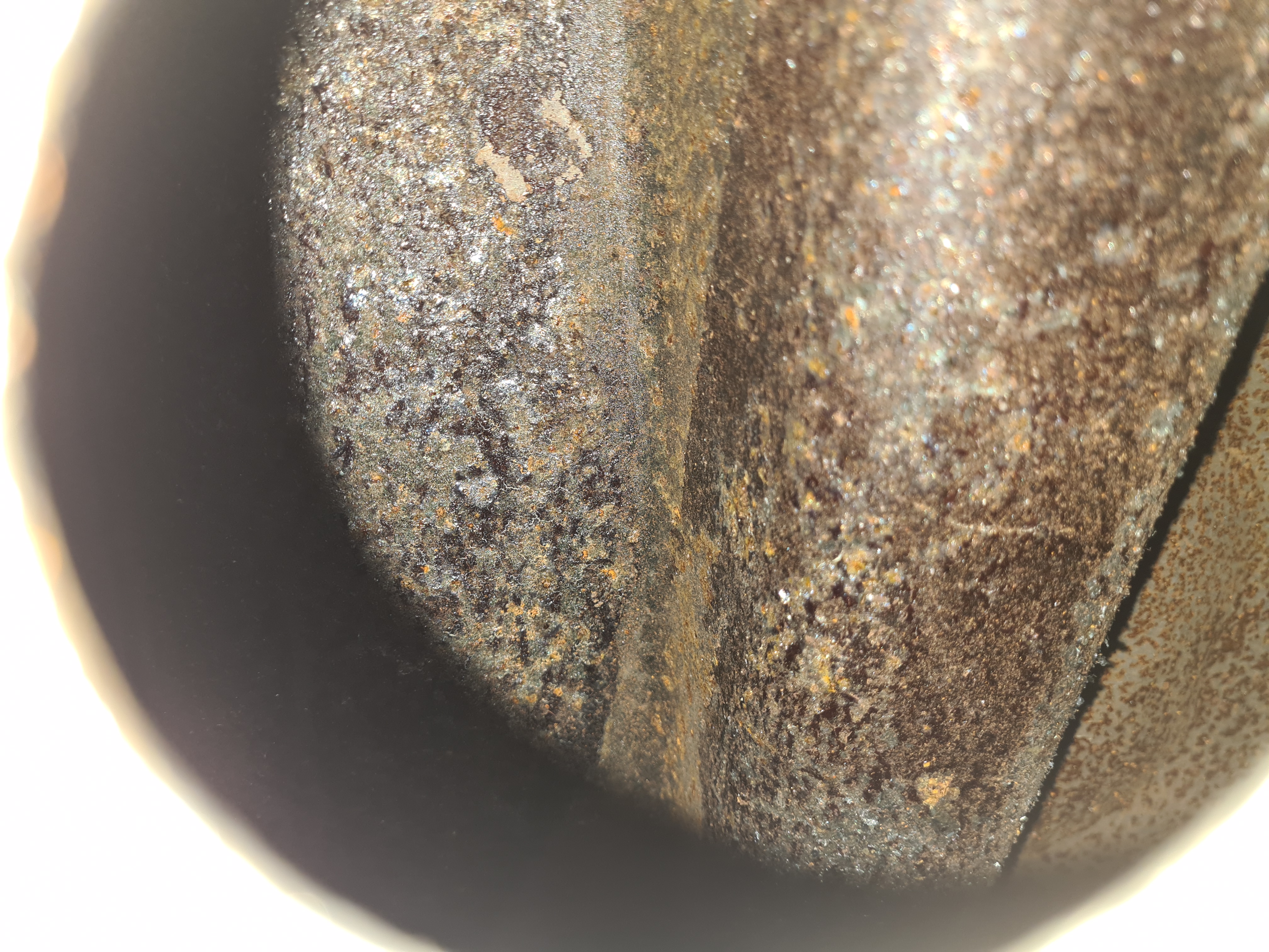

tank
That seems like a very good basis for a reliable bike. I would leave repainting tank till way down the list of priorities, if you intend to end up with a really functional bike. Are you a bike rider already??
Take advice on reliable contacts for important jobs like magneto refurbs/ replacements, as not all restorers are really competent.

A very basic check on the cylinder bores with a suitable light on a probe would be useful early information , and treating inside of petrol tank suitably too. And removing and thoroughly cleaning oil tank, including compacted hard sludge which maybe sitting at the bottom. This also applies to the middle hollow tube at the centre of the crankshaft, but there is only one way to find out.....
