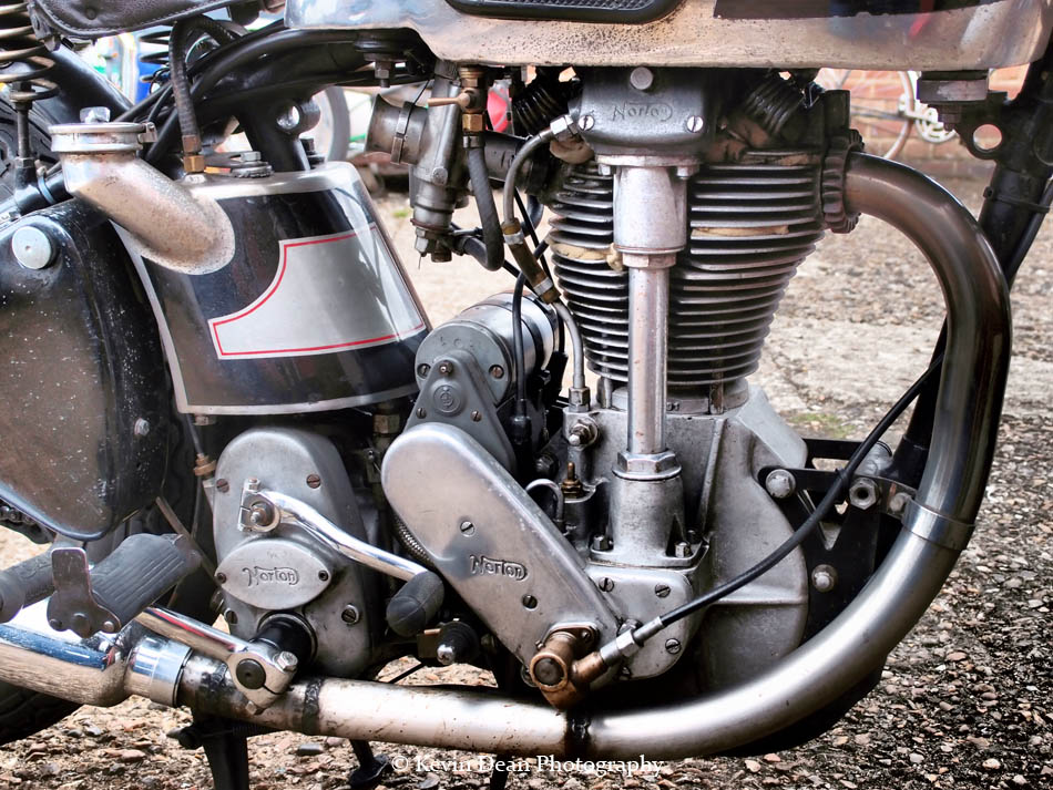

Not original but this is my arrangement...
Jonathan May I ask: where…
Jonathan
May I ask: where did you find the splined thingy ?

Made it Arne. The spline part is off an old norton, the pivoted lever is off a scrap Honda a mate had. Married the two together the added reach means I don't have to modify the exhaust or foot peg to get the old brute to start... ð I'm done with run and bump ð

The Honda arm had a ball and detent to keep it in place. Which stops it folding out on the run. The old norton kickstart lever was just trimmed to length flats filed either side, detent made and drilled through for the Honda bolt. It sits very neatly against the motor and gives good leverage for starting. Extended my enthusiasm for riding it. Seems at a certain age hard work doesn't result in extra muscle power! It will change the way you use the bike Arne. As you can see originality is not on the top of the list for this machine, but riding it is breath taking ð
