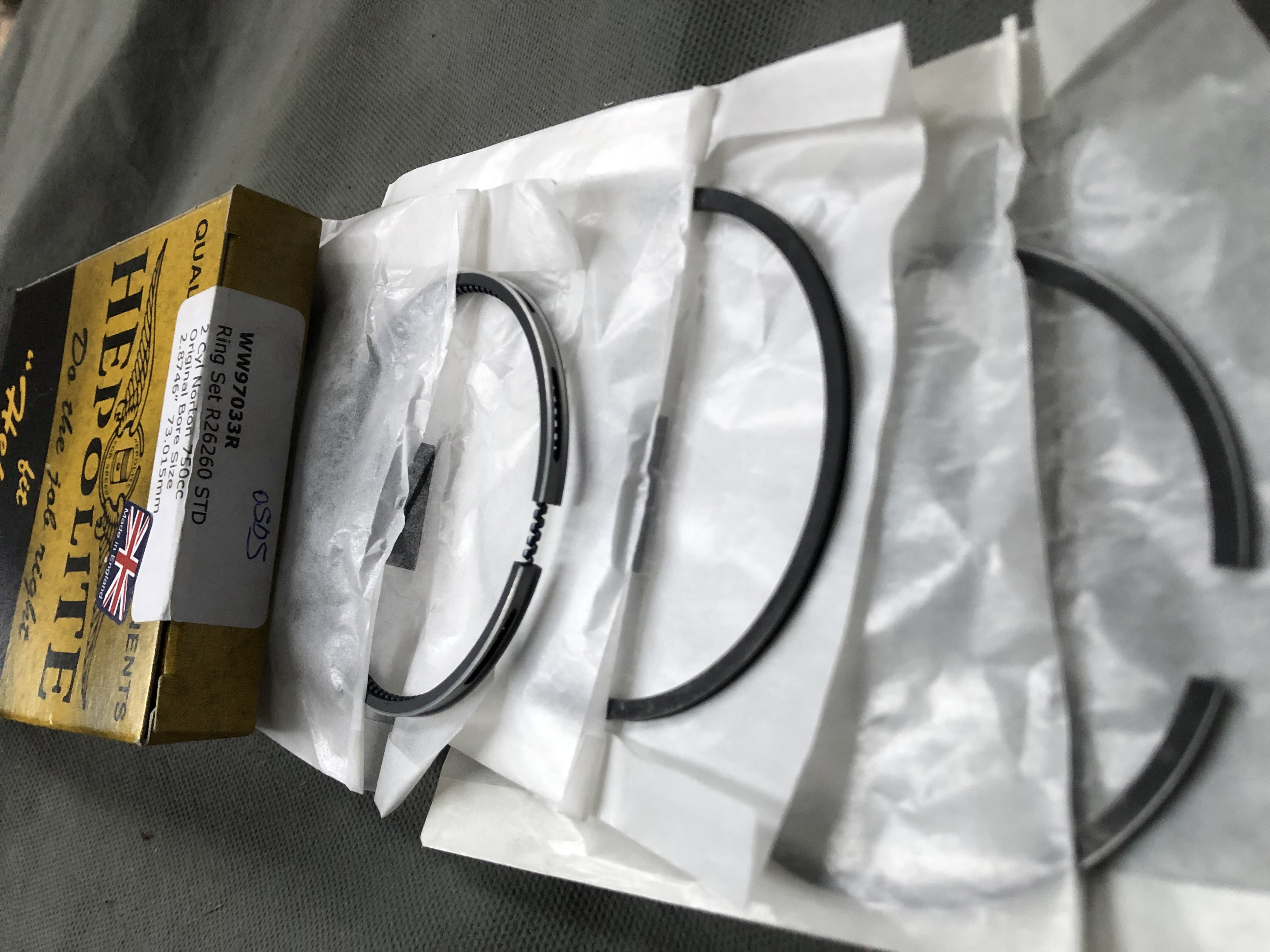

After problems with white smoke on my ‘63 Atlas, I just got the block honed and fitted the old Twiflex oil control rings (two rails with a centre spring photo of piston) and std pistons (slightly marked, some polishing needed). I had fitted new Hepolite pistons with matching rings (slotted ring with a spring type, photo of rings) from the NOC shop. Changing back to the Twiflex rings cured the smoking.

These are the same rings as identified as Twiflex above. If you can find them, they really seem better in my limited experience.
