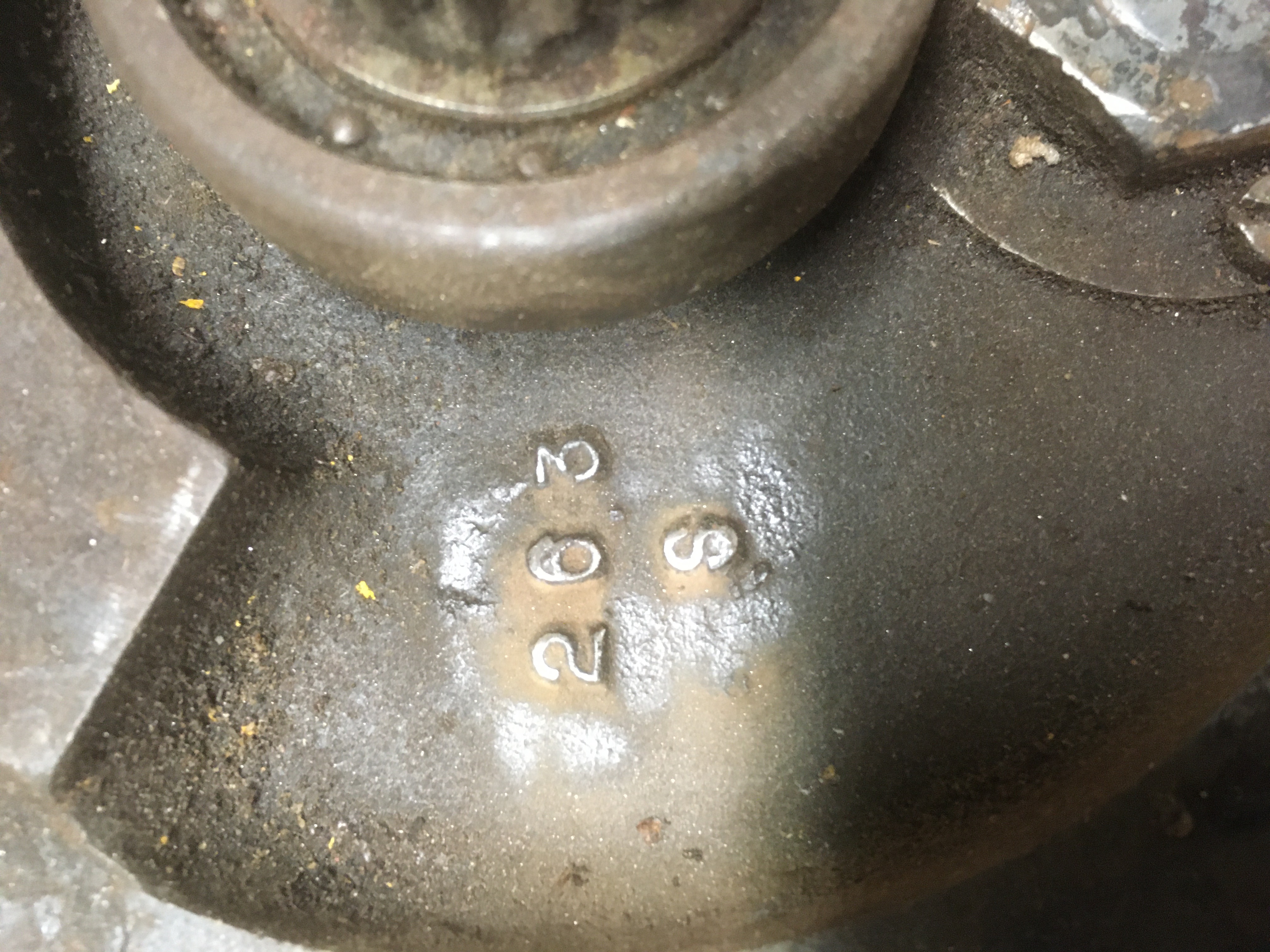

hello i have a mod 18 engine, i don't have a crankshaft, finally i found one, i found one the connecting rod is 4099 and the crankshaft number is 263s i don't know if it fits  to this engine?, anyone have the crankshaft numbers?  my engine number: 59863. 79x100.  Thanks

   I had a look at a pair of pre-war 16H flywheels today that have been dismantled and both of them had the casting number 0262. Your 263 flywheels might be for a 600cc Big4 or Model 19. The casting should be the same on the 16H, Model 18 and ES2.

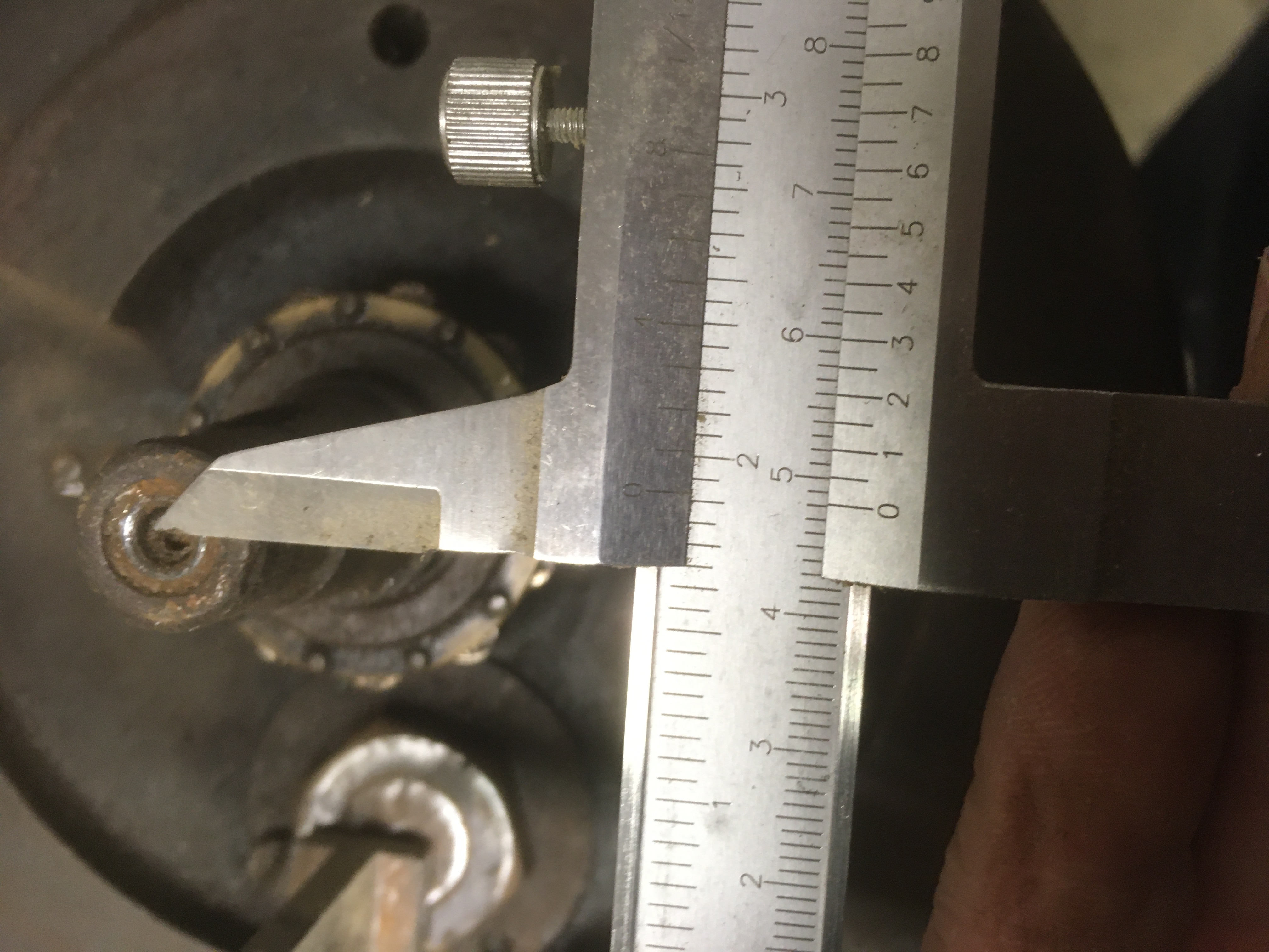

   The best method to check this is to measure the stroke. If you use a steel ruler and hold it on the mainshaft, the measurement to the centre of the big-end crankpin should be 37.3mm. If it measures 43.8mm it is a 600cc type. The con-rod length should be cast on the middle of the rod and should be 7" (177.8mm) between the centres of the big and small end holes. If you can attach some photos it might be possible to identify them.

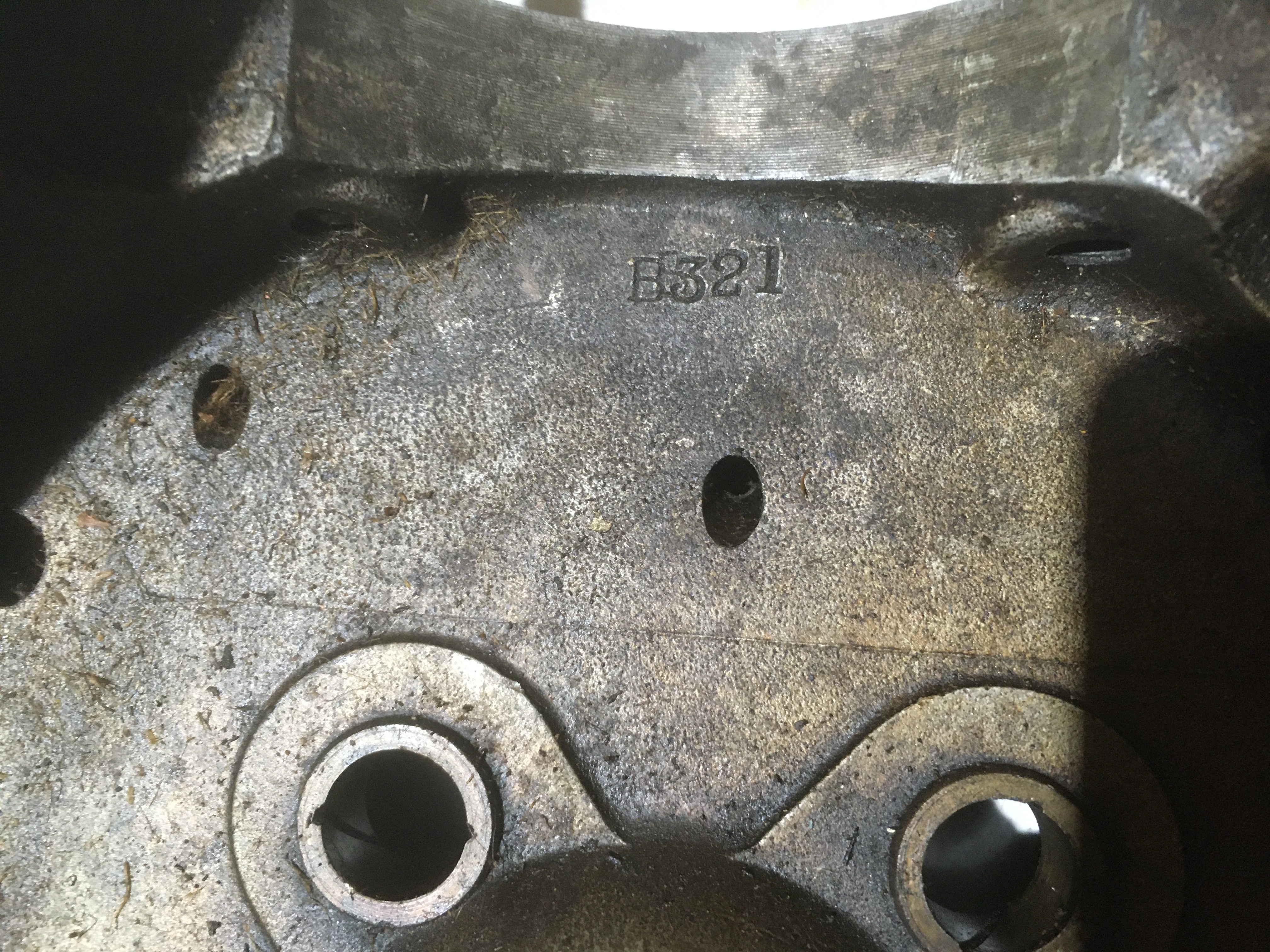

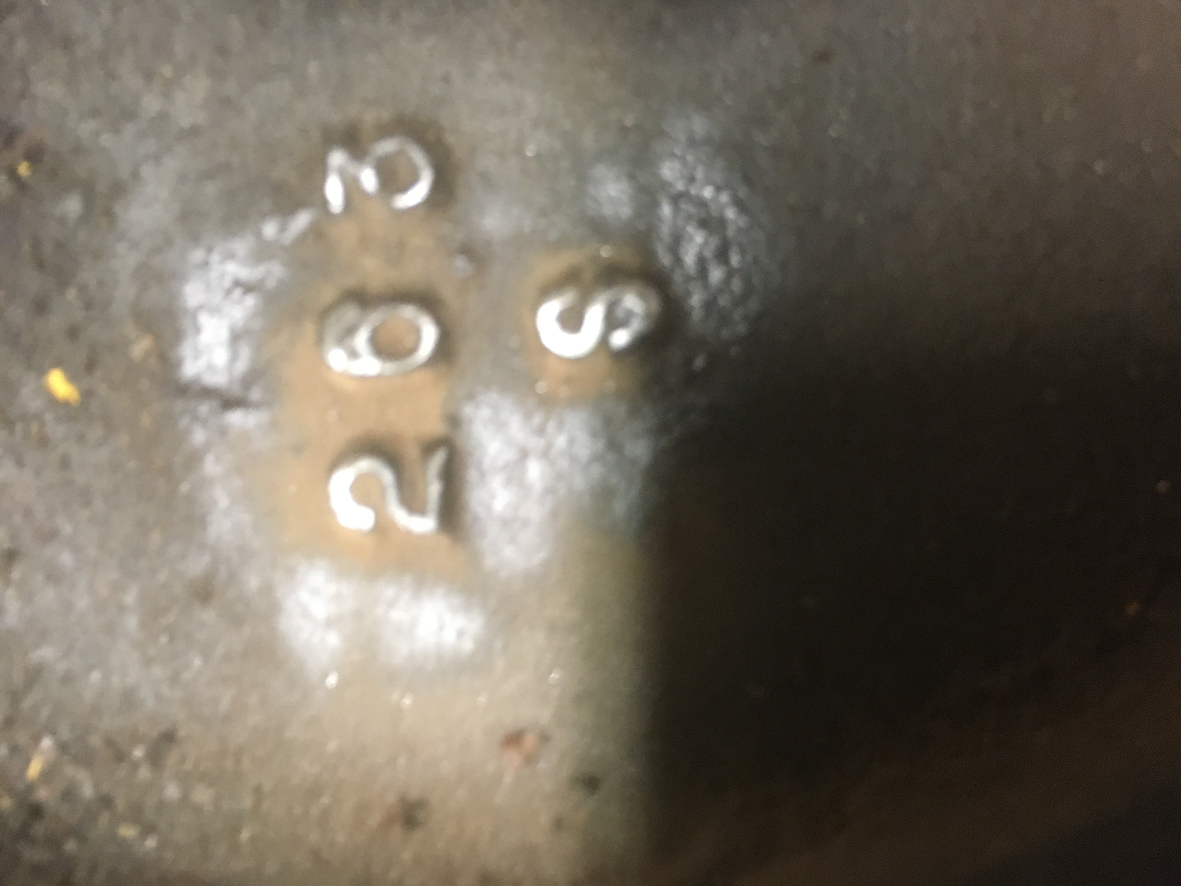

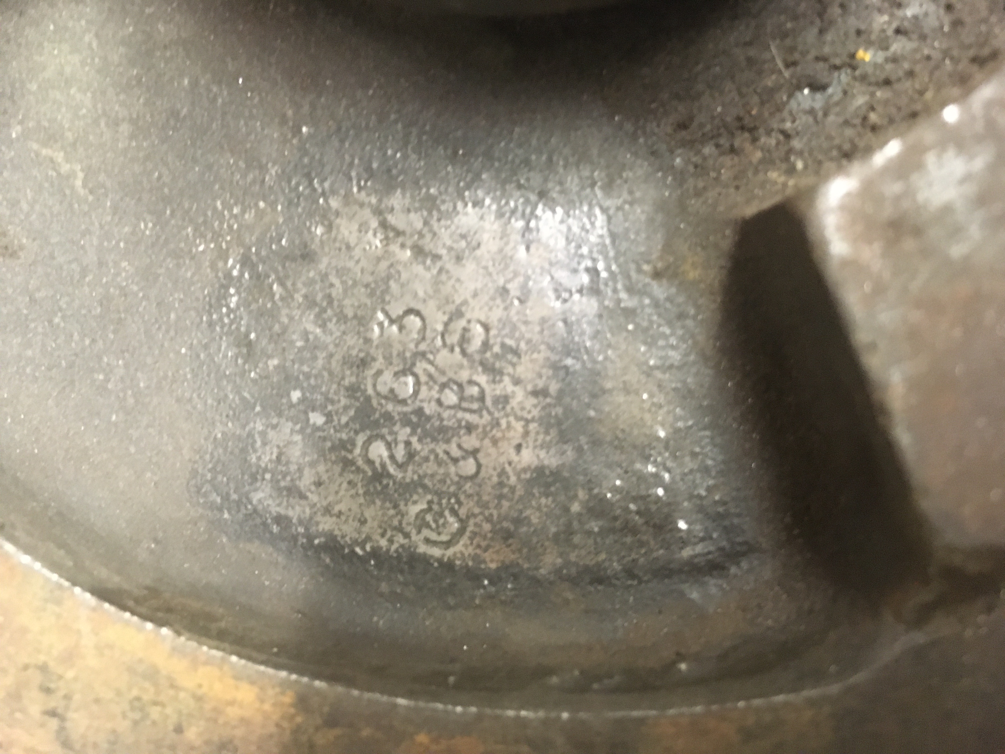

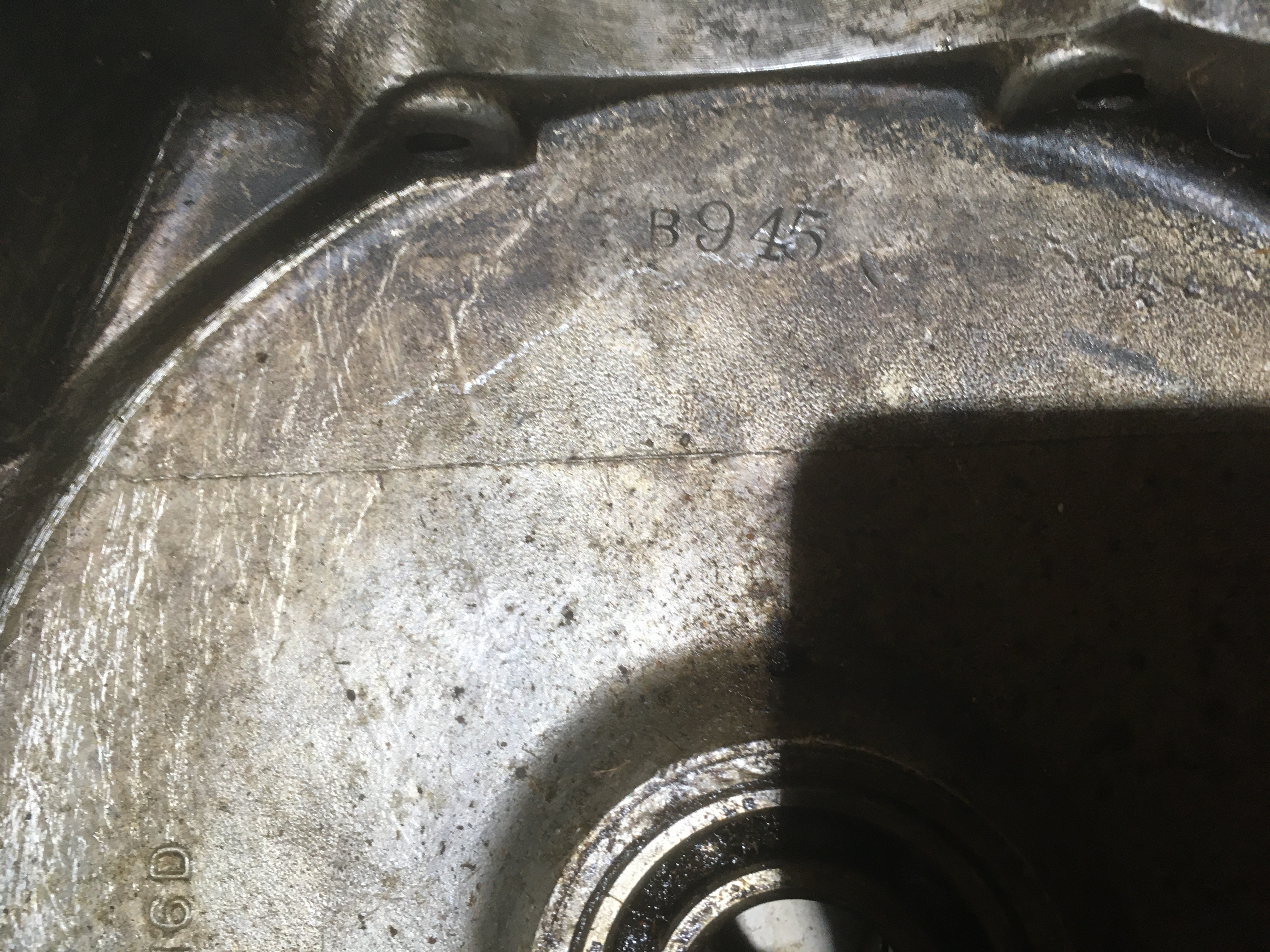

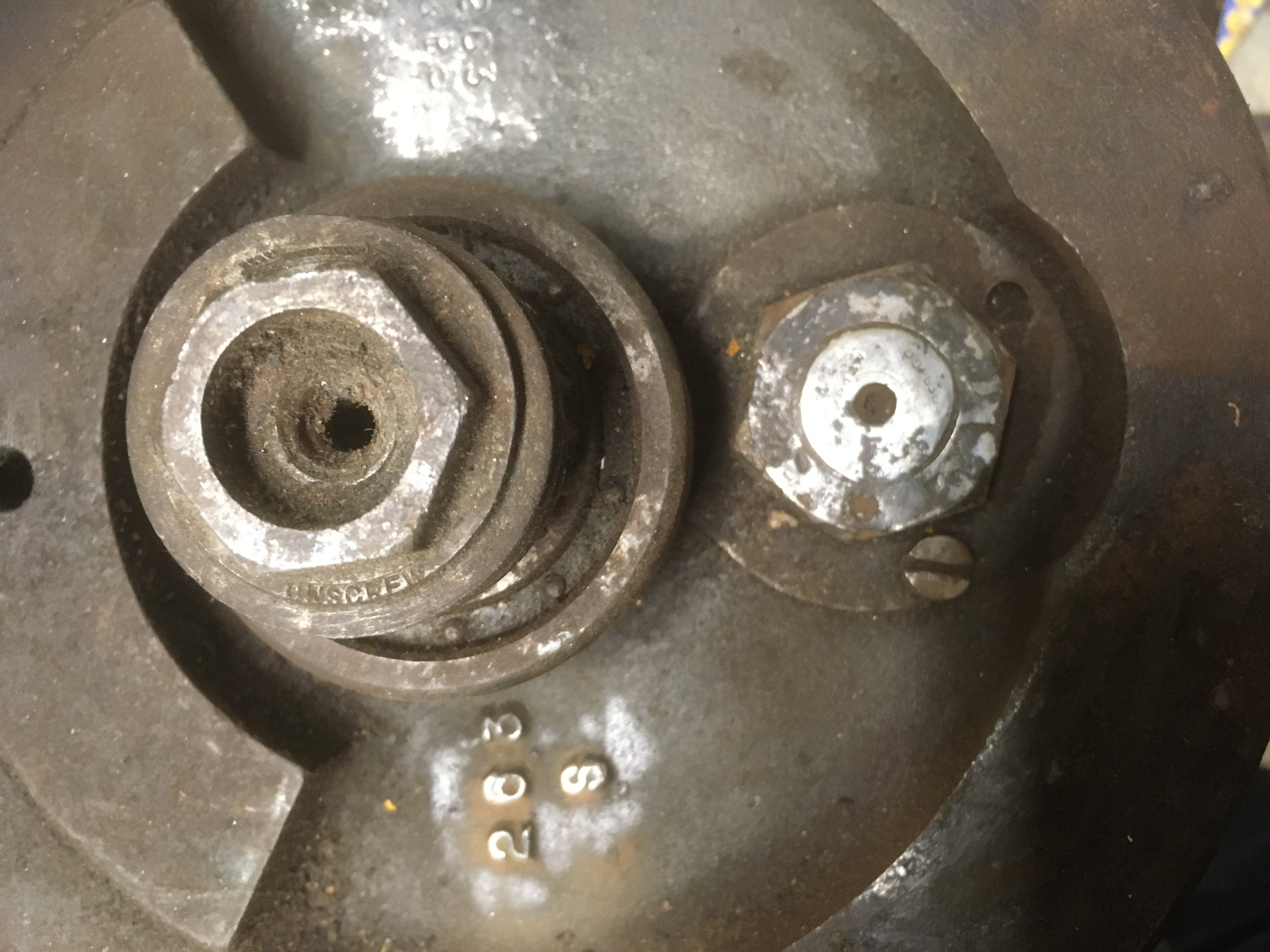

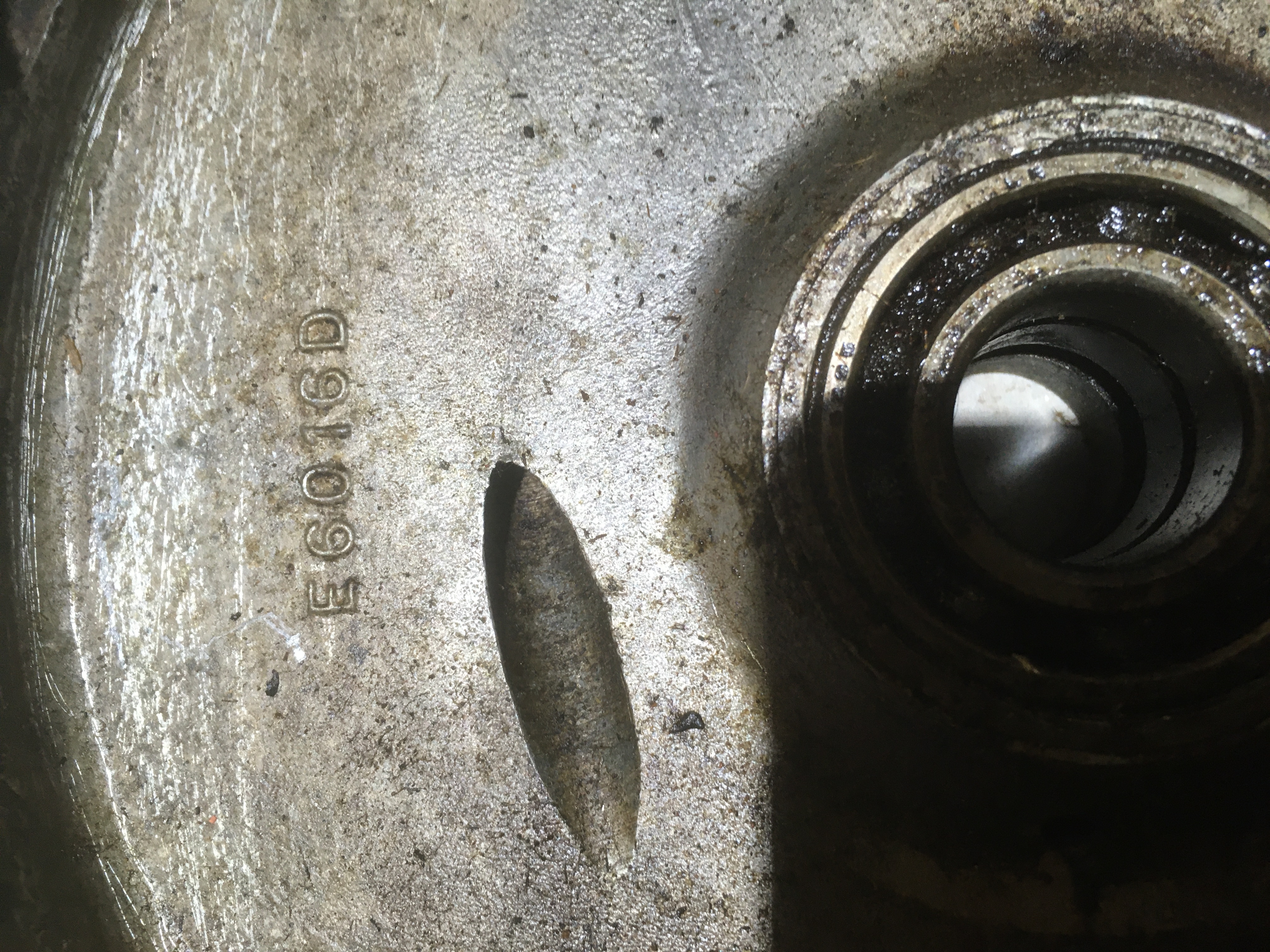

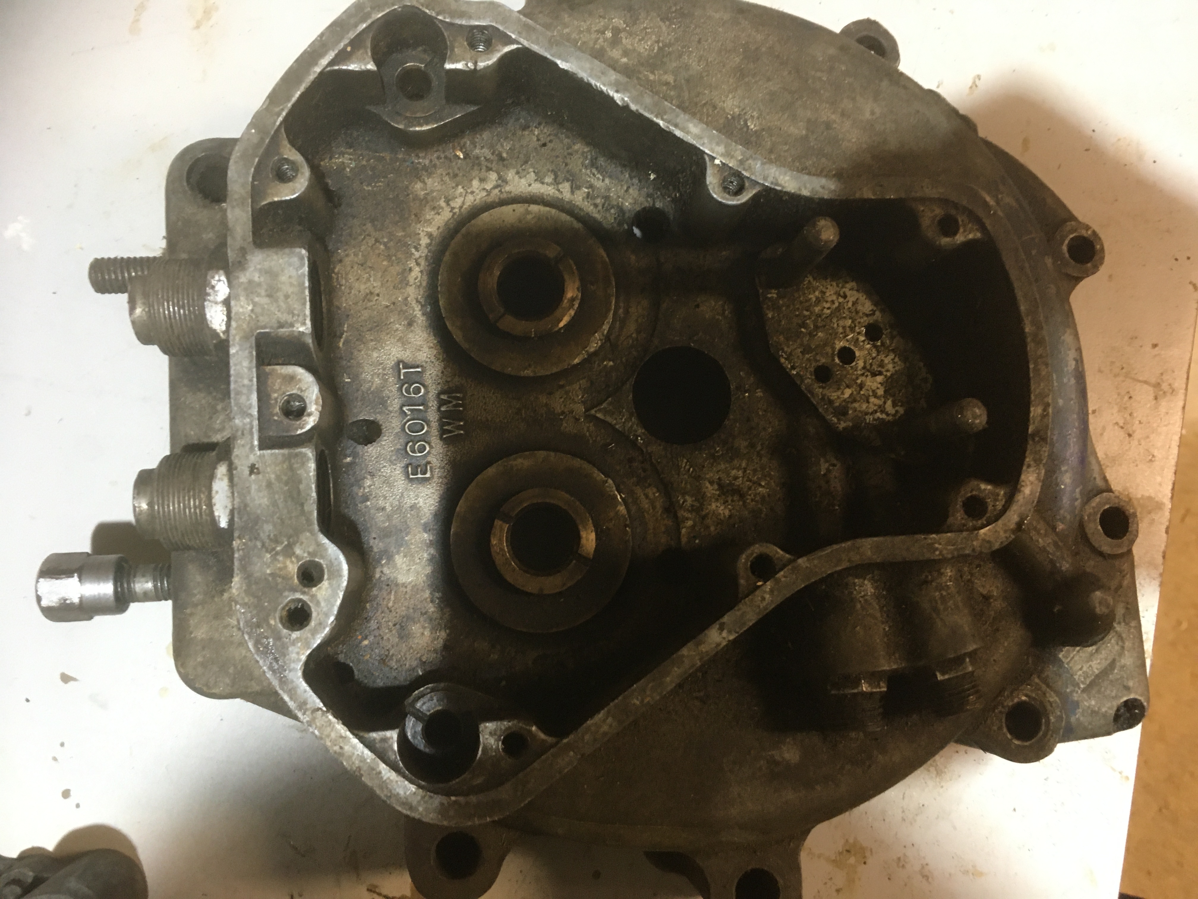

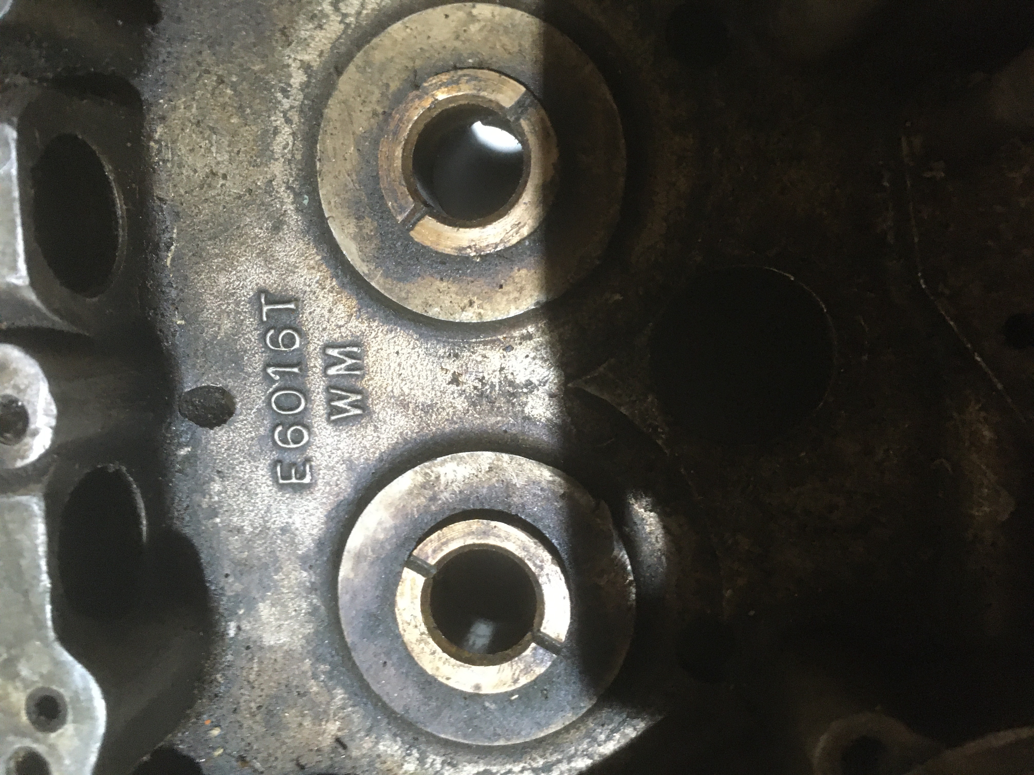

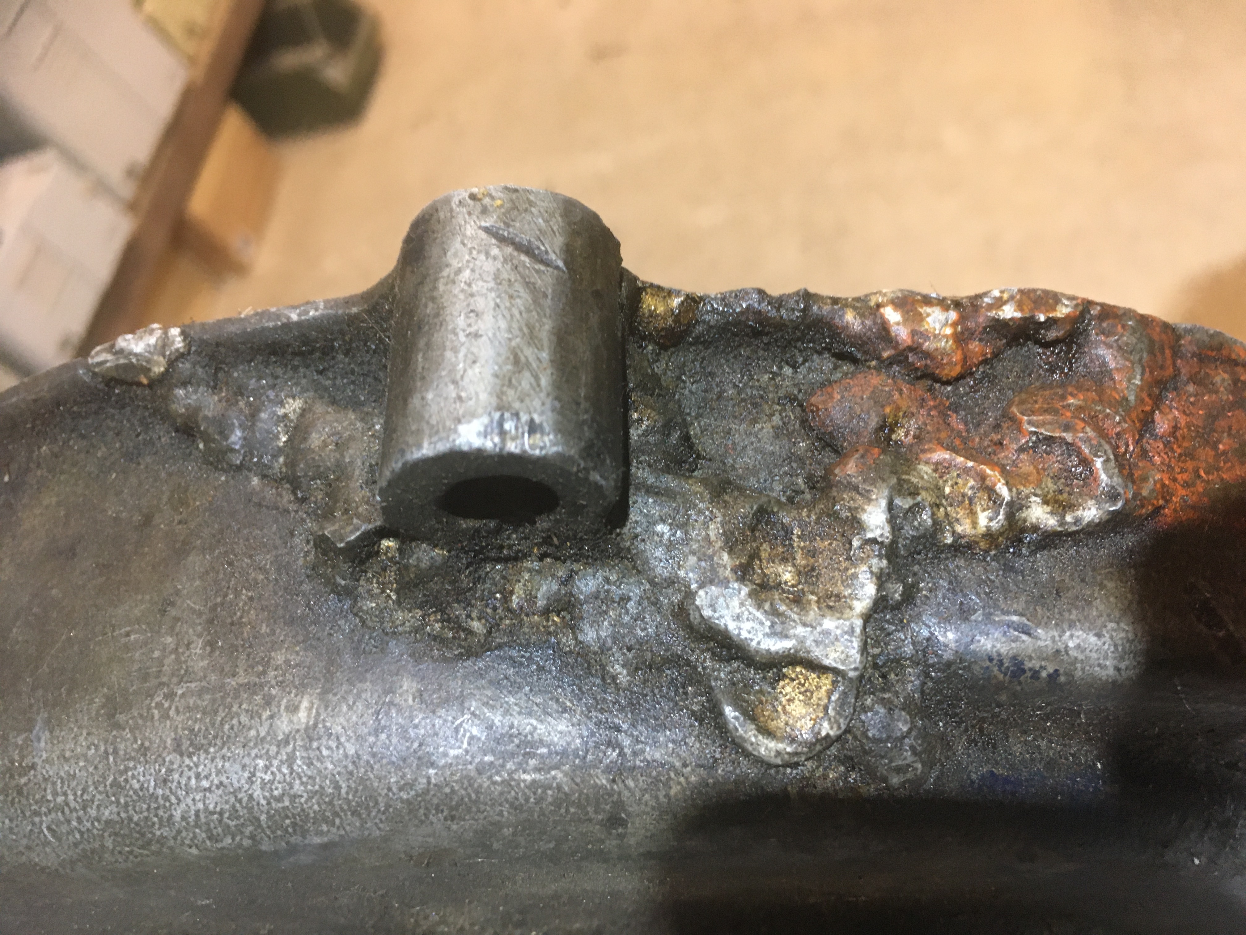

hello excuse me not had a lot of time here are the photos of my engine and the crankshaft the 16 o'clock pinion does not coincide too big?  the crankcase is badly repaired when do you think?, finally I look every day to find one, and then I live in Belgium, thank you again for this precious information, I know that for this engine you need a connecting rod number 4099, and precisely  buy this crankshaft but I don't think this model is for my engine, thank you MauriceMod 18

   I found another pair of flywheels today which I think came from a pre-war ES2 or 18 and they have the number 10262 on each wheel. This could be a newer casting to the one I posted earlier.

   Looking at your photo of the measurement, I see it is 48mm which makes the stroke length 96mm. The most likely bike these flywheels are from would be Matchless or AJS and could be 350cc or 500cc as they both used the 96mm stroke. Motorcycle manufacturers would buy the castings from an independant metal forging company who might supply many different factories, and this is why the casting numbers are very similar to each other. You will need to look for the correct Norton flywheels, which might be difficult, but they often come on ebay (UK). You could also put a wanted advert on this site. Looking at the photo of your crankcase, I think your engine is 1934 or 5, but these flywheel assemblies were used from 1934 to '37 and also for the military 16H machines made for the armed forces. If you find a set, post some general photos of the whole assembly and I will try to identify them for you.
