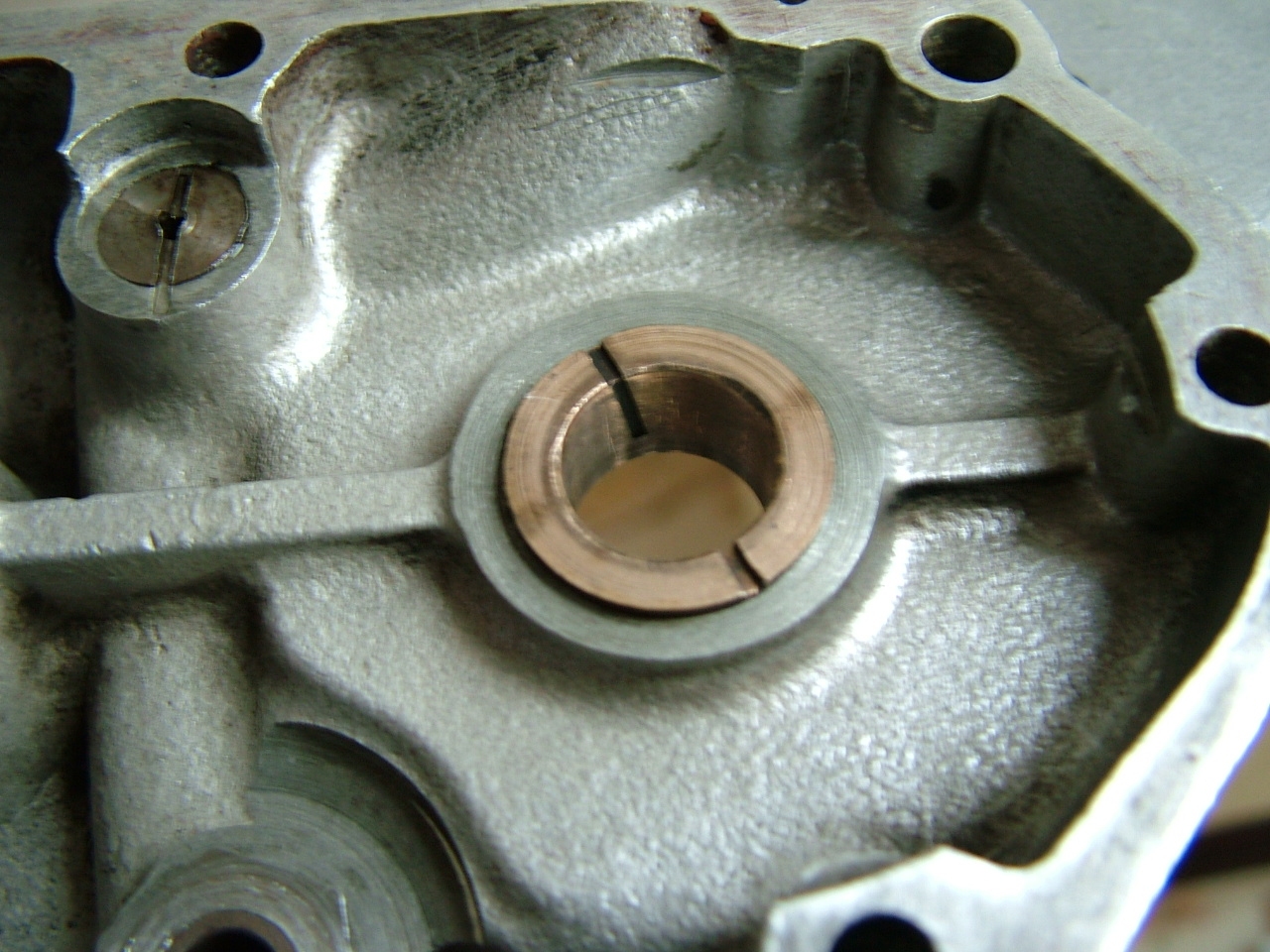

hello,
just found one of my blurred photos showing an inlet bush.
barry
