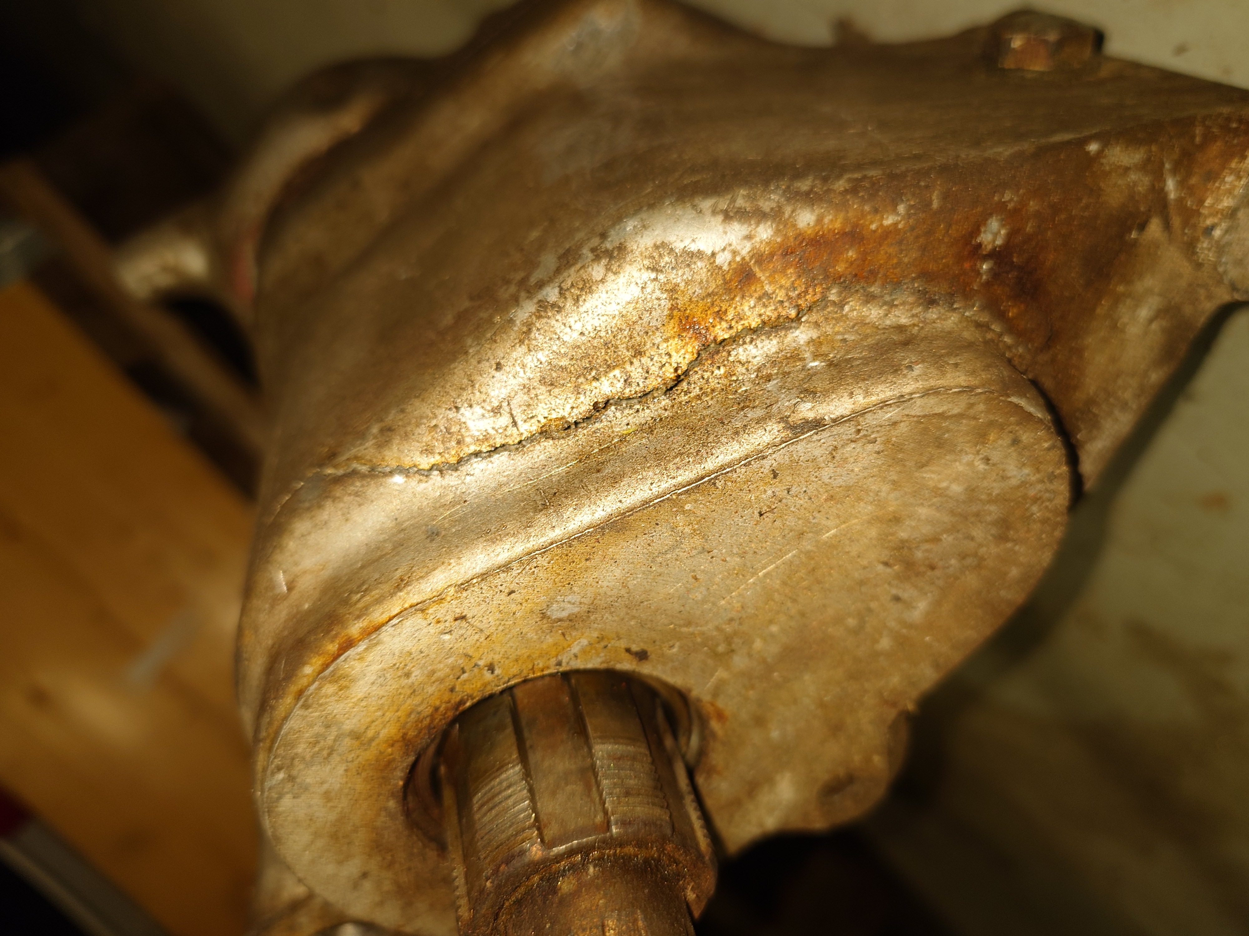

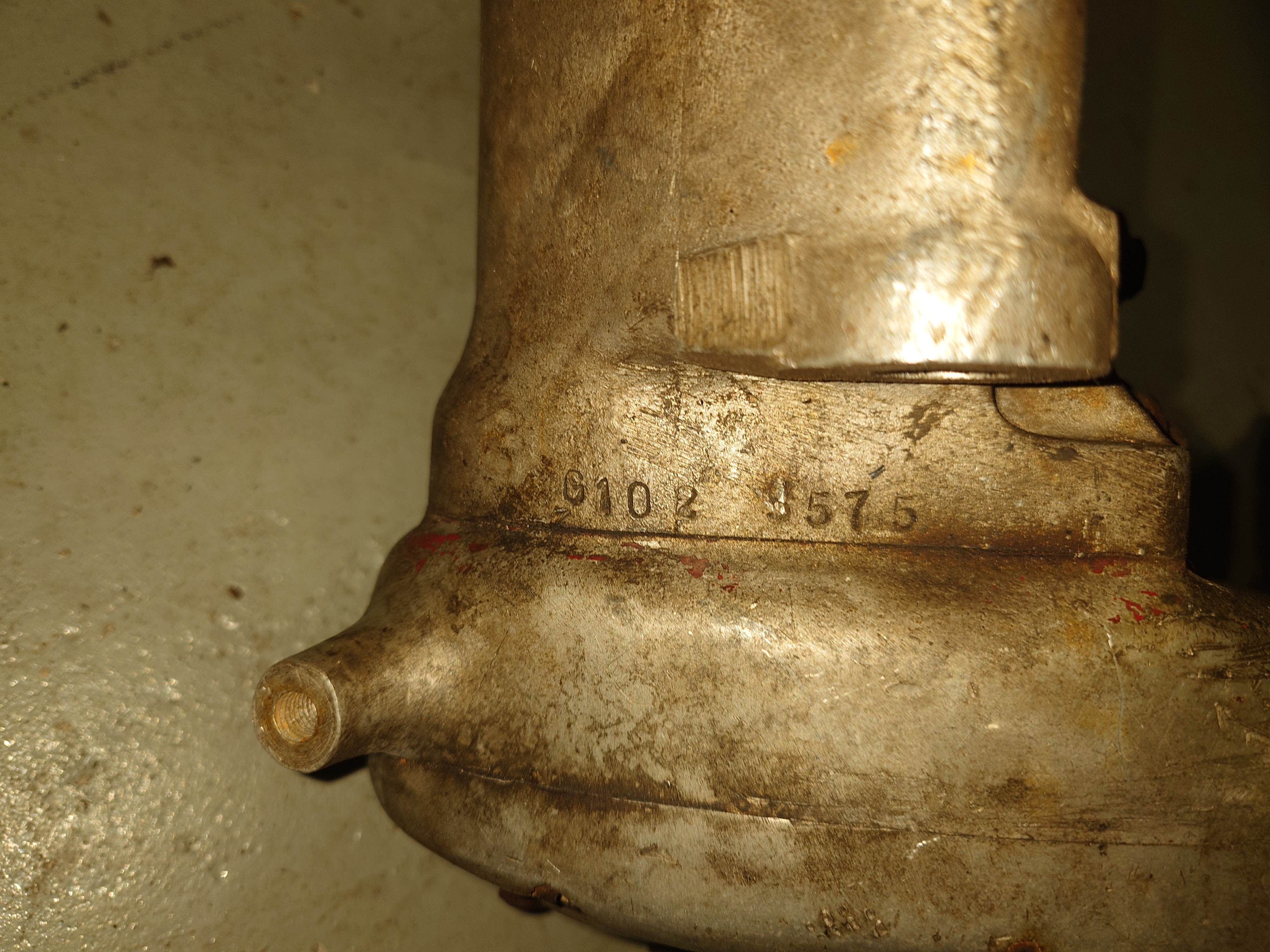

I have a Norton Dominator project that I have started recently. My current problem is that the gearbox is a Burman and was told that it was from the bike but when fitting the sprocket is too low so the chain is touching the frame. See picture. Any advice before I cut the lower bolt hole and weld it in a different location?
Better off getting the correct Norton laydown box. They are readily available.
