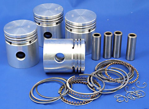

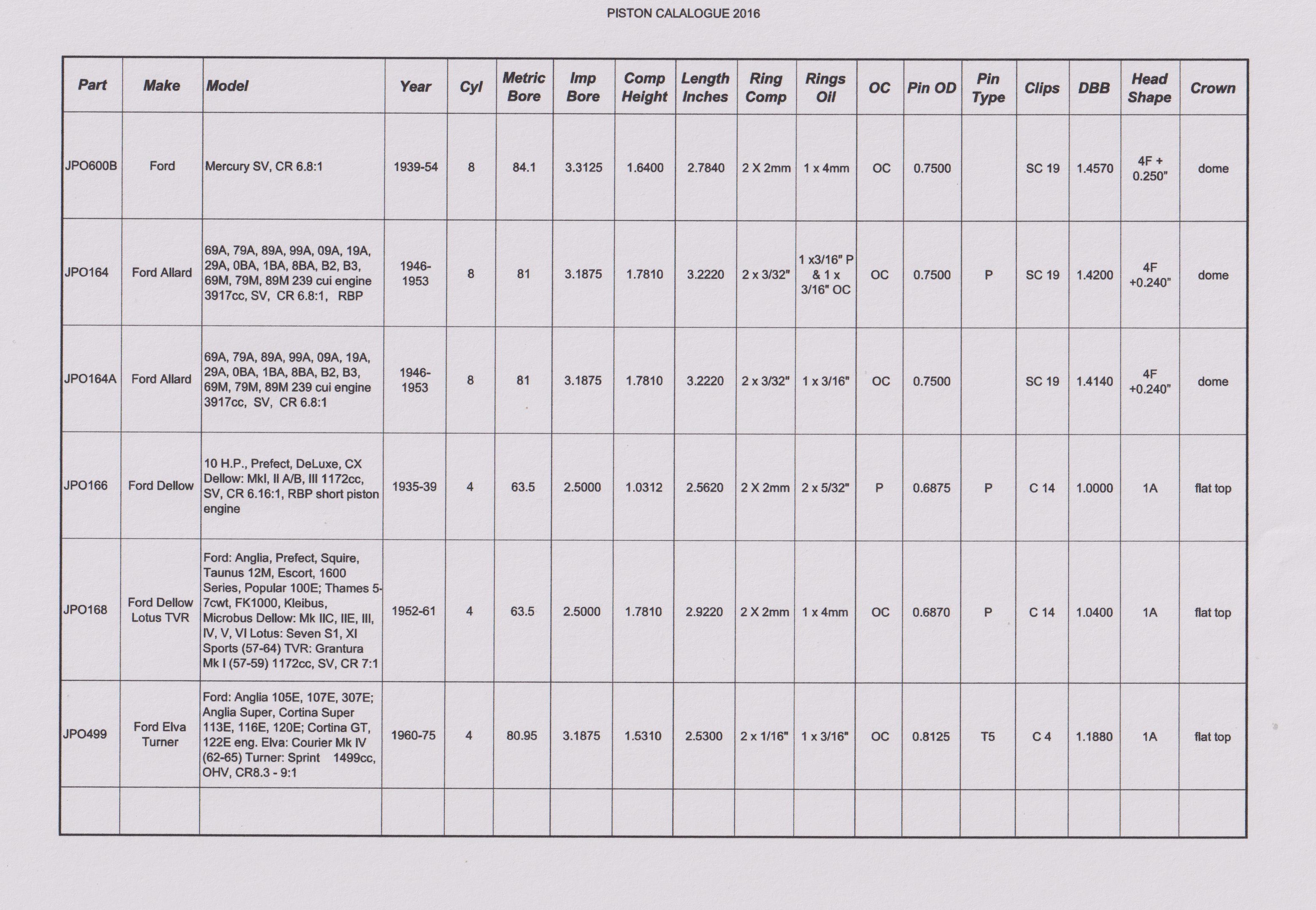

I needed new pistons for my Norton and also looked at some early Triumph versions as an alternative. I think the crown height was not suitable and possibly the small end was not quite right. I then discovered that some of the old Ford pistons were very close in size. I had to purchase a box of 4 at 63.50mm plus 40 thou for my barrel. The biggest difference between them and the originals is the huge increase in weight.  But after a little work was done to them they are now up and running ok in my engine. Checkout the attachment for two alternative versions.  I don't think I will going drag racing with these pistons inside my engine.
Looking at those images of the Ford pistons it would appear that the pins are thicker than the Early Norton ones. I faced a similar thing trying to get the weight down  on some Commando pistons to match the orriginal Atlas ones .  Was the Atlas and early Commando prone to pin failure  and the pins beefed up?.
