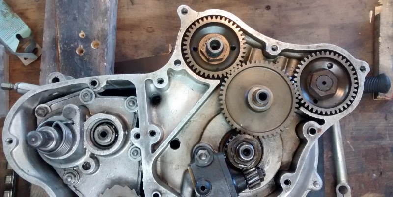

I converted my Navigator to a six start oil pump drive to increase the oil flow. The there are no wahsers under the nuts on the  retaining bolts but I used a paper gasket under the punp. It is the same as on a Commando or Atlas engine.
oil pump
Thanks Ulrich, I knew I had seen a post of one of your rebuilds whcih showed that but I couldn't find it!   I've ordered a gasket from the NOC shop and will ignore the temptation to use washers!   I hope yours is still running well - my rebuild is proving as challenging as only a Lightweight can be!
